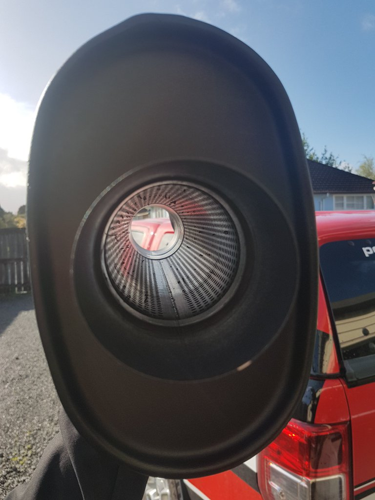

I reckon muffler length and diameter have the largest effect over what it'll sound like. AdrenalinR mufflers are long (intentionally) to try and cut out as many of the low waves as possible, while also (hopefully) catching the higher pitches. Also what Dave was trying to say is that your rasp might get less as you dial in more advance. The closer (in time) the bang is to exhaust valve opening, the louder / sharper the explosion will be in the pipe. You've got me thinking, so I'm watching this video again after 9 years: -
I'd say wait until you've heard it singing at full noise before making a change. The Vibrant mufflers aren't as good at toning sound down as an AdrenalinR from my experience (which is why Murray swapped to AdrenalinR in the end). Your expansion chamber might be adding to the rasp too? Figuring out how sound works in an exhaust is fucken hard to do. Here's what the baffle looks like. It's just perforated tube and stainless packing. -
It's a Vibrant StreetPower that I ordered from the USA.... 7 years ago along with a small stainless Vibrant resonator. This is the exact same combo Murray @iwanttobeamole had on his DC5 before he decided it was too loud and went to AdrenalinR mufflers instead. His car sounded good, so I copied him. One of the best things about having this exhaust done is not having to trip over or move those mufflers ever again. They've finally been put to use and my hoard is ever so slightly smaller -
