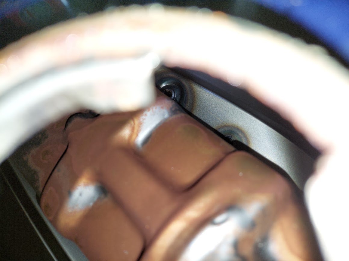

Last ride ended with a few kilometres of state highway to get back into town after some twisties. I was all barred up from the prior hooning so once on the highway I just hit WOT and crouched down into a speed tuck. Coming up to a corner after a pretty long straight section I sat upright and rolled off the throttle to slow down and the little bugger nipped up! It started making a rank noise and rapidly dropping revs, lucky I was covering the clutch so whipped that in straight away and coasted to a stop. Gave it a few minutes to cool down and checked to see if it would turn over with the kickstart. Thankfully it had freed up so kicked it in the guts and rode home much more gingerly. Looking through the exhaust port and there is a definite gark on the piston that wasn’t there before. Guess I’m taking the head off after all…

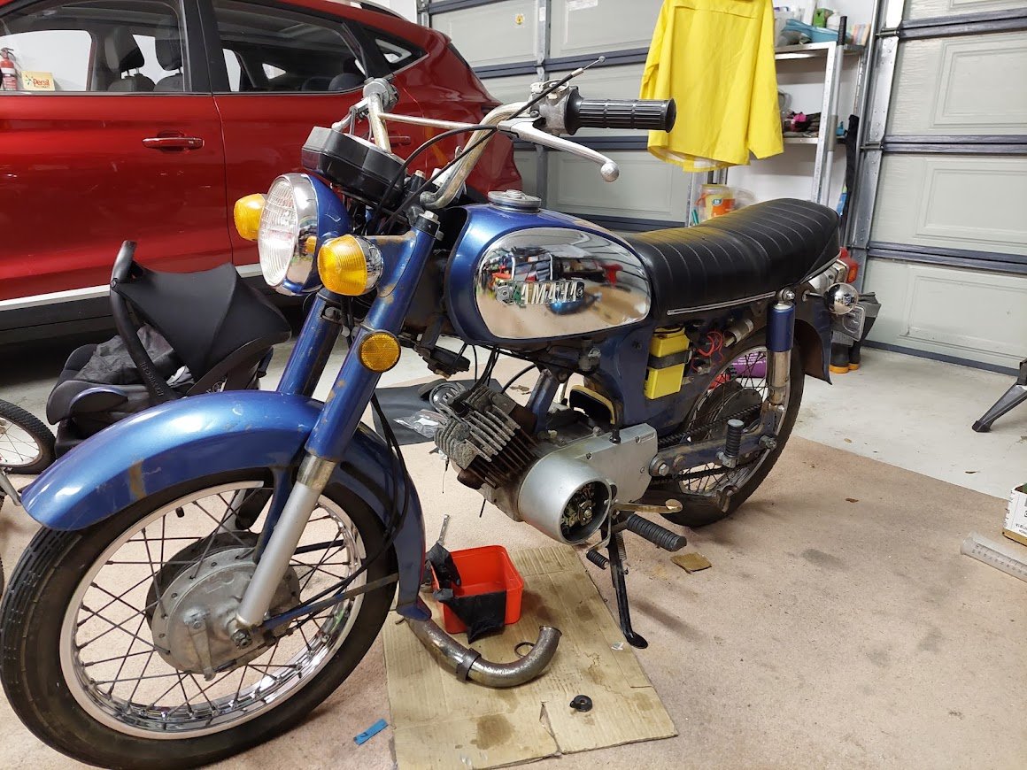

I recently got the urge to get a bike back in the garage and start enjoying that small bike life again. Was browsing up a storm on FB marketplace, trademe etc but everything seemed to be either too fucked, moonbeams or in the South Island. Sitting on the couch one night with the Mrs I got the notification that a 73' YB125 was closing soon. Had a few bids already but was still only $550 or so. Chucked a bid on, few back and forths with someones autobid "just to see how high it might go" and I ended up winning it for $590. Whoops . Supposedly a runner, but has been sitting for a while and the key is lost. Has been registered previously but lapsed. Got in touch with old mate, bike was in Wellington so organised to go down easter friday and pick it up. Borrowed @anglia4's trailer and he decided to come along for the trip too, legend. Early morning hoon down to Welly, bike on the trailer, back to NP by mid afternoon. Got it into the garage and started taking it apart to see what is lurking underneath. Lots of surface rust Grimey build up on autolube pump. Carb looks pretty good inside though? Managed to get the exhaust header off without much trouble. Rings and piston looking good to me so I probably wont bother taking the head or jug off for now. Things to do: I have taken the ignition off and given it to the local locksmith to see if he can cut a new key that fits. The petrol cap has a lock on it too so I haven't been able to get inside that yet to see what state its in. I've taken the petcock off and there's no fuel in there so hopefully no holes. My big idea is that the fuel cap and steering lock and helmet lock were all keyed alike to the ignition but just used 2/3 of the 4 pins (or whatever) so if I can get the ignition key cut then I don't need to bang a screwdriver in and wreck the petrol cap. Worst case there seems to be NOS ignitions with keys and petrol caps on ebay indonesia for acceptable $$ so I will get one of them if no bueno with the locksmith. Fingers crossed he can because I don't really want to wait for Garuda Airmail to be able to ride it properly! I've got a new battery coming too. This model is electric start too which is lush/not in the spirit of old 2T at all . Questions for the hive mind: unsure what I should do (if anything) about the rusty bits. My initial thinking was to do a quick wire brush of all the loose stuff that is out of sight on the frame under the tank, seat etc and then brush on some rust converter to try and slow down/stop whatever is left. Mixed reviews on effectiveness of that stuff though. Would that be worth it or a waste of effort? Better off hitting it with a wire wheel to properly get rid of it then spraycan/brush on some rustkill primer and closest colour matching topcoat?
