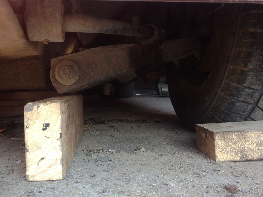

  3. No much visual progress but moving on After a good yarn with Governorsam I think I need to back off a bit and just get this car running and enjoy it, so from now on i'm just going to tidy up whats needed for a wof and lay off the turd polishing, (just a little) Cleaned up the carb, manifold and fuel pump, also have rebuild kits fresh from the Ukraine ready to go. getting closer with my panel beating introduction, will prime and paint with whatever I have, a respray is now off the table, maybe just a rattle can job on the repaired panels. Popped the front springs out to look at how much low is possible, was quite a mission to say the least, with the sway bar off and lower arm at full droop the difference between free length and just enough to pop out is massive! and its still legal height! She's now on the front bumps and looks good, however the geometry is a bit whack so i'll mess around with the jack and see what length springs to go for.

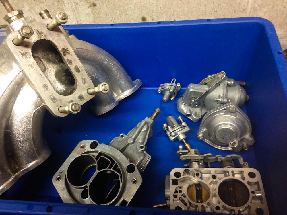

  5. FYI We're leaving from the peg at 130, that means you can hand in the report at 5 and still beat us there. I do believe you told me in the workshop that if its finished this week you'd take the drive.

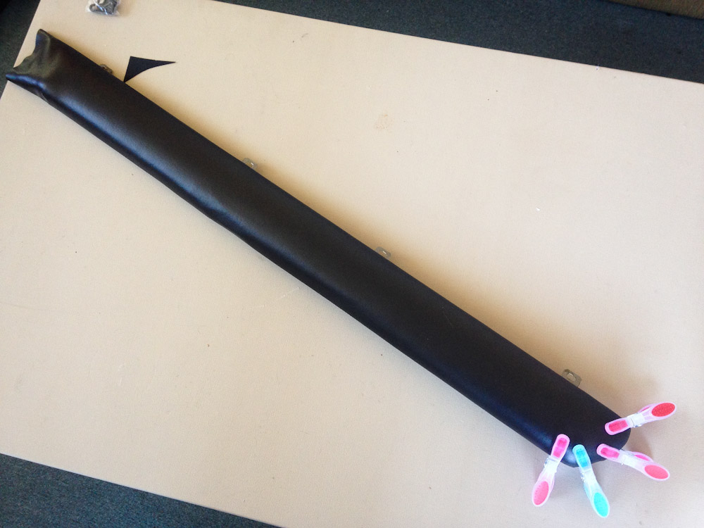

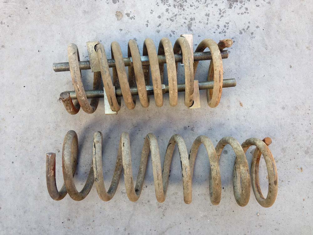

  7. With the weather last weekend being crap i worked on some inside stuff: The top door trims are pretty beat up, yeah a new set is 40usd but.. While wondering a cheap way to fix them my girlfriend happened to be making a new wallet from pleather, tagging along on her next trip to the fabric store I parted with $15 and started to experiment: I cut out the shitty foam and patched it with a similar stiffness piece I had lying about and stretched the pleather over, not bad, i'll cover the rest the same way but with out needing to patch, the dark brown may also add some class to the interior Making progress on the front panel, I find its best to do it a bit each day with a fresh head, otherwise I start making a mess!
  8. Possibly an embarrassing post but hey. Had a close look at the carbs again today to sort out the flat spot focussing on the accelerator pump circuit. Being there is slack between the actuator and the diaphragm that I can't adjust out this was the target. With everything looking right I took the diaphragm out to check if for some reason I brought the wrong one, cue the i'm an idiot moment....... Turns out I never replaced the return spring when I rebuilt the carbs, quick check of my parts box and there they are, 5 min later, back together, a quick test drive and once again another leap forward in drivability. Anyway, pics Before: The little spring: After: Looks like it needs a clean too!
  9. idiot post.... Well I can now confirm the pumps operate from 0, pulled the diaphragms out to check they were correct and found I hadn't replaced the springs when I rebuilt them last year, with the springs in the flat spots gone and she gets off idle much nicer.

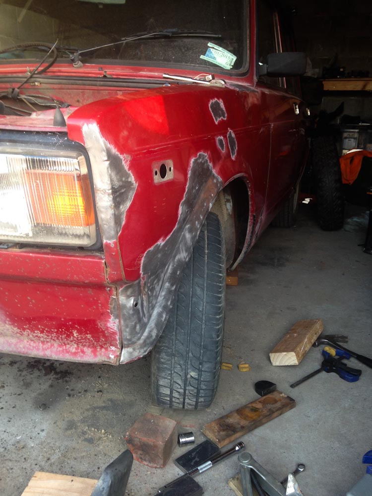

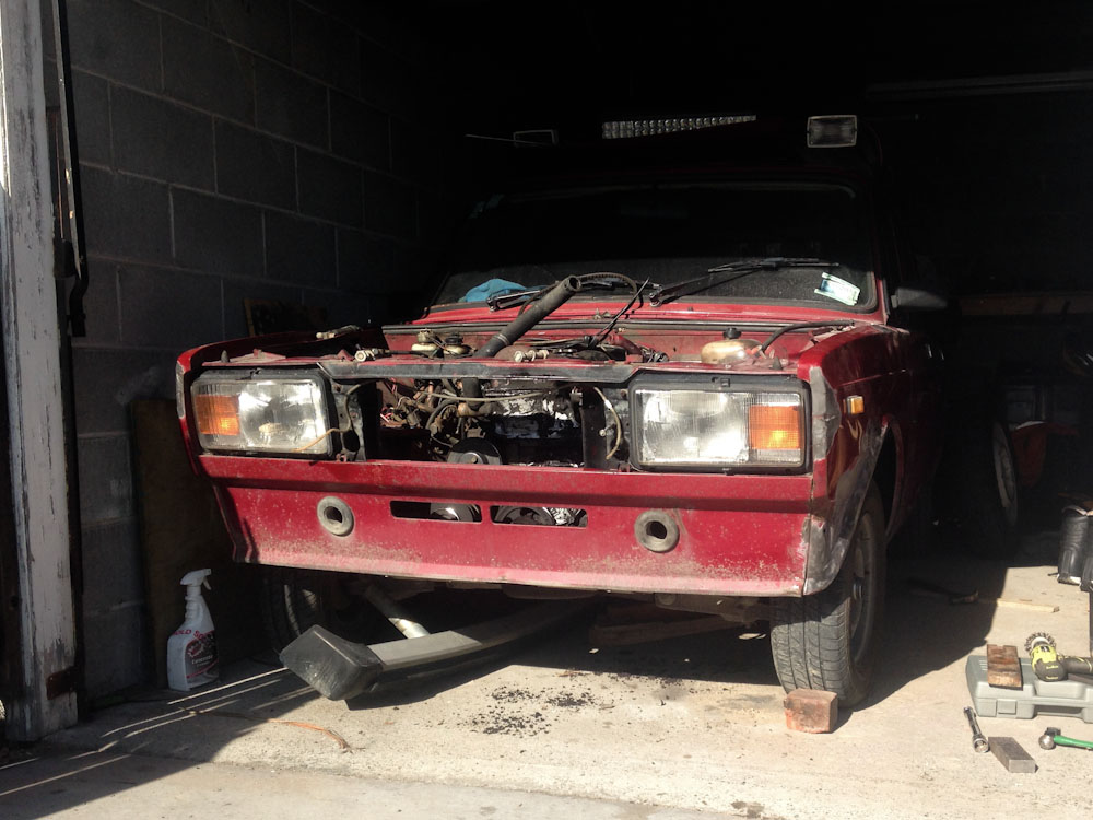

  13. Picked up the hammer and dolly set this week and have been slowly tapping away when I have time. Pulled the front bumper off to get at a small dent in the valance and noticed the damage is most likely from hitting a fence, there are gouges just the same size as fencing wire........ The front left guard has left me worried until I got the bumper off and realised this side has been punted in and with the help of a scissor jack i've pushed it out and the bulk of the bulge has gone, still a bit more fine tuning to get everything back where it should be but i'm now moderately hopeful I can save the guard, happy times! Actually quite like the front without the bumper, very boxy, stoked to be making progress, few more sessions and I'll have to decide what to do about replacing all the paint.... And hoping that I don't end up in the same place as Father Ted... Discussion //oldschool.co.nz/index.php?/topic/49397-nickjs-1989-lada-2105/

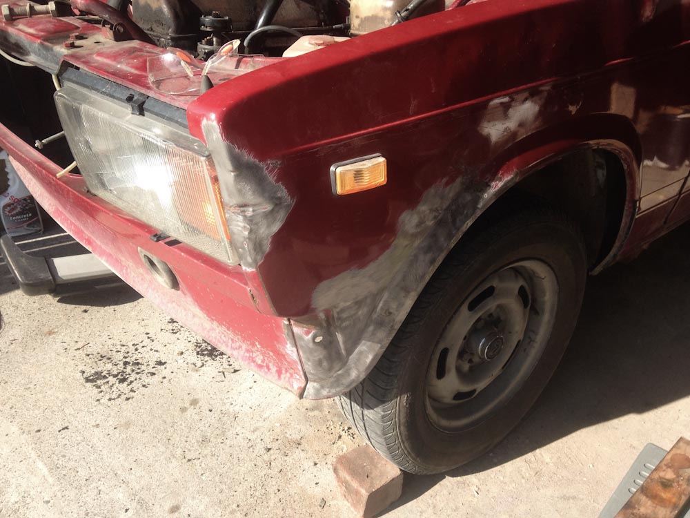

  15. Had a go at some of the easier dents, with only a claw hammer and lumps of metal for a dolly I've surprised myself with my first efforts, a mate has offered his hammer and dolly set so can't wait to get my hands on that! Before: After: I managed to use a strip of ply to pop the worse out, my bits of scrap metal don't quite fit in there! The plan will be once I have the dolly set to then shape it further, also has a small hole from the kink at the top, will have to weld that up. And another spot I should have got a before shot of, but was pretty bad. Check the gap between the gaurd and the rear panel, all over the car seams are pretty dodge, the lack of precision is a crack up, but its all part of the charm! Introducing Lilu, she enjoys helping me out, mostly by lazing in the sun on my spare niva rims If any panel beaters out there are keen for a beer or two, feel free to pop over, youtube isn't quite interactive enough!
