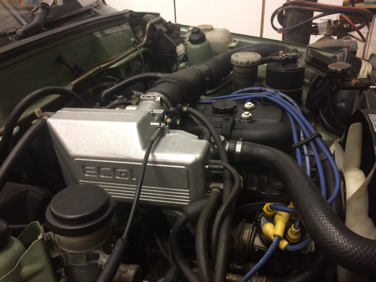

So with the rust and the Assembly done the next job would be a wof right? nah mate drove it a few times to work and back with no wof etc Then decided i would do a thing that i had needing to do on it for awhile which is a good wax and general tidy up of the paint so i spent one night did that then another night i went through and buffed all the windows of most of its water spotting etc. And then shit hit the fan.... it started miss firing on take offs knew it was the dizzy cap as i had never replaced it and have clean it up a few times too dropped the cap and rotor off at Bnt so they can get me a new one and they give me an old piston mazda 323 cap and rotor to try as they looked close gave the cap and rotor a go and what do you know now constant misfire took rotor out as someone previously had tried it on their car and fucked the metal retaining tabs tried out old rotor and new cap and no more misfire so went back to Bnt too pay for the parts and... NAH BRO THEIR FREE THEY WERE GOING IN THE BIN ANYWAY. Like what? YEAH BRO WE GOT THEM IN AS THEY WERE LISTED FOR OLD SCHOOL MAZDA PISTON ENGINE AND THEIR WRONG. AND PLUS THEY HAD ALREADY BEEN TRIED ON A VEHICLE AND BEEN WRITTEN OFF. YEEEEEAH FREE PARTS!. Then drove it to work another day after this misfire was sorted and then drive it home after work and notice the exhaust tone is abit louder so have a quick look underneath and can feel a leak pop in back in the shed and place it on some axle stands and find this The whole exhaust on this thing is getting abit past its used by date now... second bit ive had to patch up now got the old man on the welder again to patch it up done and made a new exhaust gasket too as old one was fucked and some newish bolts too as old ones were rusty n shit. yeeeeah
i think you will find is that the rubber piece on the crank pulley has broken away and has slipped causing your timing backshit out. I wouldnt imagine it being too hard sourcing one for this either happens from time to time on Japanese cars

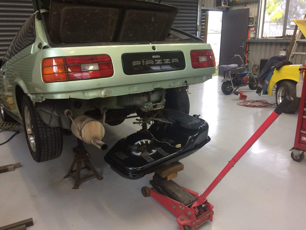

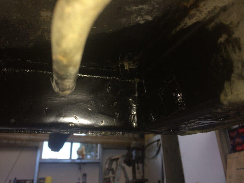

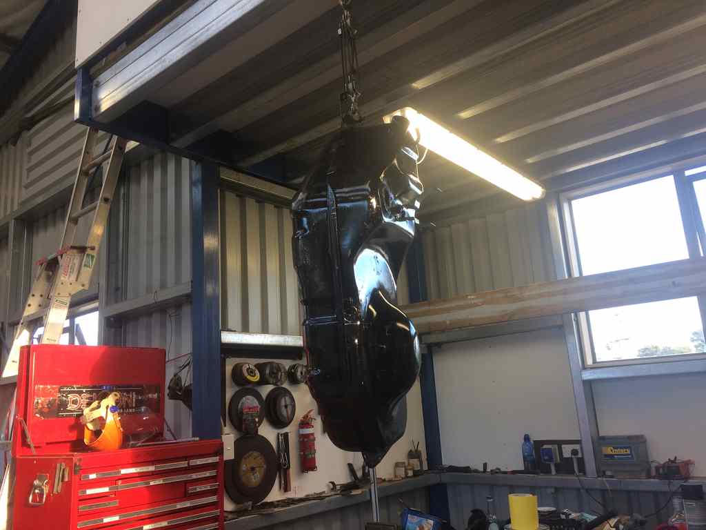

Right with the rust patches all done the next step was to put the fuel tank back in Easy job right! Well heres where the next job started opon removing one of the fuel hoses off the tank fitting the fitting come off the reason this had happend is that the tank had a dent on the bottom which had pushed the fuel pickup tube so it wasnt left with much strength to hold it in place. A few hits with the handle of a hammer sorted most of the tank dent issue so now i needed a way to fix it welding wasn't really an idea we wanted to do as fuel vapors etc so we went with the idea of a fuel sealant and some pop rivets to hold it down with that done i figured with the tank having some surface rust in places i should give it a lick of paint gave it the hand sand treatment as it didnt need much sanding one coat done Number two coat Also got my fan setup going on in the background which is a blower pump for a bouncy castle etc blows hard for what it is ended up coating the tank in POR 15 found it a great product as only used a brush to apply and when it dried the brush marks didn't come through only in a few places it did where i didn't do a great job with the brush just don't get the shit on your hands took me about 7 days to get it all off And that's when the tank went in also gave the tank straps a coat also along with cleaning all of the breather box and hoses then bumper went on afterwards

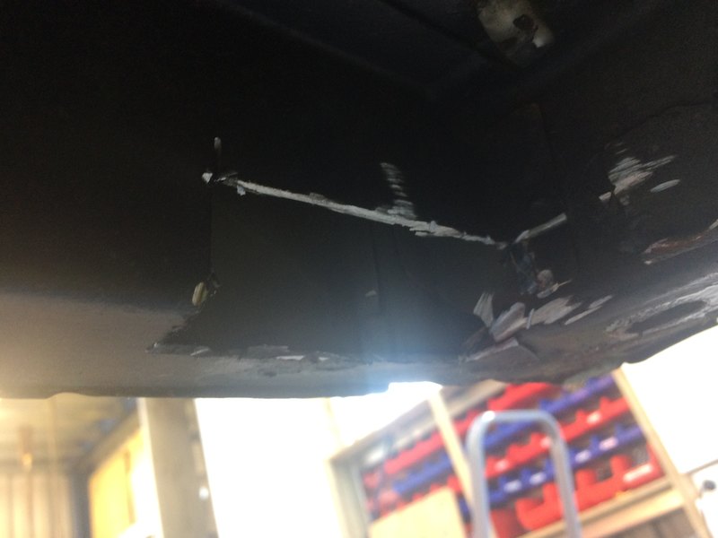

i then mixed up some body filler to tidy the job a bit more as you would notice the patch with just some paint on it i then applied some coats of POR15 over the patches to cover them and pervent rust coming back in the end the patches turn out okay wasnt 100% happy but that couldnt be helped as the replacement patches ended up being high than all the other steel around it and i also had some holes still there from where the welder burnt through so had to fill those but not to worry as you only see that corner if you take your time with a light and take a look. as i never knew in the first place it had rust there until the wof inspector took a close look in there but he had only noticed the rust on the L/H side and said he couldn't see any on the right.

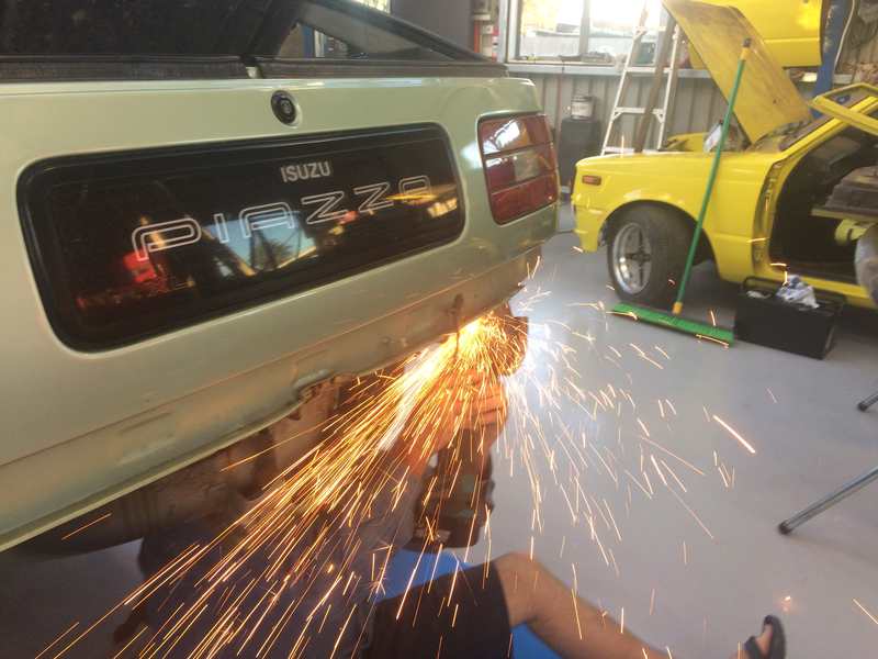

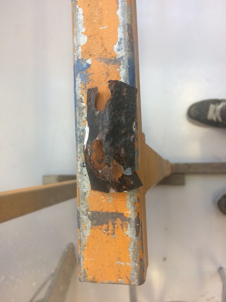

so here's the proof of the rust Then as it turns out the R/H side also has some rust there so now two patches are required so in order for us to cut the old steel out the fuel tank needed to be removed which turned out easier than expected then the old rusty steel had to be cut out so this was the L/H side then R/H sides turn which ended up in this And R/H side I then sprayed some rust converter in the chassis rails to slow down the process of other rust coming through so made up a patch for each side using some thicker panel steel and originally made from i also applied some paint to the inside of the patch panel to pervent that from starting rust also i then cleaned up the edges for the panel to weld in nicely and my old man got his safety gear ready to weld the patches in as i haven't done enough welding to be good enough yet. so with the welding getting done a whole lot of smoking also was created I now suppose you want to see the patches welded in right? well here we go so with that being done we both called it a night. the next day i set about tidying up the patch/welds to make it look less obvious i then mixed up some body filler to tidy the job a bit more as you would notice the patch with just some paint on it i then applied some coats of POR15 over the patches to cover them and pervent rust coming back
well ive had this car sitting around since september last year as went overseas etc took it in for a wof in december and upon inspection we found rust in the L/R chassis rail and tyres worn as i haven't replaced them since owning the car so algood with knowing that and still no wof i took it home for it to be repaired. month goes by so i pull the rear bumper off and have a look to find it will need a patch welded in so one long weekend comes and goes then the next i figured i should fix the thing. so in the shed it goes

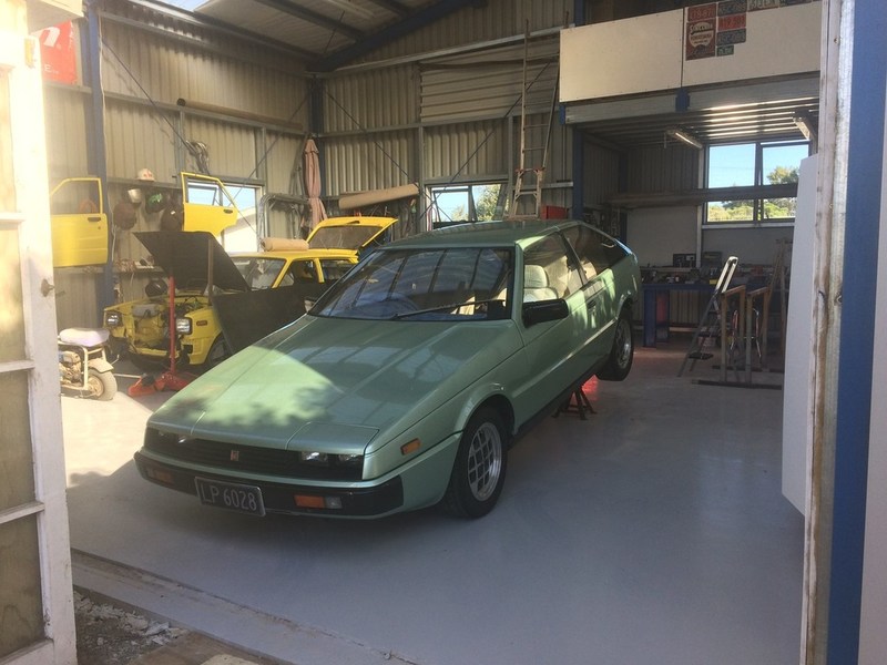

Have had to wait for floor paint to fully cure before placing any sitting items on the floor. has been 6 days since first coat so were good to go. just got to be careful not to scratch/chip it now -
Well the starlet ended up getting the move this evening but not under its own power due to no radiator and a bit of a cunt to get started had to jack the back up and pull it round to get it out as old shed hasn't got wide doors and fence is close by Old shed Into the new shed When we have finished putting everything into and away in the shed the car will be moved into a more suitable loaction in the corner where its rust surgery will go underway

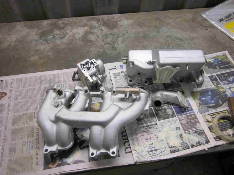

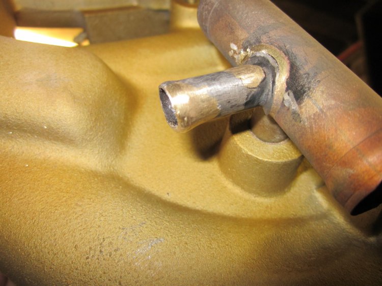

So i then looked at my options to what to do with it. paint it? blast it? polish it? get it done in vht? well so i decided to get it bead blasted. now what next i needed a paint that would stick to cast Aluminum. i thought about vht clear but wanted something that would last the heat and time. so i fucked around and talked to a few people. I then ended up going round to a friends place where he painted all his engines in a caprithane paint. he then offered to do mine free of charge but he would do it when he got time. A week went by so i popped round and spend a few hours masking all the bits up. few weeks later.... I popped round to check for progress He had brazied up a small piece on the water pipe that had a pin hole And........ Applied a primer coat on the intake pieces Mayte check out those masking skills then a couple weeks after that he rung me and told me he had applied the final coat of paint and it was ready for collection. but I had to spend many hours spinning yarns before leaving with the finshed products.
So now it was week two And back at work And that continued for quite awhile then i collected the cylinder head and fitted that on one of my days off while still trying to tidy/paint other bits up. ONE MONTH LATER..... I then looked at the intake system on it And while painting and tidying everything else up on the engine side of things it would make the whole thing look bad if i just put it back on.
