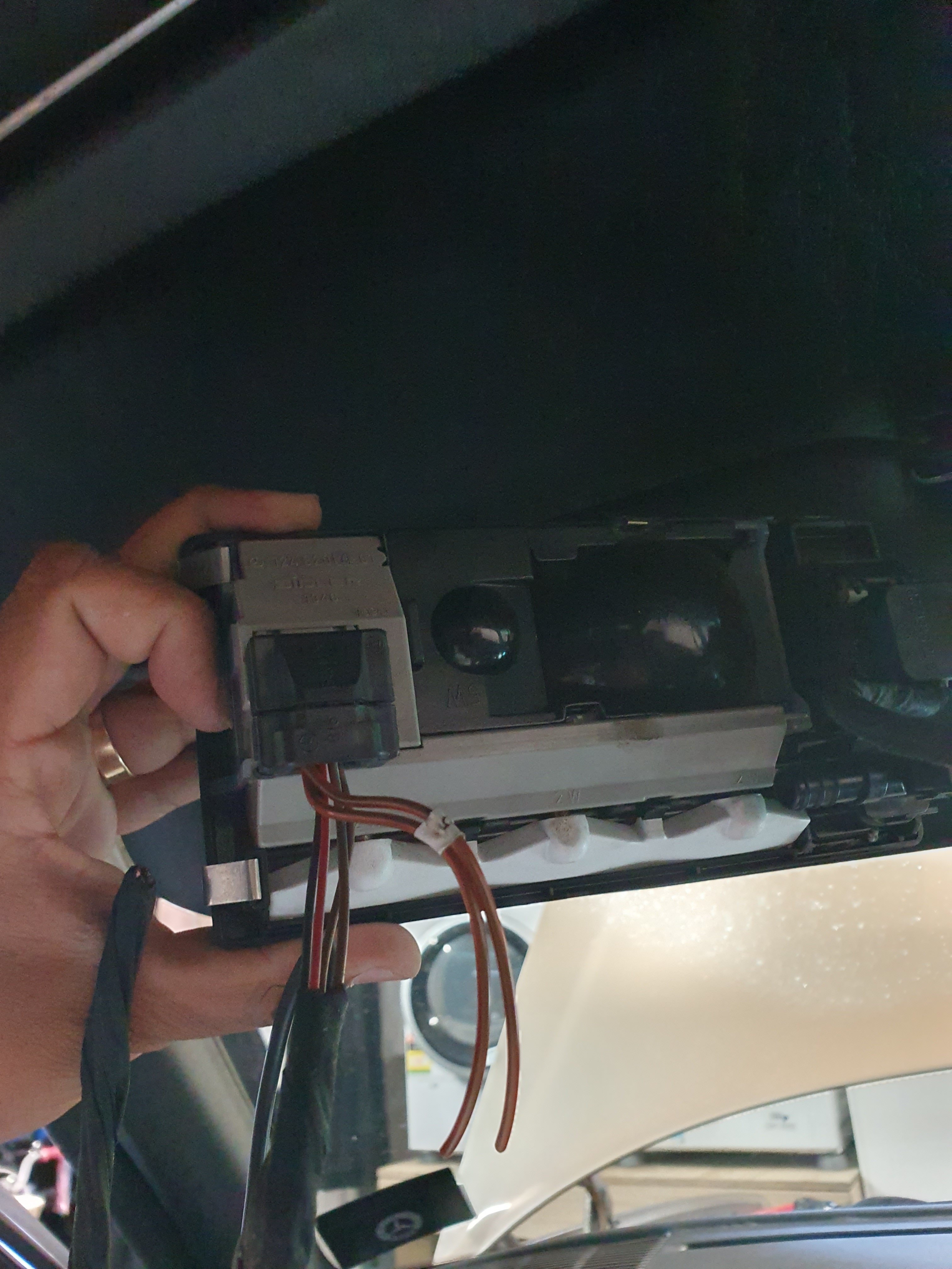

DirtyThirty Posted March 9 Author Posted March 9 I've come a step closer to my dream of owning a Porsche.......I used a 500E wiring diagram to wire in a W124 (which may or may probably most likely NOT be from an 500E) dome light. At this rate ill work myself up to a 930 in no time! Managed to make the W124 dome light work, all vanity lights on the visors work, door light delay, seat belt warning, all dome light functions all working. Surprised myself! Only thing remaining for the lights are the under door courtesy lights. Whenever the rear blind goes in, ill have to move the sunroof wires to the dome light sunroof switch which is an easy move, only so I can use the existing sunroof button for the rear blind. My janky test setup.... RESULT: Little subwoofer installed, worked for about 30 seconds then died....fault finding puts the actual built in amp at fault. Easy replacement. UPDATE: Amp was dead (loose wiring) AND the RCA's I used had a break in it somewhere, checked continuity and nada, so replaced and all working now. Found some locations for doubler plates, the inner ones are blank, any ideas? I thought maybe some diff or sway bar type mount? ANSWER: Its for the towbar support, which I now have. Seeing @Gator's run up Leadfoot ranch inspired me to start back on the 4AGE KP. What a sound! I better get onto it so it can be used next year 5 Quote
