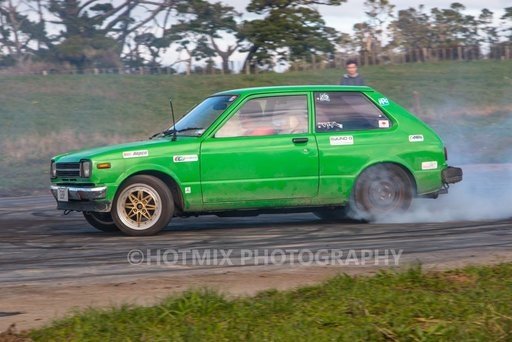

Since the last update I had the car tuned. Tuner is saying 45mm Dellorto are too big for the factory 4age (this is what my research has found as well) but car runs alot better he also fitted an oil pressure guage so its good to see that working. A few of the Naki boys organised a Skid pad day so not one to say no I chucked a locker in and went and had a play. infortunatly - Predictably - I blew an axle on the second time out (first one I used as a shake down ) so didnt really get going was still a good day out. 4age Kp 4g63 na Colt 13Bt Ke70 i think 4L escort

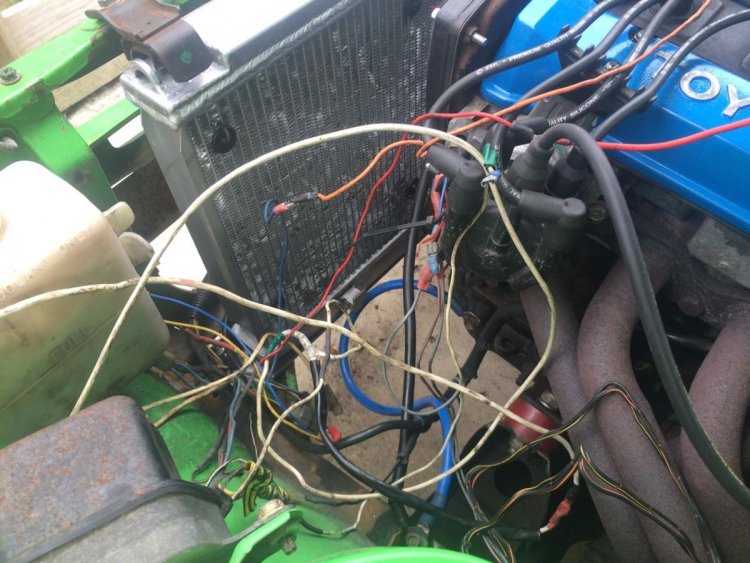

2 weeks 3 days till Gumboot Rally The auto sparkie came around last night and we got a fair bit done. Looks awesome again watching someone at their trade is something I am still in awe of my trade is talking so not that exciting to watch. almost ready for start up. quick before and after shots to appreciate the work
