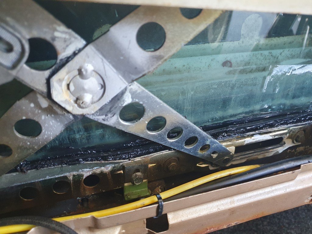

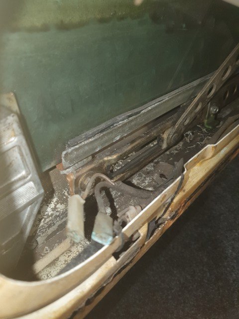

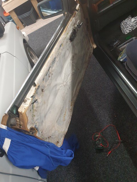

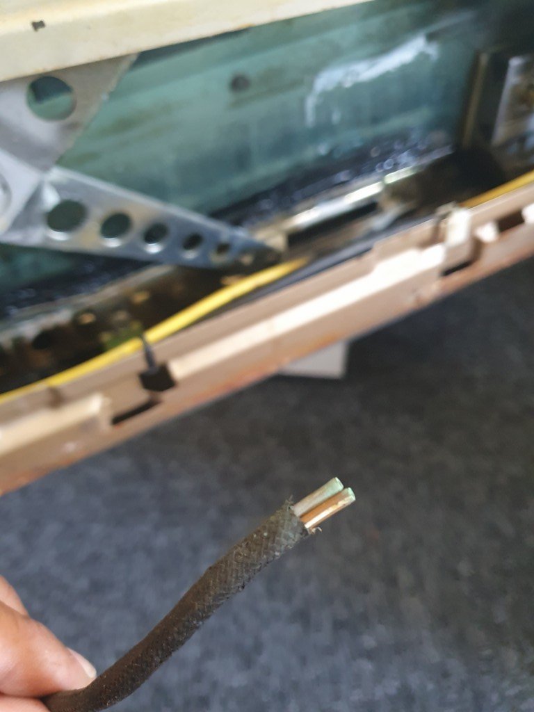

Unluggy uce, drivers side plugs had been cut off. Extended and sorted so all lights are going. Lubed all window guides and mechs as per other side. Managed to not break any clips again so thats a bonus. ....and someone filled the bottom of the window channel with black MS

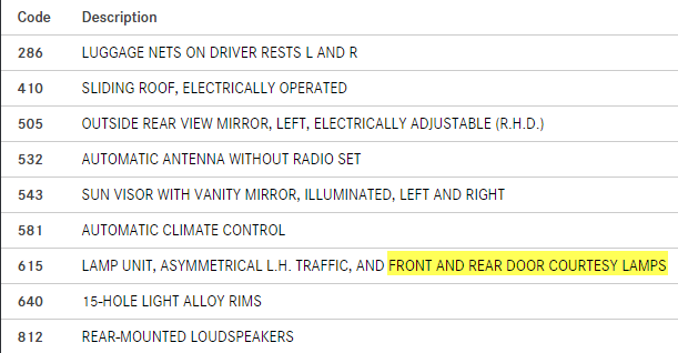

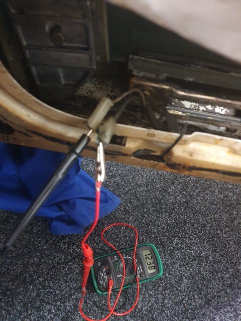

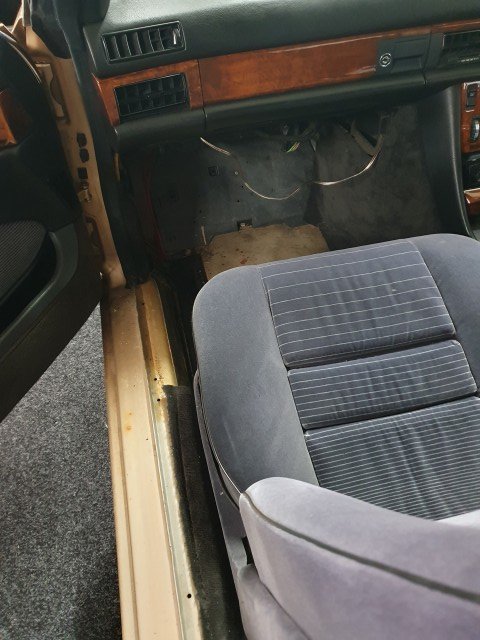

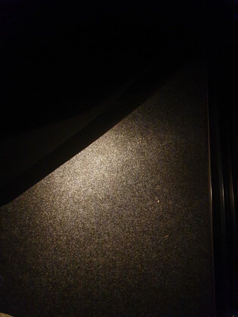

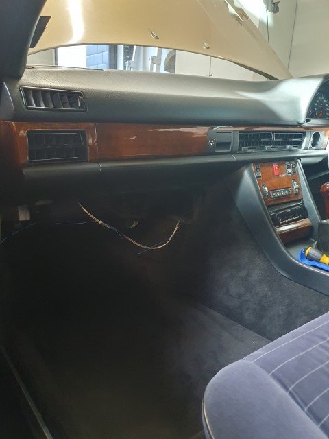

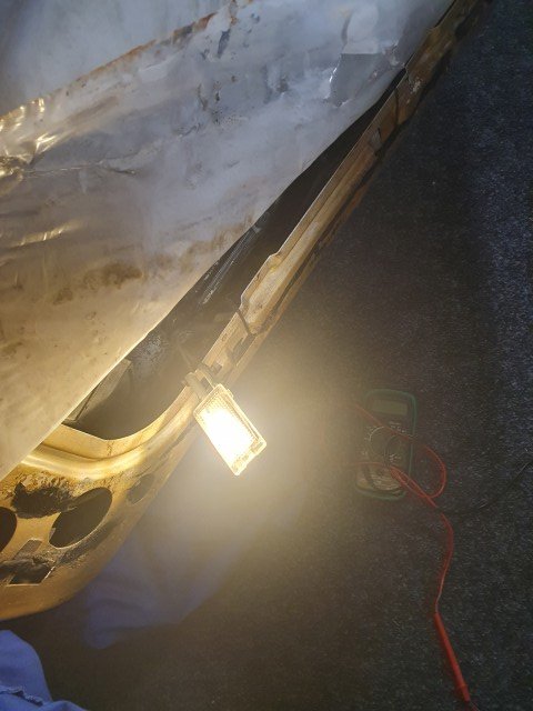

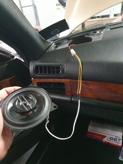

Courtesy lights I knew the car had the under door courtesy lights from the factory because the handy VIN decoder told me, however in someone's wisdom (probably when doing the interior swap) they removed them and cable tied the wiring inside the door. Dunno how rear door anything works on an SEC, but I'll take it! The door card had to come off, managed to confirm the wires were in fact there which is a relief. Tested to see if it was actually working before I start getting too excited (I have a nice new loom waiting from an SEL if it wasnt), thankfully its all working The top clips on the door card are molded in, which is stupid because they break and they're not meant to be replaceable. All but 1 seemed intact and that looked like it was a PO breakage. New courtesy light wired, fitted. Window guides and mechs all greased while I was in there. I've been replacing all the bulbs with a warm white LED. Door card fitted all back up.....but the door doesn't want to close properly as the vent in the door is hitting the duct on the side of the dash. Which is a problem because it wasn't like that before I started and there is no adjustment in the door card to slide it back. That tonights problem to solve, along with tacking the drivers side. Also tested the clock, its getting 12v so it'll be the capacitors needing replacement, might as well do the tacho ones as well since theyre about $0.80 each. While doing this job, I realised how solid the hardware and fixings Merc used really are. Its a very solid door card, the insulation inside and materials are pretty sturdy! Built like a tank. The way the world is going, might need to install a turret to the sunroof. Looks pretty smart I think. Not a huge fan of ice white lighting, or big Mercedes logos shining down onto the ground.

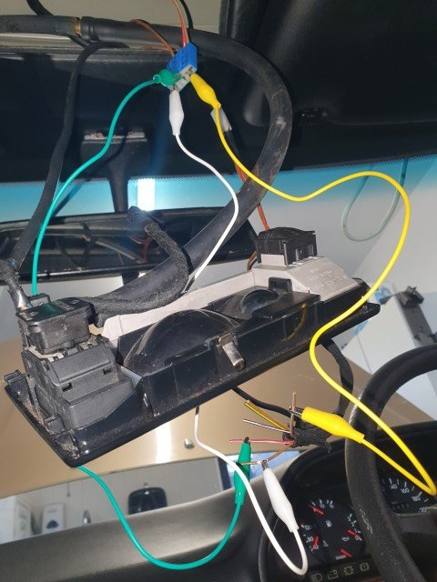

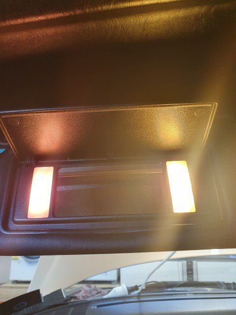

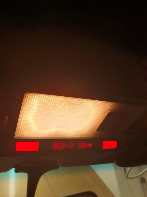

I've come a step closer to my dream of owning a Porsche.......I used a 500E wiring diagram to wire in a W124 (which may or may probably most likely NOT be from an 500E) dome light. At this rate ill work myself up to a 930 in no time! Managed to make the W124 dome light work, all vanity lights on the visors work, door light delay, seat belt warning, all dome light functions all working. Surprised myself! Only thing remaining for the lights are the under door courtesy lights. Whenever the rear blind goes in, ill have to move the sunroof wires to the dome light sunroof switch which is an easy move, only so I can use the existing sunroof button for the rear blind. My janky test setup.... RESULT: Little subwoofer installed, worked for about 30 seconds then died....fault finding puts the actual built in amp at fault. Easy replacement. UPDATE: Amp was dead (loose wiring) AND the RCA's I used had a break in it somewhere, checked continuity and nada, so replaced and all working now. Found some locations for doubler plates, the inner ones are blank, any ideas? I thought maybe some diff or sway bar type mount? ANSWER: Its for the towbar support, which I now have. Seeing @Gator's run up Leadfoot ranch inspired me to start back on the 4AGE KP. What a sound! I better get onto it so it can be used next year

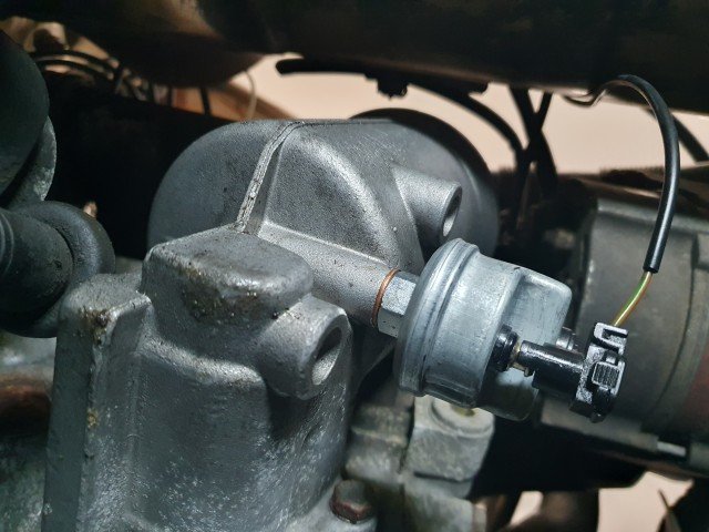

Had a constant dripping of oil since I got the thing AND oil pressure gauge doesnt work. Turns out the sender wasn't working and the drip was due to no crush washer. 2 birds stoned at once.... They don't have tapered NPT type threads which is annoying but a new sender and we're all sorted! I tried getting OEM but the shipping was insane from Rockauto so settled on the "economy" part, see how long this lasts.

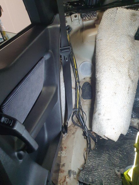

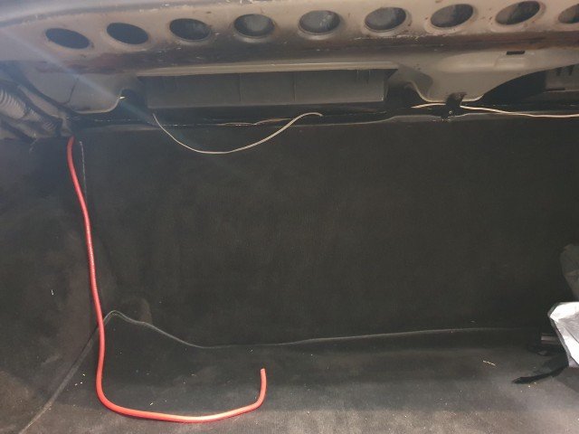

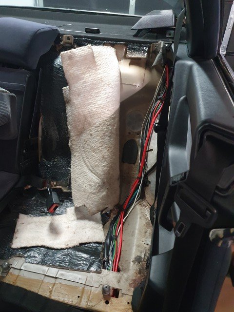

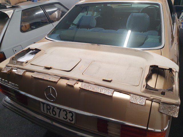

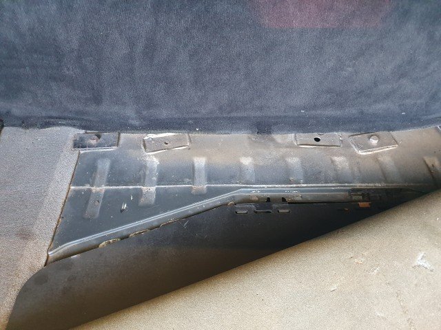

Subwoofer infrastructure/Dome light Decided to pull up the carpets and trim and run a power cable, remote cable and RCAs to the boot in preparation for a sub. Pretty simple but it also gave me a chance to tidy up some of the carpet and tuck it back under the trim. I've since found out that it has the wrong mats on the passenger side, its a drivers side one as it has molded foam underneath to "flatten" out the floor over the HVAC ducts. Found the old Alpine alarm system lurking. The plan is to build a subwoofer enclosure under the parcel shelf so its not taking up boot space. For now I will hook up my 10 year old Fusion under seat sub in the boot. As you can see from the photo below, I was thinking a bolt with a large fender washer though the existing punched holes in the parcel shelf that holds a big "U" shaped bracket which the sub is then bolted to. Should be no issue as Ill use flat bar and bend it up to suit. And all isolated with rubber to stop any unintended vibration. Finished product feat. bluetooth mic and subwoofer control. Again, need to sort a fascia for the head unit to tidy it up. Currently struggling to wire up the Gen2 dome light to the Gen1 car, but ill figure it out eventually, electronics are the worst. The plan is to move the sunroof button to the dome light location and use the existing sunroof button on the dash to operate the rear blind. I also found the rear screen demist button is a momentary switch for some reason, unless its REALLY fast at demisting. The temp sensors for the cabin seems to already have been relocated to the dome light area rather than in the dash so thats a bonus. I've worked out the passenger door switch for the dome light works but the drivers doesn't. I also have a full loom for the door courtesy lights from a '89 SE. That'll be a job when the car is on stands over winter. It already has 2 door switches each side, so the plan is to tap into one of those Also included is my prototype for fixing the seat belt presenter. Its a touch too tall, so im cutting it down to 10mm so it can fit into the slot on the extender arm rail. I think some small, short countersunk bolts will work and strengthen the area.

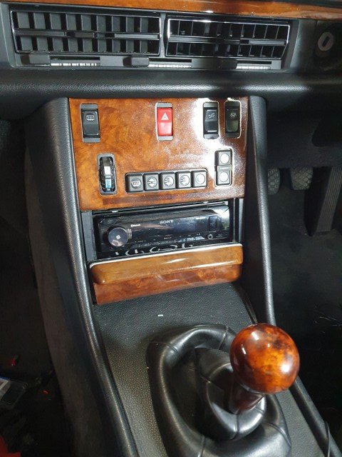

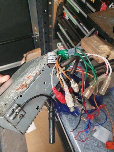

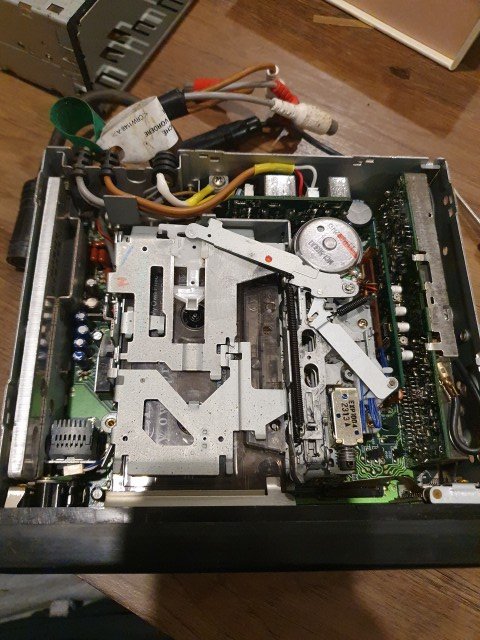

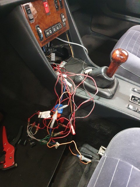

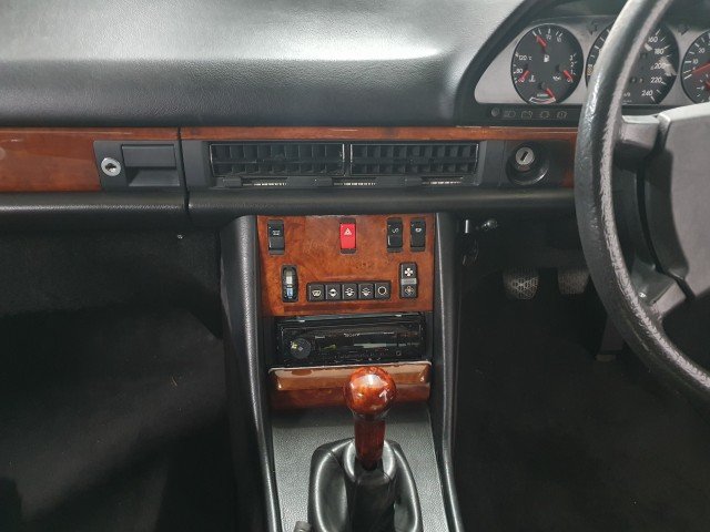

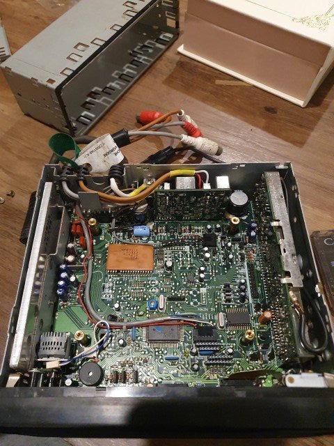

Head unit time. I love the period correct look however we also like listening to music via Bluetooth. Old Blaupunkt units or even the new ones are far too much $$$. Old Mercedes Becker units even without the Bluetooth mods were $$. So I found something subtle enough which you can match the stock illumination to. I chose the MEX-N5300BT for a couple of reasons (and found a boxed one on marketplace): 1. Has Bluetooth 2. Has a decent (for our purpose) built in amp, with direct subwoofer outputs 3. Looks not too out of place 4. Has an app to open the vast options menu rather than scrolling through the head unit 5. Added bonus of a CD slot Took the Old Pioneer unit out, which had a cassette stuck in there which wouldn't play or lift out. So I opened it up to find the following.... Ironically, I did release it from its own prison. I'm glad I didn't have to actually listen to it at any point. Next the rats nest of wiring, lucky the original tags on the head unit wiring were in tact for power, acc, antenna. I could figure out what's what, but then I found an old scanned copy of a wiring diagram. I tidied it all up with bullet connectors and the new head unit plugged in and worked right away! No smoke or fire. BONUS: Power antenna works. Ill just need to sort the speakers out as my next step. I have an old "under seat sub" which worked well in my MX5 so I kept it. My idea is to install it under the parcel shelf without drilling on some drop brackets, we aren't audiophiles just need a slight boost in low end. I've got some random bits and bobs arriving from Scotland, so hoping to sort the dome lights and install the courtesy lights that seemed to have been removed. Left front speaker wiring had to be completely rerun as it just wouldn't work. Uncovered how the shifter mechanism has been done, and an "Alpine Radar Sensor" which is attached to the old alarm. This alarm may or may not work, but once I figure out how tf to wire the new remote locking mechanism, I'd like to get the alarm updated. Final product (I need to get a proper fascia which I might get 3D printed)

Christmas came round! My daughter didn't really like the "Gold Car" as its "too noisy" but we've come around to it now and love it! Initially to make it more likeable, we dressed it up as Santa's German sleigh. Anna from Frozen is usually suction cupped to the rear window as well. I can report though that a car seat fits perfectly and with the windows all down, its easy to get her in and out of her seat due to the lack of B pillars. A perfect 80s family motorcar! Claus the German Santa Taxi (thinking about wiring the illuminated taxi sign to the dome light and leaving it on the parcel shelf) First thing small job was sorting the 12v cigarette lighter plug. Someone had taken its switched power and used it for the head unit install, nice. Pulled the cluster to find the "economy" gauge vacuum line was popped off. Another nice easy one. Tested the oil pressure gauge by disconnecting then grounding, turns out the sender is the issue. Cheap enough from overseas but the shipping and terrible NZD has meant I've put this off. Found a towbar off a sedan, managed to fit it easily enough. Wont be for any towing at all, just a good parking sensor. The support that bolts to the underside of the wheel well needs some tidying up as its a bit rusty so I haven't bothered installing that yet. It'll get welded, painting then installed. Before vs After Also got the parcel shelf out of that car with the factory storage bins. It wasn't the right colour and unfortunately I couldn't find a Navy Blue fabric spray paint so made do with black. Its come out pretty nice and might fade a touch, but its all installed. While removing the MDF 6x9 shelf, I found a monumental amount of rat shit. So I donned the full PPE needed and cleaned all that up, the car had been living outside at some point in its life. The paintwork gives that away. New parcel shelf in, 6x9s in the original speaker locations with the grilles just sitting on them for now. I need some 6.5" speakers for the rear with the stock Gen2 risers which are hard to find. The front dash speakers are 4 inch coax speakers, I need to sort out why the left wont work and find a suitable replacement. Upon removing the front left, its got 3 colour changes in wires within a space of about 500mm, they did however keep the OG Becker plugs which I'm grateful for, for no reason other than its original. The "new" parcel shelf (hat shelf) from a sedan, pre fabric dye. Before - during - after install Marty while at PaP found a W140, which had the rear electric sunshade in it. After a swift uninstall from the man himself, its sitting at home waiting to be dealt with. The motor works once we tried it, its a bit longer than I thought it would be, but it still JUST fits. I've got the old parcel shelf out to test it on. It'll need to sit on top of the parcel shelf rather than inside and recessed unfortunately, as the curve of the rear screen and angle make it difficult otherwise. Ill have to build some sort of a box to hide the mechanism as best as I can.
