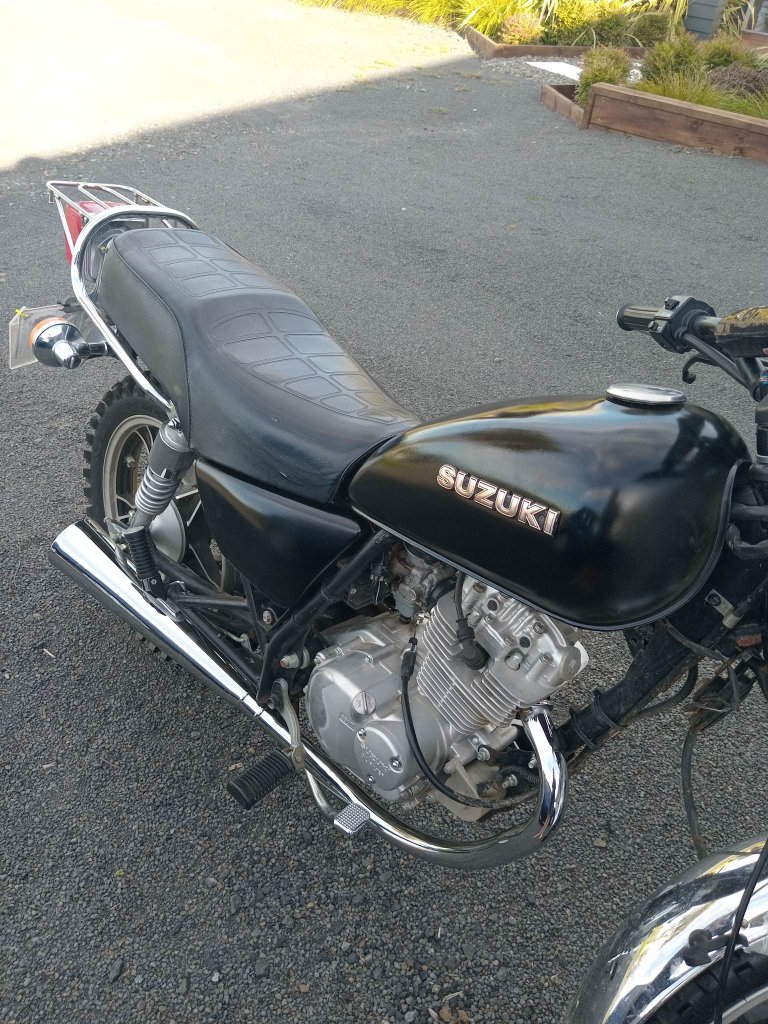

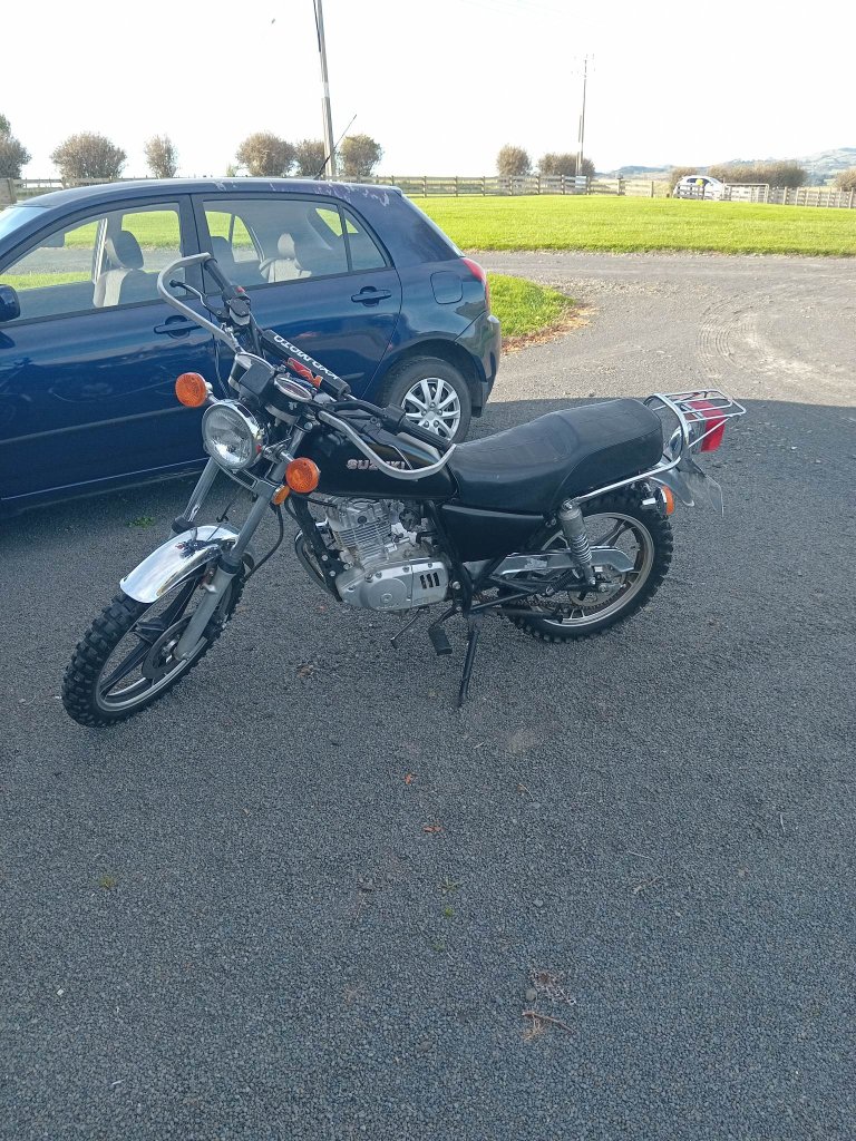

3 generations of Muncies impulse bought the same GN125.....

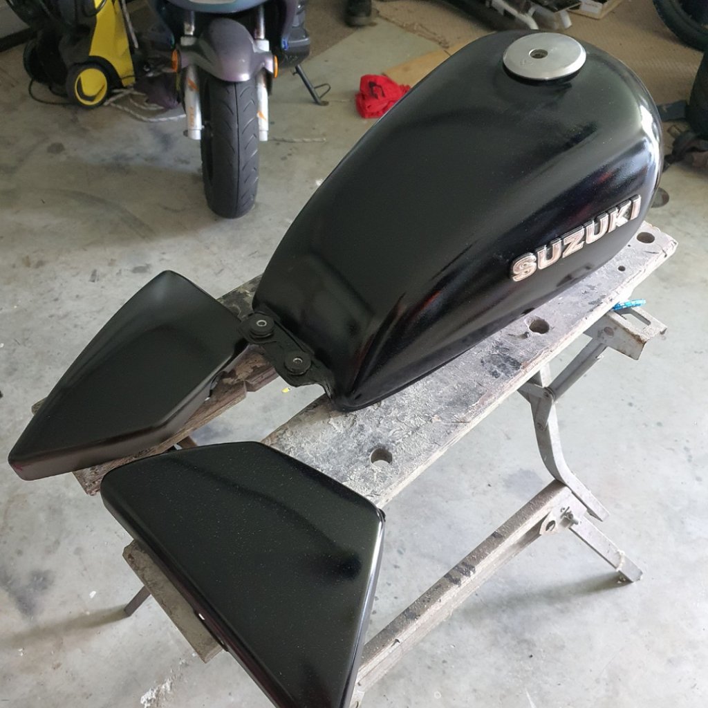

Mixed up some chameleon green purple blue flip, went to do base coat black and gun decided to play up so I used a stack of thinners clearing it out finally got a good coat of black on and called it a day.
Will let the paint harden and go at it again another day give it a light scuff more black then go colour and clear.
For now Zach can take parts home it and ride it ground work Is done.

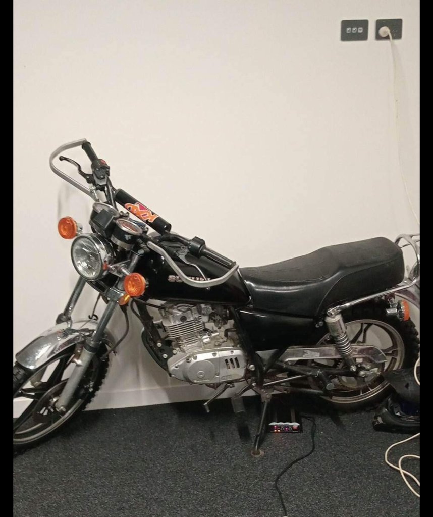

update I can wheelie now can scrape luggage rack then keep going had to take the "plate" off cause I bent it in half cant wait to get it legal then a dr200 motor once or if I get the money
