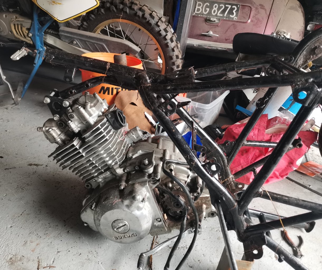

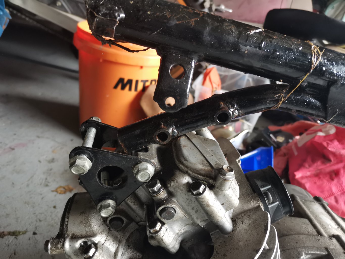

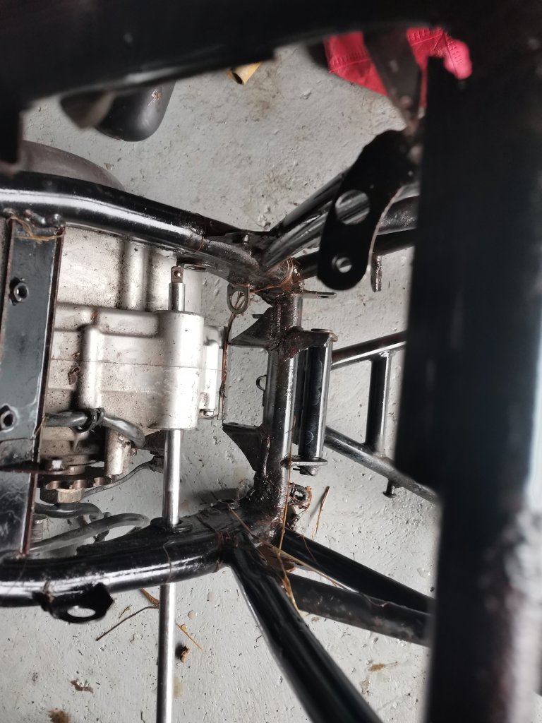

15 minutes ago, tortron said:
Not quite
The front mount to rear mount on the 125 is about 30cm, the 250 is about 35
The 250 top mount looks about 4cm taller than the 125.
You might just get away with making top and front engine mounts, but I think it will probably need the frame modded
It looks like you could get the rear mounts to work
I think the engine will be about touching the top of the frame and the front down tube based on measuring my gn125
Hmmm could buy the gn250 see if it will work if not just put the gn250 in the ching chong bike
  • Replies 84
21 minutes ago, tortron said:
At that point maybe consider just riding the 250
Cutting up a GN125 and a gn250 to make a gn250 might need a sniff test
I guess just to be different and the gn125 is more complete and not rusted and i know i can get ot legal in the future not sure about the gn250
Take this back half of a GN125 frame and cut up the gn250 if you want
Will have to narrow the rear mount on the engine, or widen on the frame. This will get you a little more clearance on the top engine mount to frame.
The front engine mount will be too far forward for the 125 frame still I think
DR200 or accept the 125cc is as good as it gets seems best option here. I can get fairly carried away but for this seems like to much effort for minimal gain.

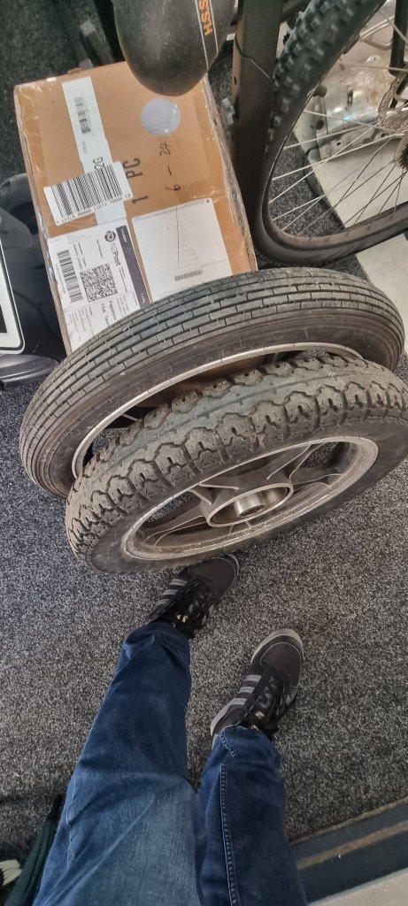

@tortron I've been starting to look at putting the mighty gn125 to street and cant find street gearing for the life of me and tires are a bit hard to if you point me in the right direction id appreciate it
There's basically only the one tyre available for the 16" rear (you can get a good one but you have to import it yourself). Front is fairly easy as 18" is common for rear tyres and there's 'plenty' of front/rear options available there.
I have a heidenau scout on the front and I put at 18" rear on mine and run a shinko SR244 on that
Stock gearing is around 14/43 tho some years are a tooth different for no real reason

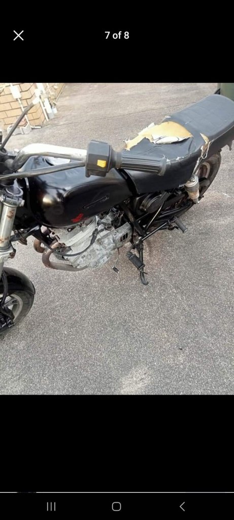

On 01/06/2022 at 18:36, Muncie said:
Test ride done with no exhaust pretty peppy once it's moving but 90 ks it's on the redline with the farm gears.
Gave it a wipe with an oily rag and gotta say it's pretty mint! A puff of paint and it'll be too nice to let the kids on.
Amazed it's been on a farm and the seat is immaculate foam is soft vinyl isn't rooted gave it a clean and leather cream it's glossy as.
Tell me about farm reg? I want to get it back in system but not pay full bike reg yet.
Hey, What tyres have you got on this GN125, I cant find any dual tertian types anywhere?
If you want some knobblies would be keen to swap.
Yeah I have got the original GN125 on the Rims at the moment which I want to upgrade
