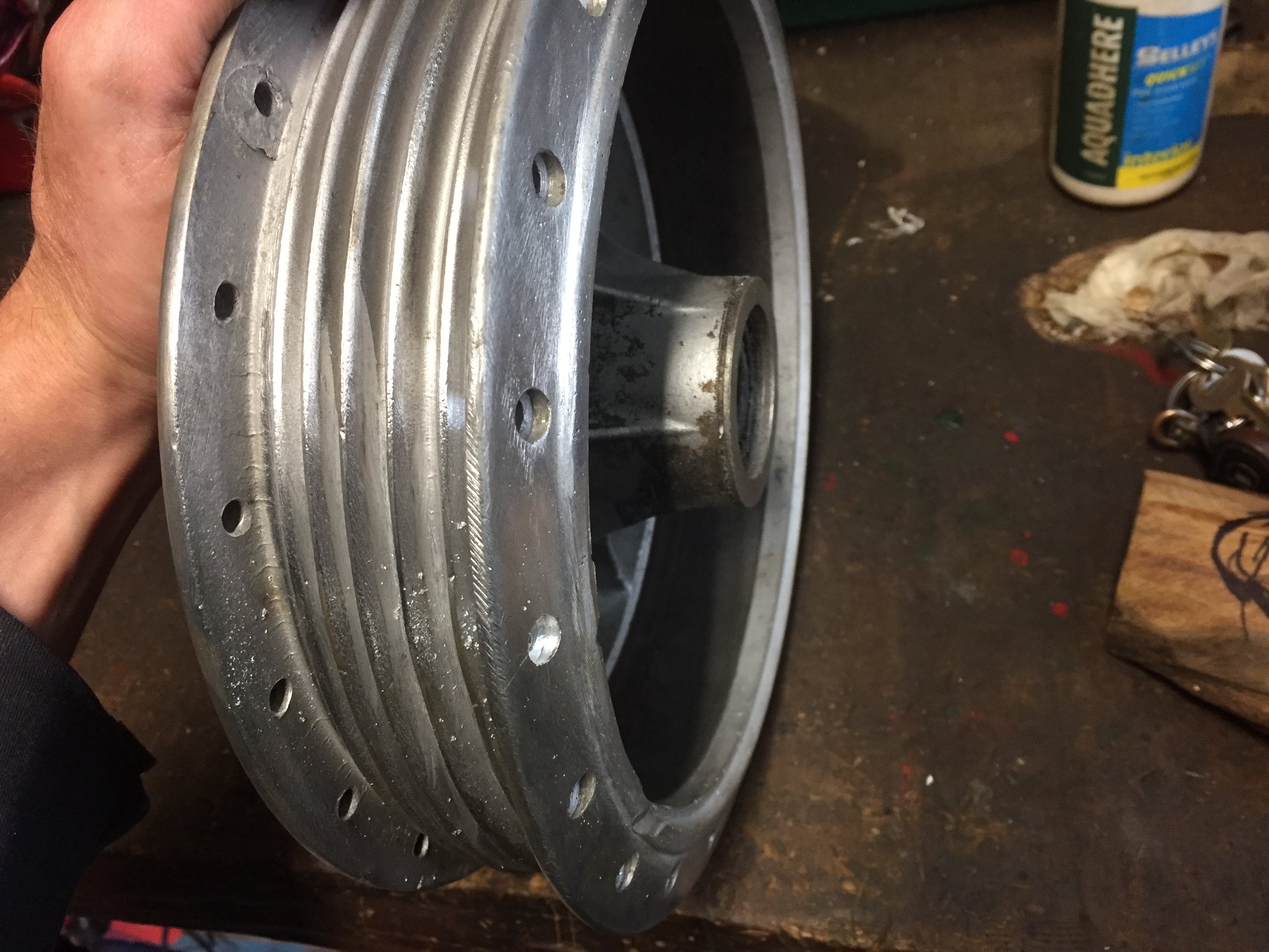

Picked up this plunger frame Arial wheel that has been modified to fit my Norton frame, this was a common thing to do back in the day for side car racing as the Arial wheel has a much stronger hub, and being a plunger the axel must be 4 times as thick as a normal swing arm axel. Also got some Triumph clutch parts as I have adapted a 4 spring Triumph clutch to my BSA.
