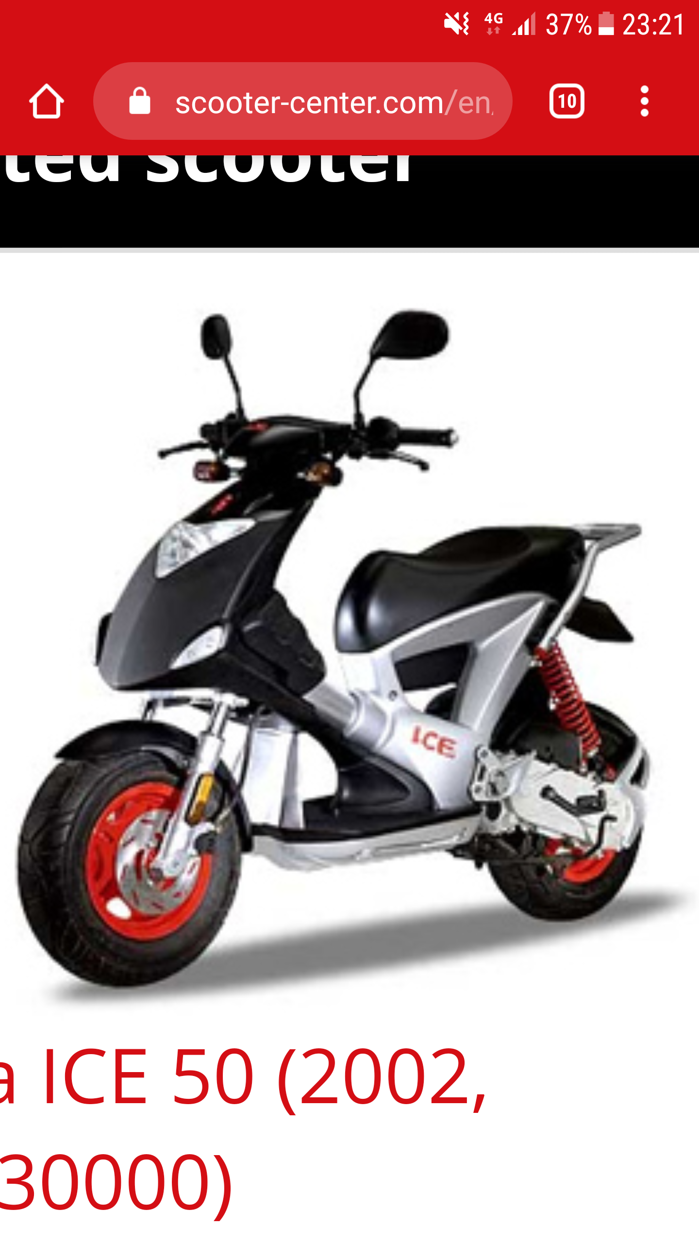

rumrum Posted July 5, 2020 Author Posted July 5, 2020 here's what they are supposed to look like 1 Quote
