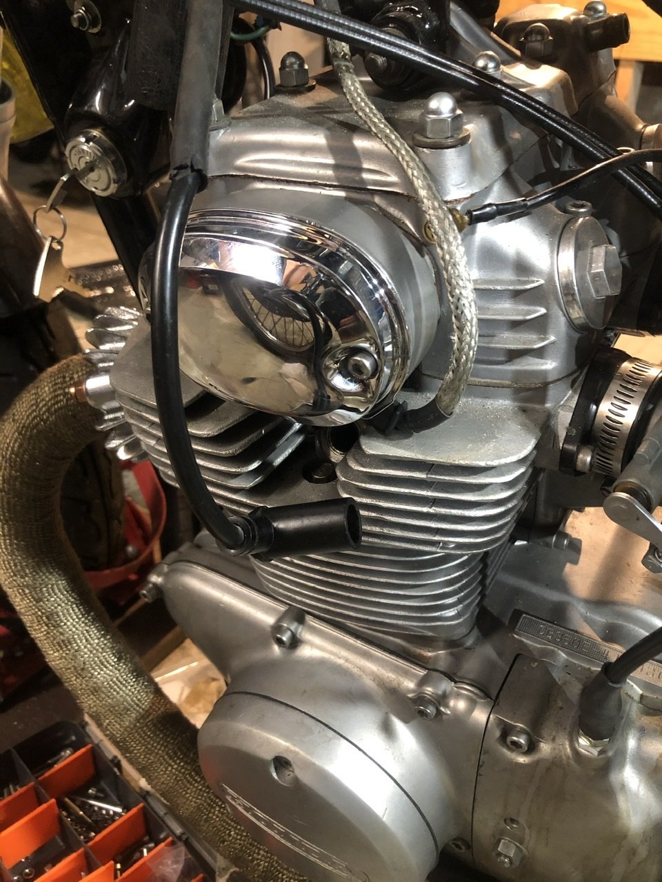

Abarth Posted February 15, 2020 Author Posted February 15, 2020 Send some bits away to get chromed and bright zinc plated. Fresh chrome looks amazing, points cover and the suspension fork bolts are now perfect. Wasn’t cheap but those parts aren’t available new anymore. To be fair they were pitted badly and most of the time was probably spent tidying up the parts before chroming. The bright zinc was super cheap to get plated, like $20. However no prep is done. If I’d known I’d have polished out the pitting marks more but for 20 bucks it look a million times better than it did. 8 Quote

Abarth Posted February 15, 2020 Author Posted February 15, 2020 Cheers. Bumper Replacements in Onehunga for the Chrome. Final bill was $250 but the condition was pretty bad. Acme Plating also in Onehunga did the bright zinc plate. 2 Quote

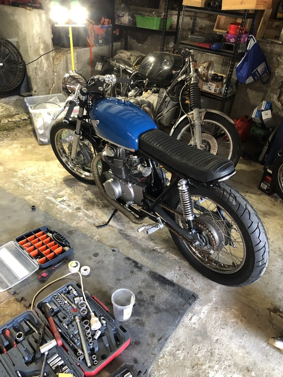

Popular Post Abarth Posted April 10, 2020 Author Popular Post Posted April 10, 2020 Finished off the rest of the electrics and fired it right up. Did a spanner check and tightened up all the remaining lose bolts. Finally finished! 9 1 Quote
