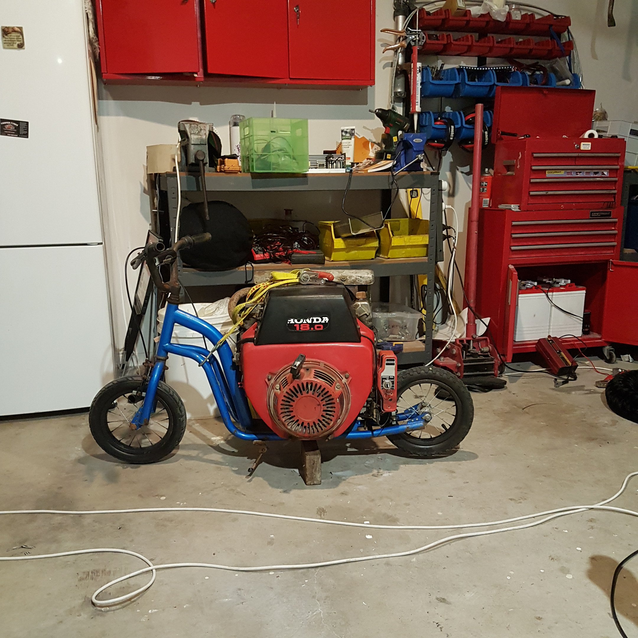

Muncie Posted December 15, 2016 Author Posted December 15, 2016 This is a busy little spot chain cogs shafts and brake all stuffed in there little battery so i can ride it at night (need a light) so people cant see how ridiculous i look at speed. Signs of life...... Awful smelling tyre it certainly spins fast enough 1 Quote

Muncie Posted August 20, 2017 Author Posted August 20, 2017 stripped all the covers off this weekend and gave the thing a good clean has definitely been looked after brand new carb and air filter inside. Previous owner thought it had low compression as it was hard to start and struggled to stay running, threw 12 volts at it turned key with a puff of engine start away it went.... and then died without picking up any fuel. Fuel pump is shot sucks up just enough to make it run not enough to do anything useful but it definitely sounds sweet with no muffler. It also has a proper oil system so a turbo would actually work on it being 610cc it would spool up a small one too. Right i need a frame....... Quote
Muncie Posted September 2, 2017 Author Posted September 2, 2017 Electric fuel pump on now it starts and runs with very little fuss. My son insisted it needs the turbo i had stored for my triumph on it think he may be right. Go kart or mini chopper frame needed asap. Quote
Muncie Posted November 11, 2017 Author Posted November 11, 2017 Time for the big block conversion...... The 2.5 hp motor had become so temperamental recently It had to go as well as the electric scooter wheels which cant handle rough surfaces at all. I've got some pocket bike wheels for it now which will give me disc brakes too (much needed) going for a Cvt on this instead of the centrifugal clutch. 1 Quote
Muncie Posted November 11, 2017 Author Posted November 11, 2017 Will be mental sounds like a buell with the straight pipe will be getting straight twin pipes once it's mobile again. 1 Quote
Muncie Posted November 12, 2017 Author Posted November 12, 2017 Started stripping off anything that isn't motocycly so it doesn't look like a kitchen appliance. More dirt..... another dose of oven cleaner and a waterblasting is called for. 1 Quote
Muncie Posted November 12, 2017 Author Posted November 12, 2017 Wanting a more sexy carb setup a 2 barrel downdraught with a nice air filter would be my preference, though some bike carbs would float my boat as well. 1 Quote
flyingbrick Posted November 12, 2017 Posted November 12, 2017 Oh wow, that motor is HUGE. I vote minibike frame 1 Quote
