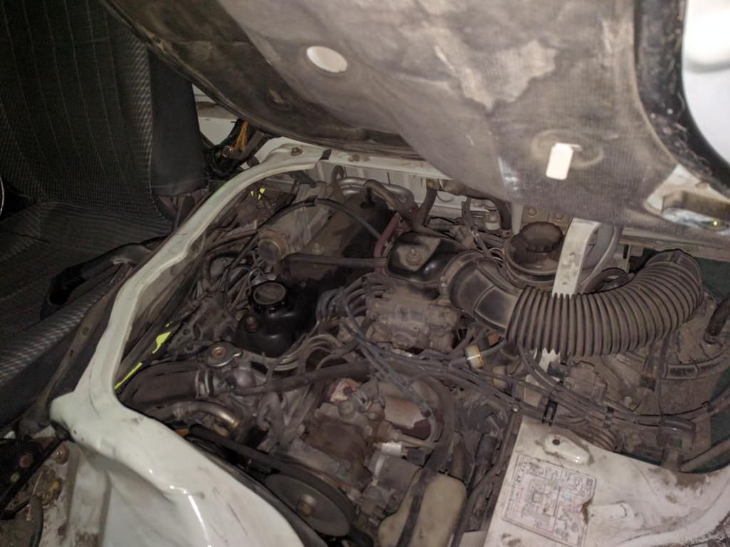

ThePog Posted November 7, 2016 Author Posted November 7, 2016 Bit shit cos dark in the shop right now. Quote
HighLUX Posted November 7, 2016 Posted November 7, 2016 Looks like it should fit. Might have to mount the powersteering reservoir somewhere else. The throttlebody should sit at the same height as the hose coming off the carb Quote
