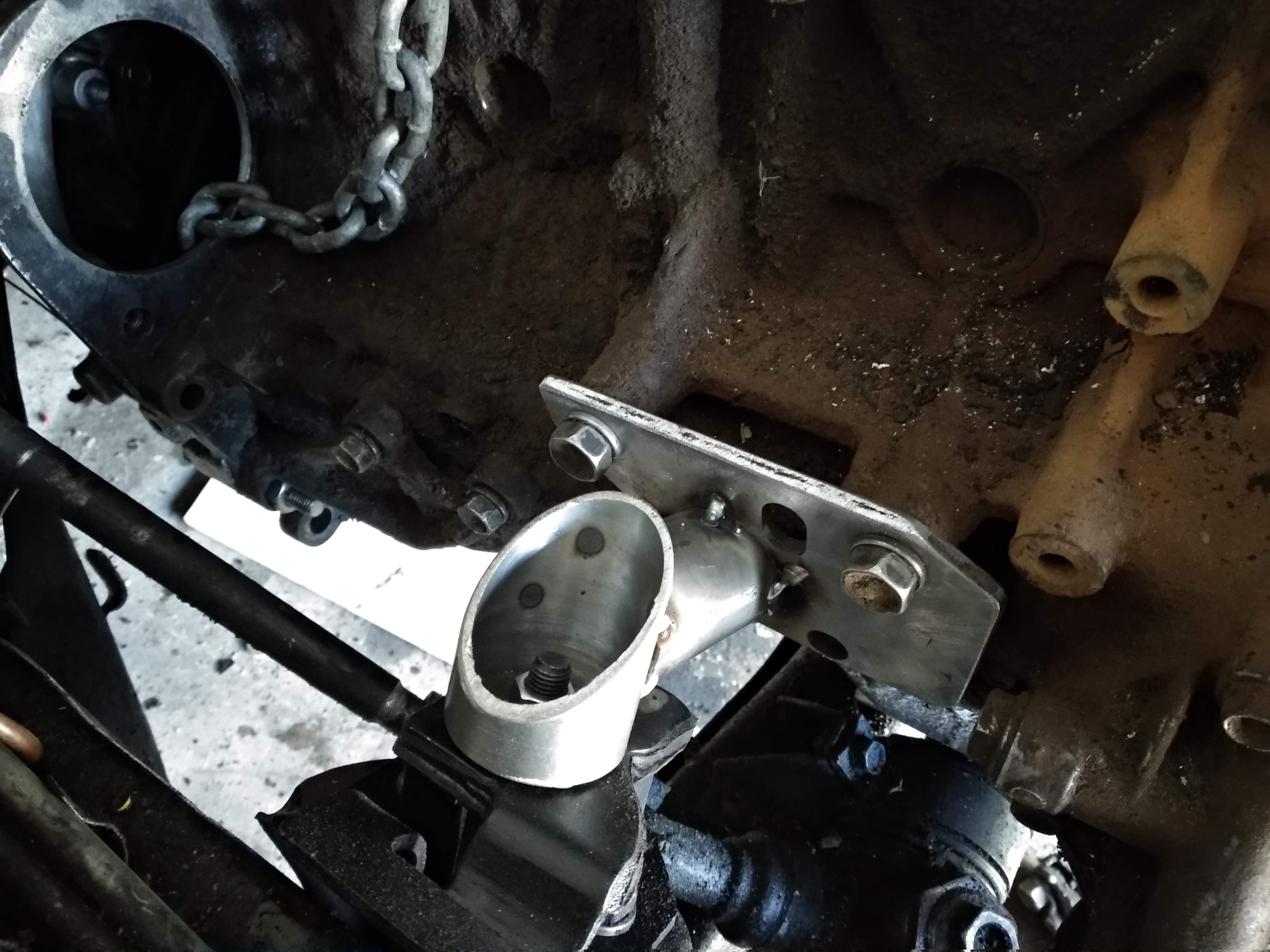

Popular Post zep Posted October 25, 2020 Author Popular Post Posted October 25, 2020 Did you ask for real progress? @EURON8 and I (mostly Chris) have got the engine mounts for the D1 tacked up. Chris will weld them up and then I can get back to sorting the sump. At this point I could pretty much have put a better engine in. At least it's still Isuzu? Also, thanks to @Snoozin @Spencer and @Thousand Dollar Supercar for their help with the AE101 brake kits. They turned up this week 14 Quote
Popular Post zep Posted October 29, 2020 Author Popular Post Posted October 29, 2020 Chris finished welding up the mounts, just need to be cleaned up and coated now. Should be super solid. Now I can get back on to sorting the sump out. 14 Quote

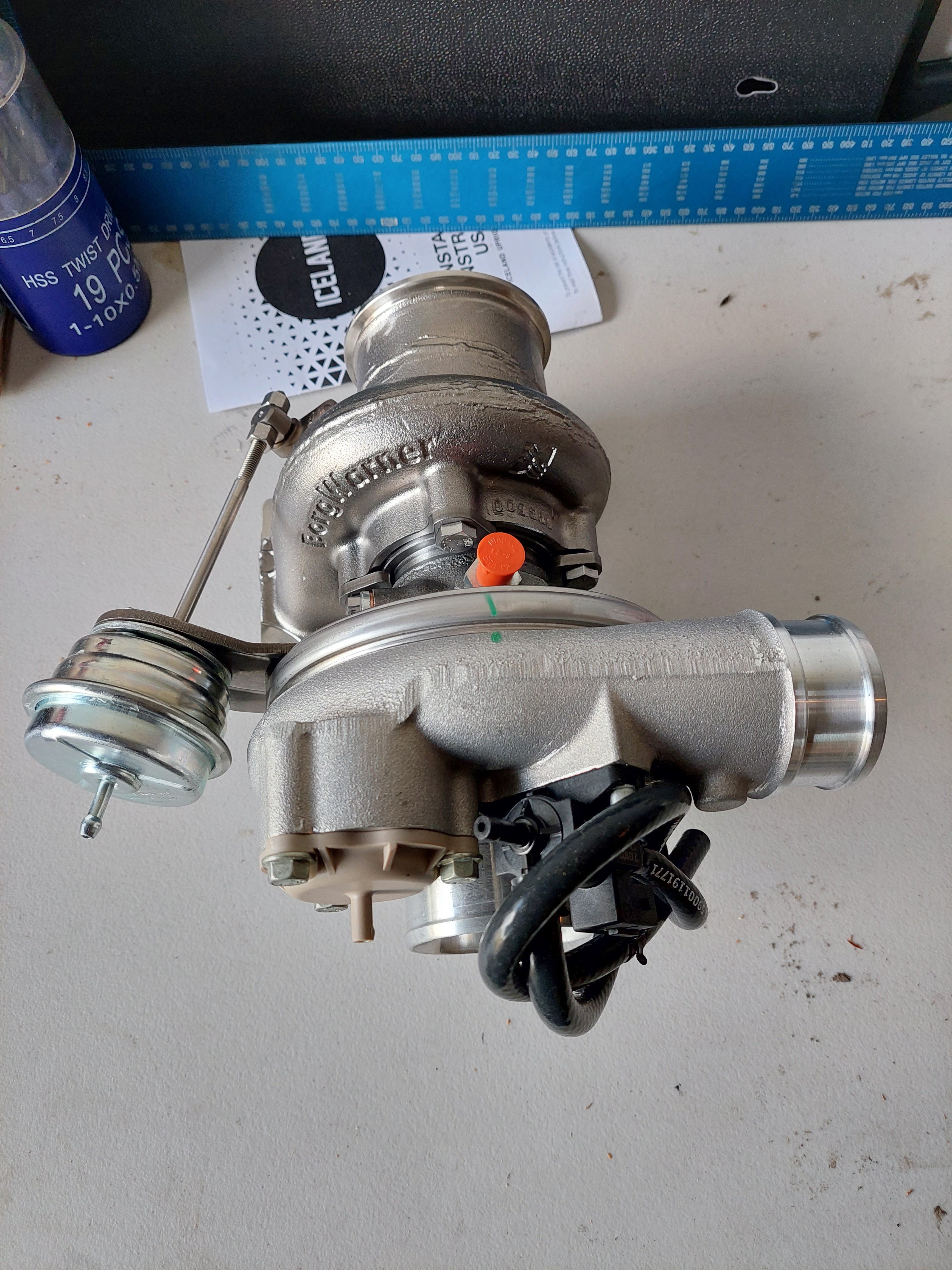

Popular Post zep Posted May 19, 2021 Author Popular Post Posted May 19, 2021 Hello everybody and welcome to another installment of Guess what expensive thing zep just bought! Today we're really ramping up the costs with a really fast spinny thing. No, it's a not a fidget spinner, and no, not chatter rings. What could it be? Third time's a charm and you guessed it, a Borgwarner EFR6758 T25 0.64 turbo charger! This is not a huge turbo but it's the biggest I've owned! I went with the lower A/R to get maximum low down boost. The wheels are 67mm on the compressor and 58mm on the turbine. It's rated for between 250 and 500 hp, so more than enough room to play with. I guess this is a better time than any to outline my plans for the engine. As you would have read, I've ditched the G161z and am upgrading to a 4ZD1, which is a 2.3 litre 4 cylinder - still Isuzu, it comes out of a Trooper. The 4Z engine series are essentially a new version of the G series, the main difference being that they are belt rather than chain driven, and of course come in larger capacities (2.0, 2.3 and 2.6). There has and continues to be a lot of development for both the 4Z and G series engines over in Aussie. For the 4Z, most of it is happening around the 2.6 4ZE1 but it applicable to all engines. My engine will be a 4ZD1 with a 4ZE1 head, which has much larger ports than the D1 head. The head will also have Brawler light weight high-ratio (1.8 I think) rockers, Brawler light weight valve springs and retainers, and a brand new, super hard billet cam with a Brawler grind, both of which are newly developed. The high ratio rockers are designed to work in tandem with the new cam grind. For now I will just keep the stock valve sizes, which are 38mm and 44mm, but will make sure the ports flow well. The bottom end will have custom CP pistons, also made in conjunction with Brawler, to bring the compression up to about 9.0:1 and make sure the valves have plenty of space to play with. For rods I'll use MaxSpeeding or Spool, not sure yet. No plans for the crank, is it worth mucking around with it? Obviously I will be running this turbo on the exhaust side, and the inlet is a 66mm Bosch throttle body. A crank pulley mounted CAS will provide the signal and four LS1 coils will give it spark. Everything will be controlled with a new LINK G4X Xtreme, which might just be the focus of the next installment of Guess what expensive thing zep just bought!, so keep that in mind! 16 Quote
