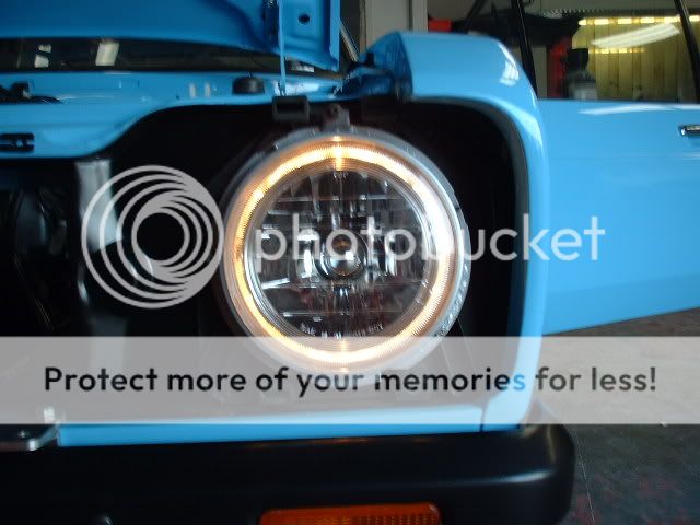

BigDave Posted July 13, 2004 Posted July 13, 2004 You can fit any bulbs you like mate. I have some of blue ones some place? I actually have the BMW style "angle eyes" lights fitted to my Mk2. They are the type that have the side lights as a ring/circle around teh outside of lights, they look very different! Quote
