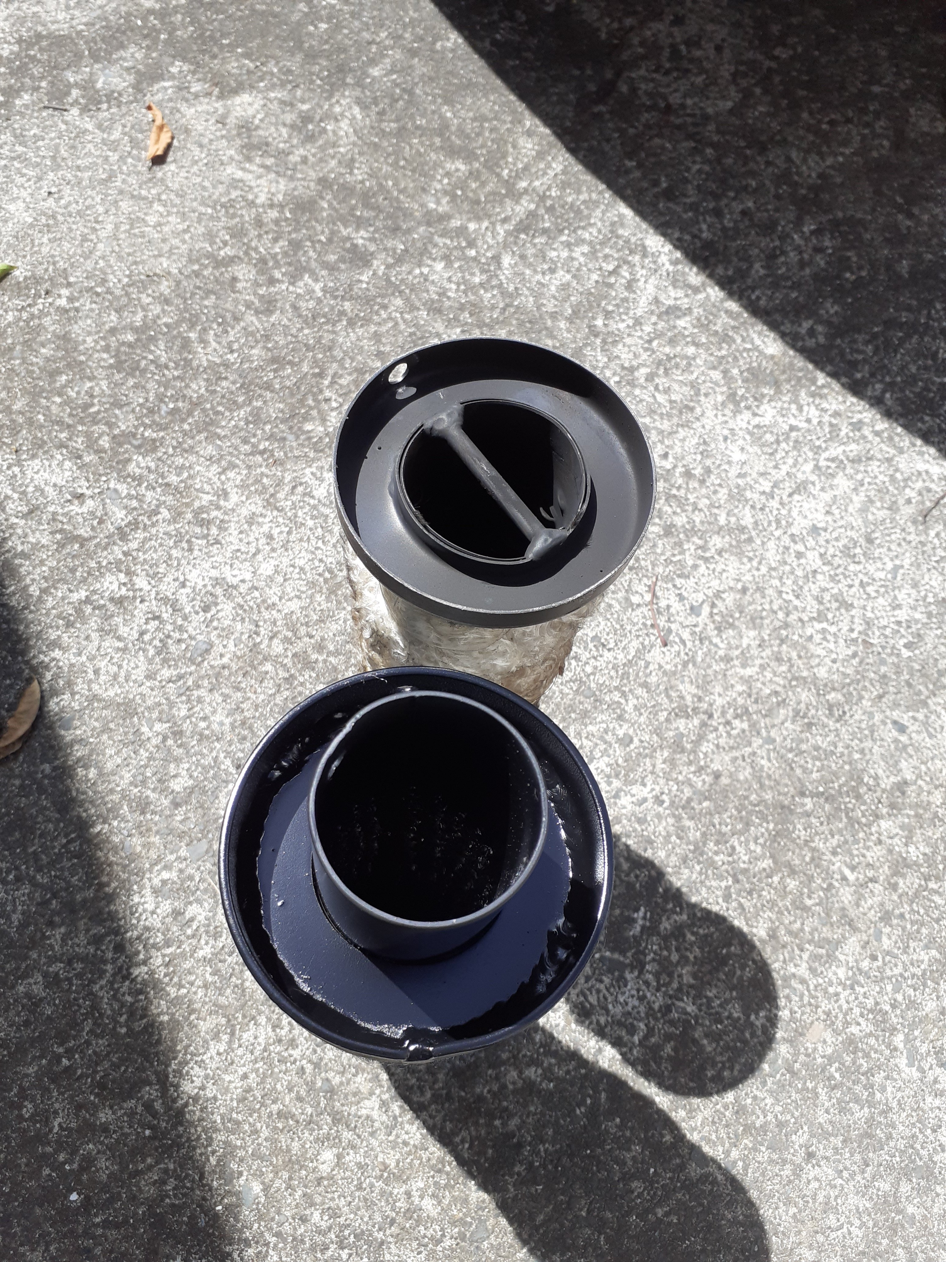

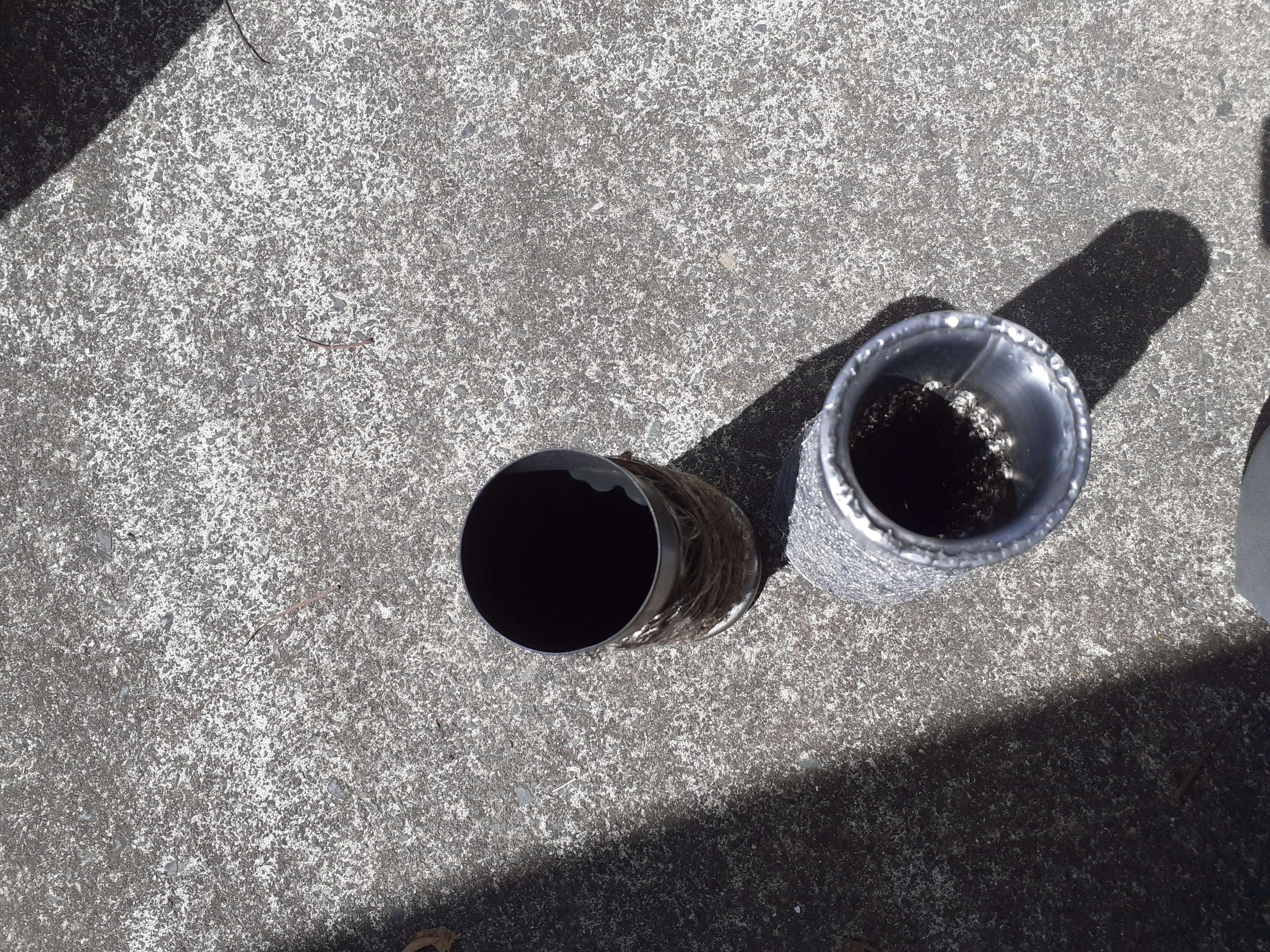

Made a new insert for the muffler, went down to a 2" pipe from 2.25", and extended the tip slightly so it's not dumping into a huge tip as much Forgot to take a photo before wrapping it but imagine a 2 inch pipe with about 60 million 5mm holes in it, starting in straight uniform even spacing, but rapidly devolving into just drill the holes /nobody's ever going to see them/this sucks/ why didn't I just buy some perf tube and make this next week Wrapped in bunnings steel wool, this takes 2 boxes @$4.90 each for future reference Results are not bad, it's quieter at idle, will report back after a few kms for the packing to settle

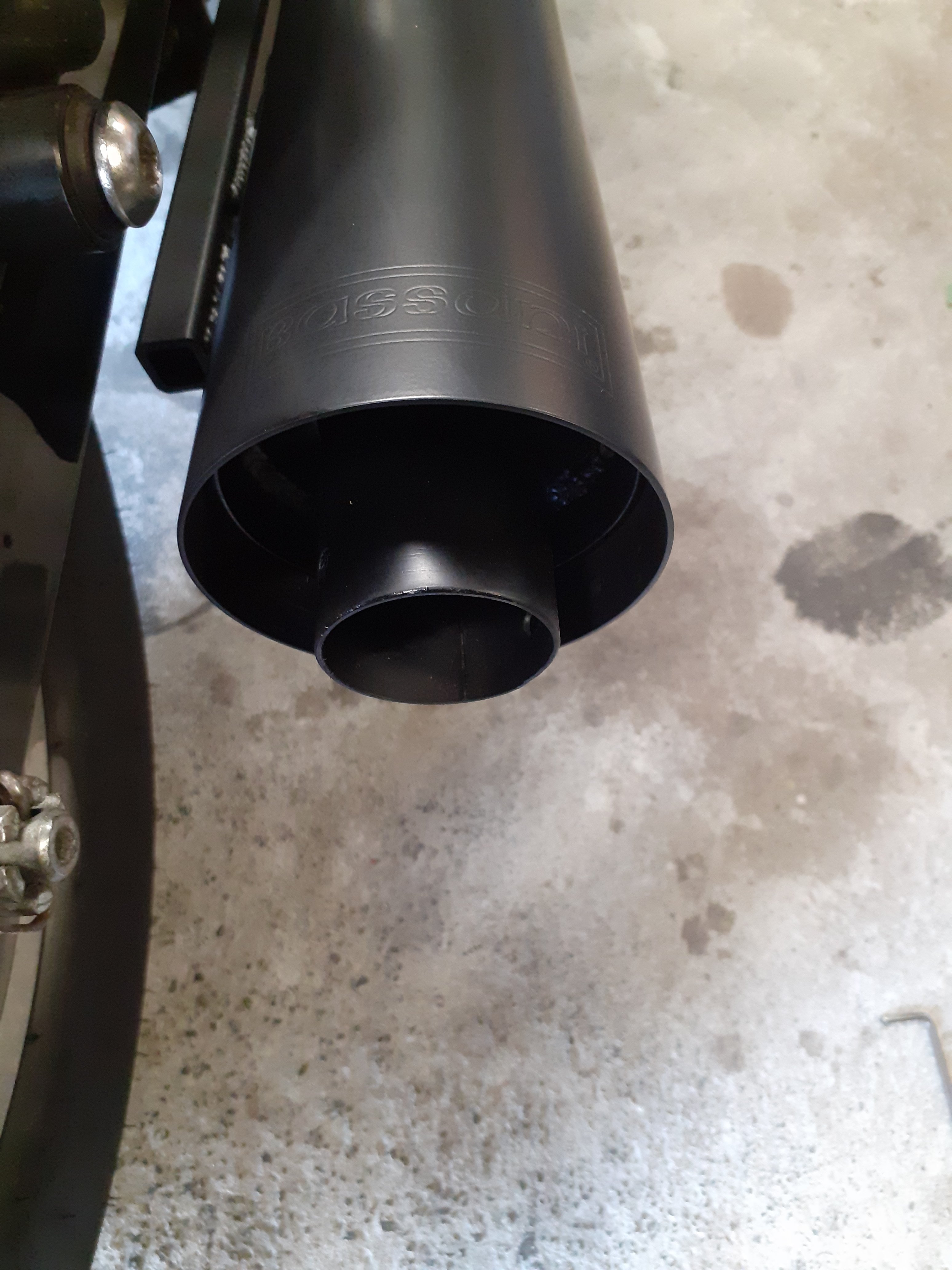

This is not very effective at muffling It's a bit much tbh Ears are not the same after a half hour ride

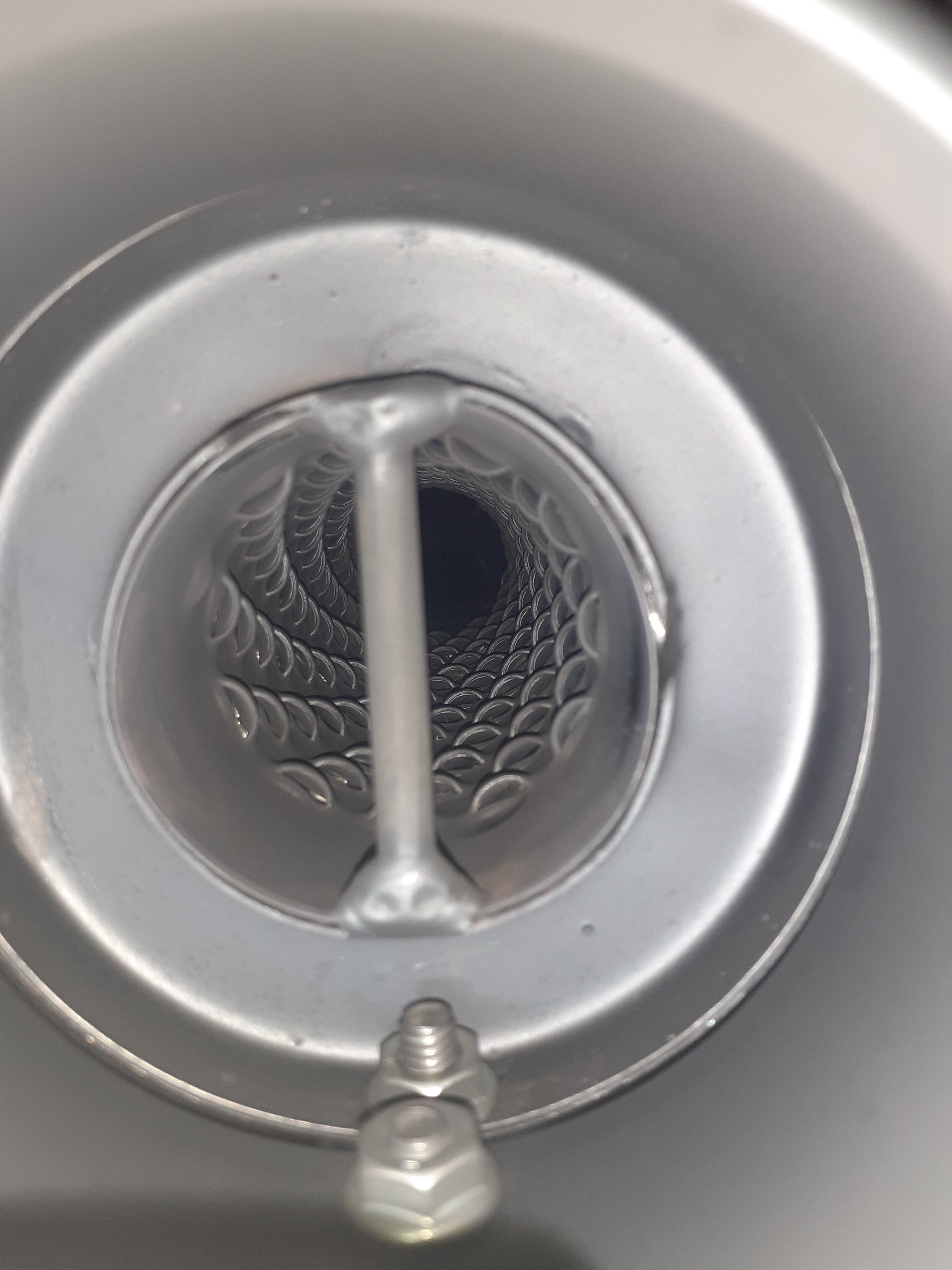

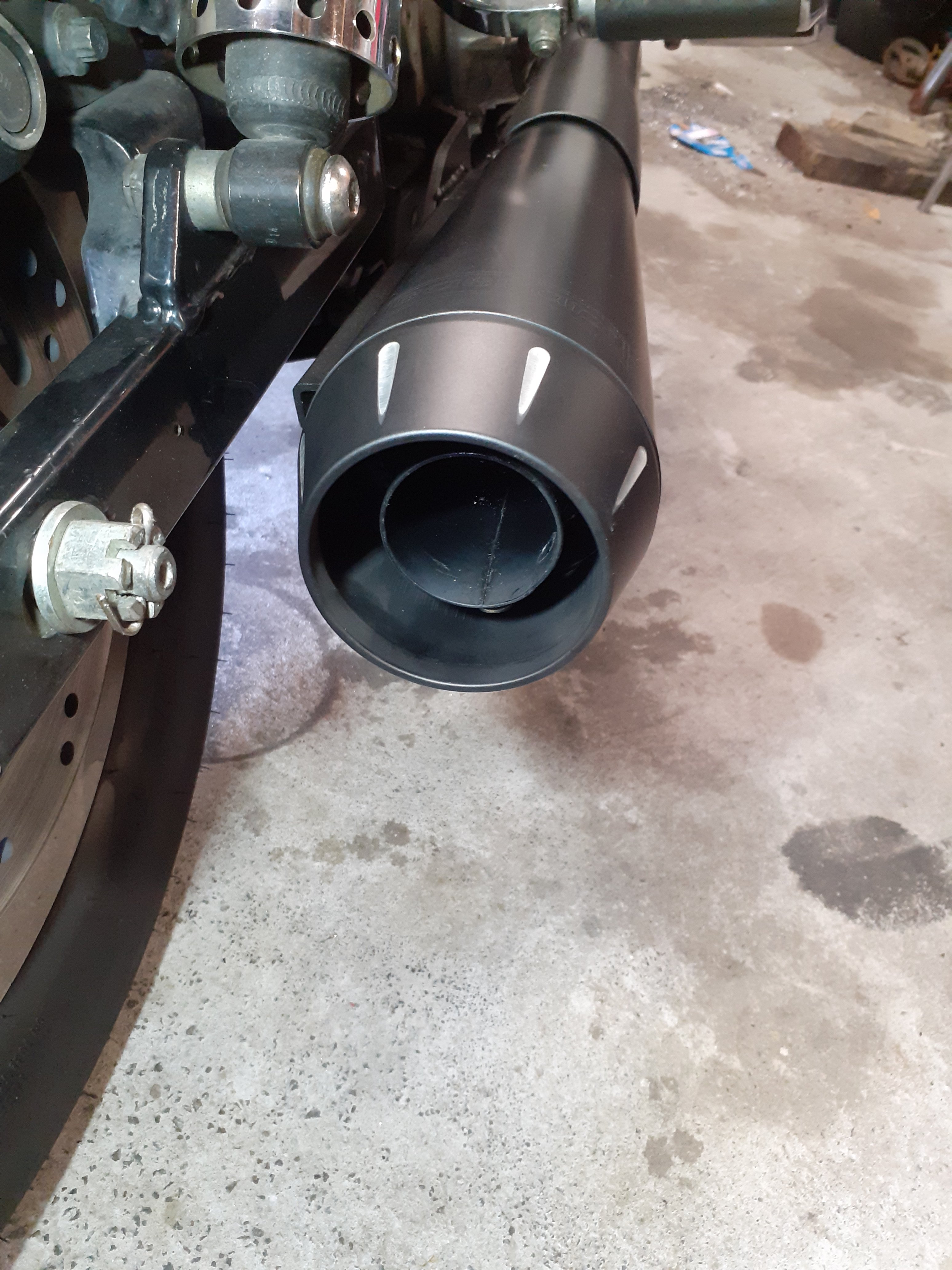

Time to release more potato noises, got a new zorst pipe While the exhaust was off I thought I'd better check the weak point on these engines, which is the cam chain tensioners, they often wear out at very low mileage, they are plastic and have quite stiff springs. There's one that's easy to get to and another that's a bit more work, pushrods, rockers, lifters and cams all have to come out When they fail they break up and go in the oil pump and carnage ensues Easy to check, just take stuff off, cam cover off, look These are worn enough to need replacement so I'll do that soon, that would be an opportunity to do cams at the same time , and there's a few options on upgraded tensioner systems etc depending how many dollars you want to spend, there's a kit to convert to later model twin cam style hydraulic tensioners Anyway, bolted the exhaust on, I guess if it was a v rod I'd be finished here Put the muffler on and started it, goodness me it's a bit rowdy, looks like they put the louvers in the muffler the wrong way around to make it noisy, I'll see what it's like but I'll probably make a more quiet insert Also the heat shield doesn't fit at the front , there's not enough room between the front pipe and the frame , might need a trim, or a spacer under the front engine mount might do it
