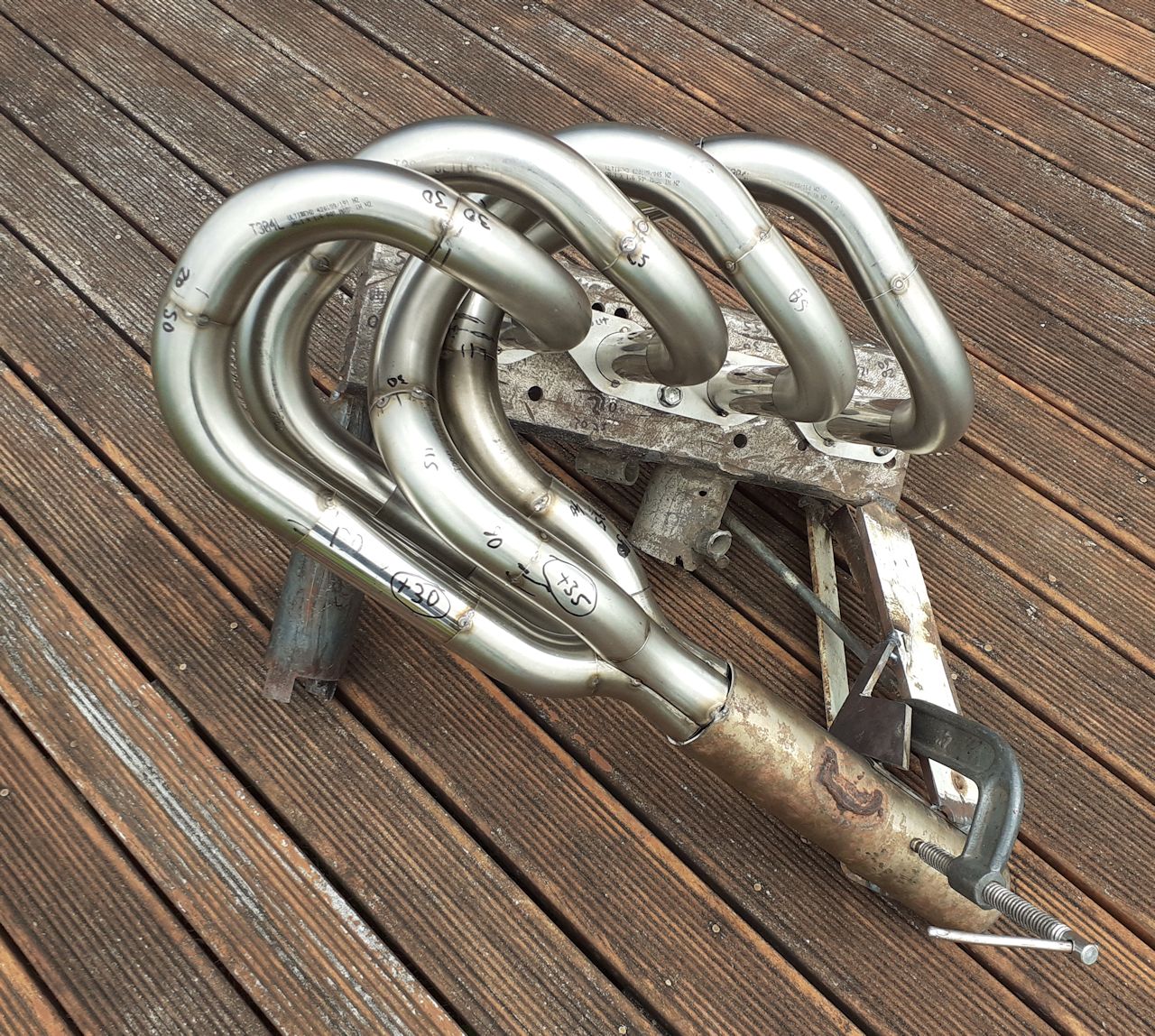

  19. Long time no update. Wanted to try some stuff with the extractors, decided would be better off to make another set that will bolt in same place rather than mod current ones. made these pipes which have a very small taper down so can run a stepped section. port too big to run straight pipe. made a collector. idea was to try cut down the big open space where the 4 pipes connect. this is about how they will go. awaiting the flange and will need a few tweaks here and there. but all pipes are within 10mm of each other as it sits. other than the work in progress number 4
