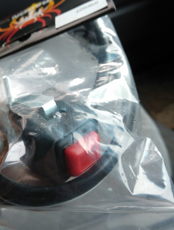

Got it legal today Found a kill switch that looked about right to use as a starter button Got almost all the wiring done and mounted the huge aftermarket CDI Still need the make a mount for the dash and wire it in, but I've clearly got most of it right so far lol- 250 replies

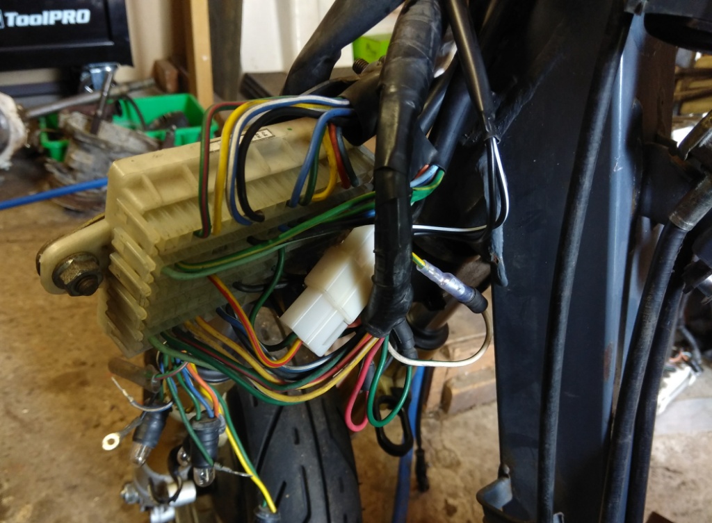

Busy day today, nearly completely stripped the new Gyro Hit it and my very grimy Canopy engine with a LOT of degreaser Added a steering stop for the Dio forks Yeah the weld is rough as fuck, got a bit tight with 2 pairs of vice grips holding it in place and the breeze blowing the argon didn't help much either! Went to work for a few hours, then fitted the swingarm then engine Got distracted and rebuilt the front shocks Routed the cables, did most of the engine end wiring, chucked a random Suzuki wheel at the front and it is almost ready to go!! Little bit of wiring, mounts needs to be made for the dash and speed sensor and a few other jobs to go. Should be able to squeeze a kill button in there to use as a starter! Realized the new ignition I got from Honda in Japan is for a new DC ignition model, so while it would work fine to turn on my ignition it wouldn't kill the engine when turned off haha, wiring from an old ignition swapped on -
Good idea with the led indicators, as long as you're running them on a DC circuit.
Nice looking switchgear! I'm dealing with tiny gauge wires on switches too, I think I'm just going to add relays to everything as I really don't want to run headlights etc through them.

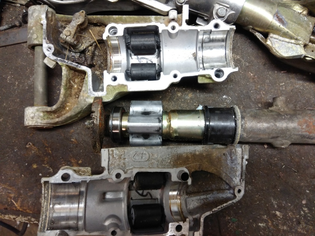

The epic GC @64vauxhall seemed offended seeing the grotty grey seat anywhere near his shop, was amazing watching the master at work! My build is now going to be done using this new frame, there's enough benefit from using the later spec frame to justify moving all the new bits from the early one! Went to tidy up the shed this evening and got distracted by swingarms, the Gyro X use a cradle to hold the bottom of the engine where as the Gyro Canopys use a pair of plates to hold the engine on, I prefer the Canopy style for a few reasons. The new X came with a semi polished swingarm and I had a nasty looking Canopy one kicking about from the haul of Canopy parts @MopedNZ picked up ages ago. Notice the mounts? Split open the Canopy one first, the black rubbers there act as springs and are what allow the front to pivot when cornering etc. The X one was like new inside so I swapped all it's parts onto the Canopy shaft after giving it a lick of paint Ready to hang under the new frame And got the engine ready to pull out of the original Gyro, just the brake cables and 2 bolts to go Sheds no cleaner at all, but at least there's progress haha -

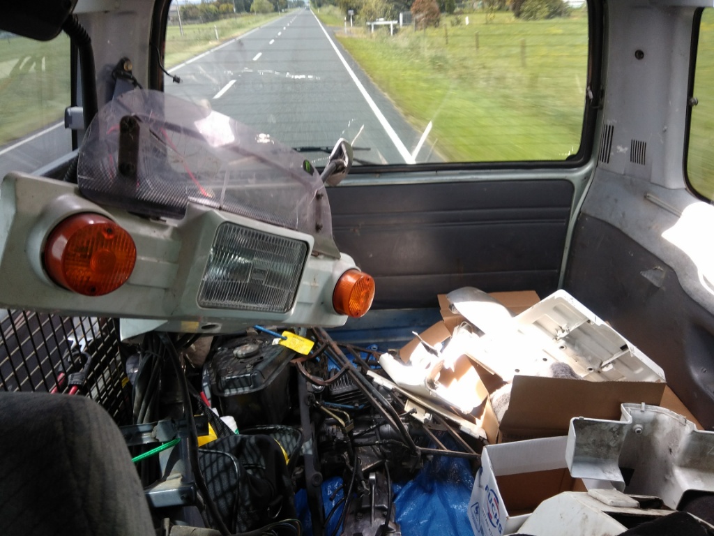

After a 21 hour round trip to Tauranga and back via Hamilton, Raglan, Hamilton, Taupo, Napier etc I've got the 2nd Gyro home. It's still an early model with 3 stud rear rims and narrow track, but the 10" front wheel suggests it's a bit later model than my 83. Few cracks in the fibreglass to patch up, screen hopefully will come up ok with a decent plastic polish. Will pull it out of the van later in the morning and see if I can get it running. -

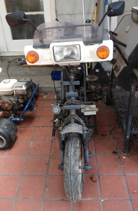

From what I can tell from the pics, the new one is the same early model (82-84) Gyro X as my original, but it's had pretty much all of the factory body panels replaced with that aftermarket Canopy kit. Courier just dropped this off Now I can start making some progress again! -
