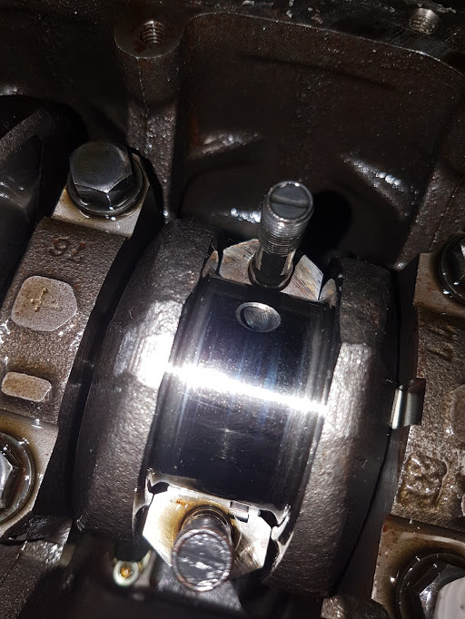

A bit of further investigation shows no signs of stress on the underside or the valvetrain. This chunk obviously decided it'd had enough... But it's hard to know why. Also had this massive box arrive from Amazon: Which contained my new muffler. It's no wonder their shipping was so expensive! I chose this because it's 3". But also because my neighbour has the same on his K24A DC5 Integra and it sounds great. I've also got the matching 3" resonator that I'll probably make removable so it can be added if the car's too loud at Pukekohe etc.
Pulled the head off and will send the bottom end to the rebuilders this week. And I noticed this very strange bit of damage while inspecting the head: I have no idea how this would have happened, but there's a substantial piece missing from the face of the bucket. There's no signs of damage on any other buckets either. The cam appears to be fine aside from a small wear pattern visible in the above picture. I'll get a DTI onto it to make sure the cam is straight and will replace the bucket. Has anyone else ever seen this?

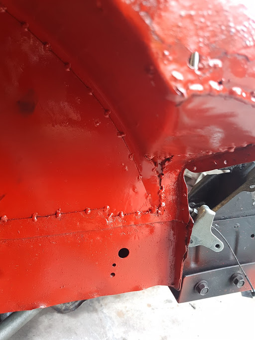

Back to those bad decisions... I don't really want to share these photos, but am going post them for the sake of good record keeping. I did all this with maximum haste and minimum care and it shows. First up, half assed tub job. From what I remember, I left the paint on for most of these welds. I also did the tubs and "wedge" sections before the front rad support panel was removed, so it was hard to get in there.... But never cleaned up the welds after removing the slam panel. Started by attacking them with a flap wheel to get rid of all the super high spots. I'm going to clean all the welds up as much as possible and will re-weld some parts. There will be grinding.... And welding.... And cleaning.... And filler. The inside is just as bad: Like, what the actual fuck 23 year old Markku? You didn't even cut the bottom edge straight! Oh well, just weld'er'up anyway I guess!?!?! Firewall - not finished and the welding at the back needs to be taken away and shot. Firewall notch to get the coil pack out - this was done at the track or on the dyno when we realised that the coil hit the seam: Started by cleaning up the edges and will weld parts of the seam: Next issue - engine mounts. The original idea consisted of pancaking a piece of Urethane between the engine mount and the pedestal with a bolt going through. In other words, it was basically solid mounted... Until the bolts snapped from the torque, vibrations and bumps. This was the situation when I removed the engine: On top of that, 3 out of 4 of my gearbox mount bolts had disappeared! So the engine and box would have been flubbering around like a kitty on crack. The best solution is a set of Land Rover engine mounts as seen in @DAD's KP build thread. These are 10mm taller than what I had before (26mm vs 36mm), but I've got another solution in the works to get the height right. Old: New: I'll also need to re-set a captured nut into the pedestal. I'm currently trying to decide on the strongest way to do this... The pedestals are welded onto the crossmember, so the only way in is from the top... I can either drill a big hole and weld a flange nut in there from above OR drill a bigger hole and weld an extra plate on top of the pedestal with a nut welded from underneath. I'm open to ideas - what have you got? So I'm taking the run bearing as a blessing after seeing the sum total of issues that need to be sorted. I'll be spending the next few months getting this right and am taking ti as an opportunity to learn some new skills and will take my time to get it looking good. Luckily I work for a company that sells flap wheels, grinding discs and linishing belts! Here's a pic of @nothingsfree's engine bay for inspiration:

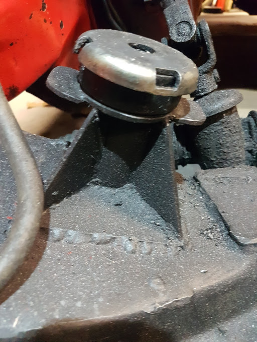

Nice. That's what I was going to use for my beams conversion but we couldn't find them. Ended up just slotting urethane in there and bolting it down, so more like a solid mount than a rubber one. Might look into these ones - cheers! -
Brawr's 1984 KP61 Toyota Starlet Sprint - Discussion
Truenotch replied to DAD's topic in Project Discussion
I've heard about those Rangey engine mounts before but didn't find them last time I looked. They look sweet. What's the thread size, how tall is the rubber and how rigid are they? -
