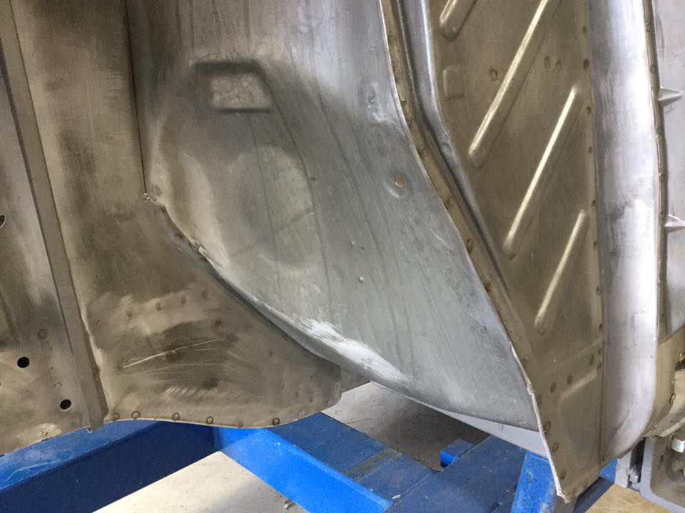

Starting to get the guards and front panel all ready for the final fit off and welding. Good to see a grille on the front again! I have sourced a NOS rear light panel so that should turn up in a couple of weeks and the last bit of the puzzle is the lower rear valence which is proving pretty elusive.

Another update. Front end pretty well done. Next job is to remove both rear quarters to make sure all clean and then sort the rear tail light panel. If anyone has a NOS one or an excellent panel let me know.
