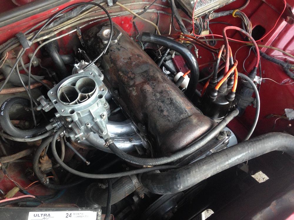

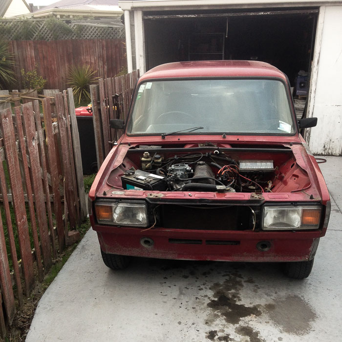

Had a package turn up from Azzurro containing the shell and internal goodies of a weber dhs carb, from this I hope to sort out the horrible idle i've been putting up with from blocking off the idle circuit due to the above broken idle mixture screw, and that the shaft is terribly flogged out on my carb! The body he supplied had stripped threads on the accelerator pump but I saved that by finding some longer screws to reach what little thread is left and opened up the worst hole from M4 to M5 to hold the whole lot together. With a good clean its all back together and for the first time since removing the twin carb set up I have a steady idle, i've only managed a quick drive around the block but everything feels fine and she settles to a nice 800rpm idle quite comfortably. As i've been using the 2105's idle screw to block the idle circuit in the niva, it was duly reunited and I had the joy of two magnificent pieces of russian engineering purring away in the driveway.

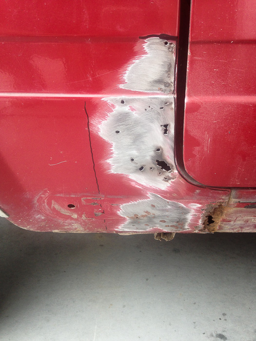

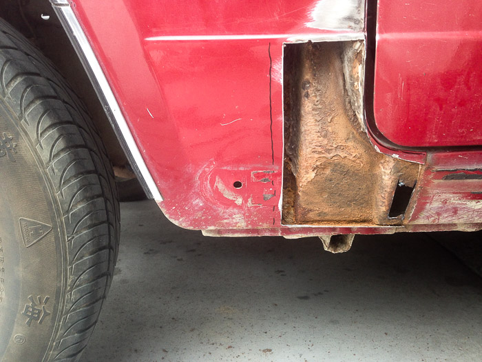

Finally got the balls today to look at the rust on the front gaurd, dug deep with the grinder and was greeted by lots of dust but not as much rot as I was expecting, what looked like really bad scale was just flaky underseal, ripped that off with the wire wheel and found okish steel underneath, will rust treat the lot and spray some new underseal in there before the patch goes on over the top. Before: After: The small hole on the sill had me worried but it still seems to be full thickness, we'll see what happens when the patch goes in! But on the brightside, I've been for a quick drive up the road and back, she's only a few welds away from a date with the wof man Nice oil stain forming on the drive from the niva, almost enough excuse to buy a waterblaster

Sad day for the Niva, with the dellortos not quite how i'd like them and running a little rich (expensive!) I made the call to swap them out for the standard carb because I have so little time and don't want to inflict any further damage if things arn't right. Only took 1/2 an hour to inflict so much pain, the test drive was rather quiet and boring, its either down on low range torque or induction noise = torque, either way sad, boo! anyway, reason to kill the original carb is because its stuffed, freeplay in the shafts, wear around the butterflies that won't seal and worse of all the idle mixture screw is poked, if anyone has a spare i'd love to talk, even better a servicable weber dhs 34 or derivitive? will throw up a wtb to for good measure! Any takers?

The engine is now all back together including the original fuel pump While putting the carb back together I had a few bits left over in the rebuild kit, few I knew and wasn't worried about but one little jet had me stumped, noticing a threaded hole on the side with no screw I dug out another carb and attached to the other side of a small brass screw was the random jet, referring to the workshop manual it turns out its for the idle circuit, further explains the reluctance to start! With everything back together and a fresh charged battery in the hole I primed the carb (so cool having a primer lever!) and turned the key, first pop and away, I've had her up to temp and everything seems happy only when I decided I needed a drive I ran out of gas, so hopefully this weekend I'll top her up and go for a sneaky drive. Just need to sort some rust and put the interior back together and she'll be ready for a date with the wof man. I've also cleaned the block and engine bay of most of the muck, I planned to paint the rocker cover but its got a cool rust/paint/patina look so I'm just gunna leave it, with new gaskets all round it shouldn't leak too much oil, also replaced the heater hoses, now waiting for the heater tap to leak all over the interior....
