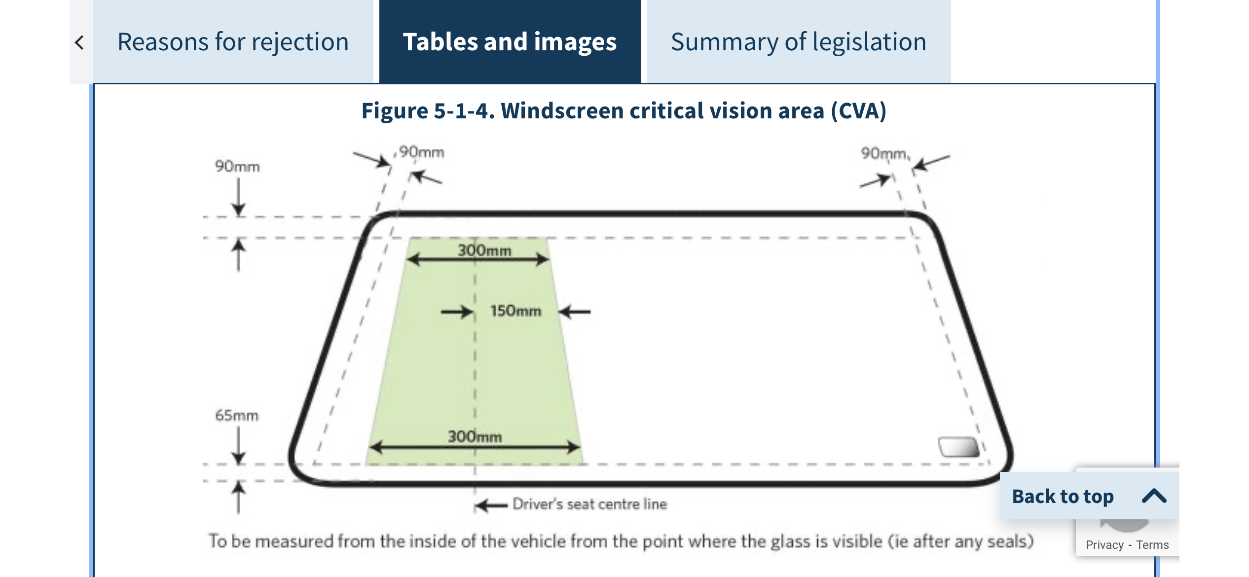

Obscuring visibility out of windscreen, what are the WOF requirements.
AllTorque replied to flyingbrick's topic in Tech Talk
“6. A windscreen and front side windows must be clean and free of obstruction to ensure the driver has sufficient vision through the glazing to operate the vehicle safely.“ https://vehicleinspection.nzta.govt.nz/virms/in-service-wof-and-cof/general/vision/glazing#tab3 it’s probably OK for a WOF, as it is outside the “Critical Vision Area”. End of the day it’s up to you as the driver. In saying that. If there was a sticker on the windscreen where that screen is it would fail. I fail WOFs weekly where muppets have a phone holder stuck to the windscreen in front of their face. Have a look at the screens in front of taxi drivers and they pass COF. -
