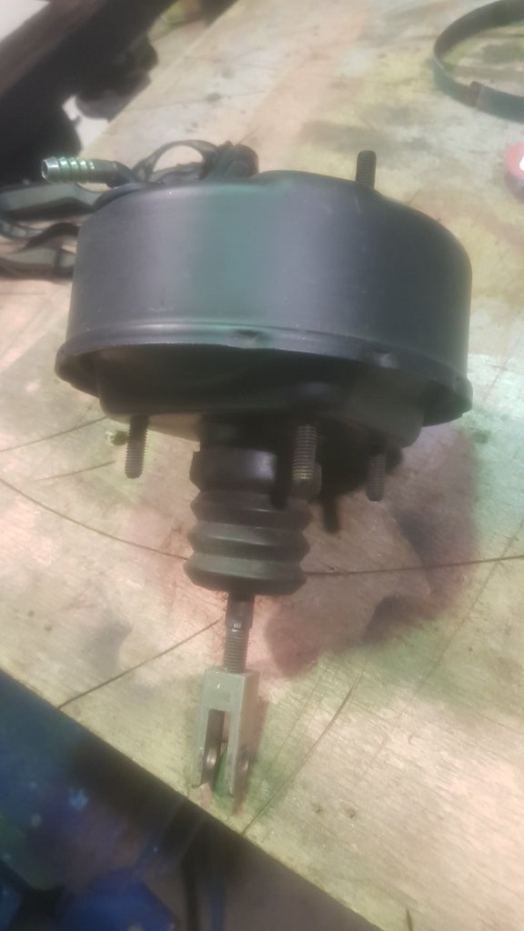

vk327 Posted August 25, 2024 Posted August 25, 2024 I've seen van master/boosters used a few times where space is an issue , hiace or L300(pic), gets the whole assembly out of the engine bay, could be an option to give dual circuit boosted 4 Quote
Stoff Posted August 26, 2024 Author Posted August 26, 2024 Is this still actuated by the pedal? It wouldn't fit it under the dash, so I'd need to build a linkage to wherever it's mounted. If I was going to run a second booster I coul fit it under the deck which might be simpler. Quote

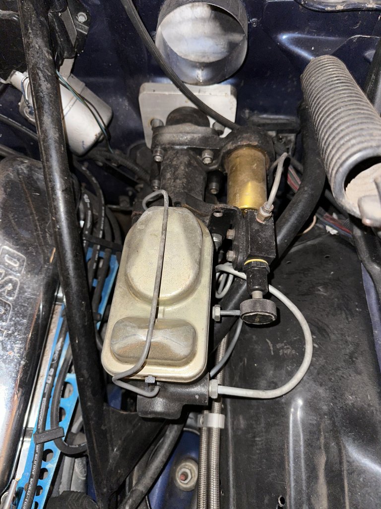

Tiger Tamer Posted August 26, 2024 Posted August 26, 2024 Would something like this work for you Chase Bays Dual Piston Brake Booster Delete with Bolt-On 6:1 Pedal Rat — Speed Science I have used a hydraboost on a car before but I don't think it will take up much less space than a vacuum booster. I had a look at what guys use for the Sunbeam Tiger as well. They are a boosted single circuit system. They can fit a dual MC in the LHD cars but they seem to just boost the fronts when they do go dual circuit. 1 Quote

Tiger Tamer Posted August 26, 2024 Posted August 26, 2024 21 minutes ago, Stoff said: Yea, just wondering if boosting the fronts only is a feasible option, or will it result in my rears not doing much... Hydro boost unit looks smaller, could work. I hope I have not caused confusion. The link I provided is not a hydro boost. The hydro boost I fitted was on a Firebird. Photo attached . Quote

vk327 Posted August 26, 2024 Posted August 26, 2024 19 hours ago, Stoff said: Is this still actuated by the pedal? It wouldn't fit it under the dash, so I'd need to build a linkage to wherever it's mounted. If I was going to run a second booster I coul fit it under the deck which might be simpler. have seen an l300 setup under dash of a mk2 escort , yeah pedal throw acts to push backwards on the booster instead of forwards, another way is to engineer a bracket with a bellcrank mechanisim and have booster sideways under dash like these https://www.rrs-online.com.au/under-dash-booster-kits Quote

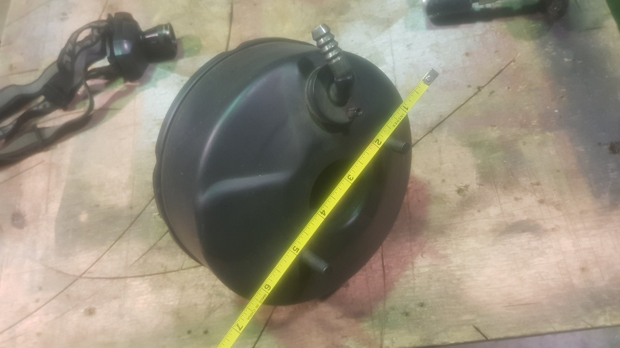

RXFORD Posted August 27, 2024 Posted August 27, 2024 Whats the actual issue? You said you can't fit a booster between firewall and m/c? Is that because it would hit wheel tubs or something or would the booster diam be an issue and hit the engine? If its a booster diam vs engine issue, a way I have often got around this on minitrucks with air suspension or engine swaps Is to use a old Mazda 121 or Ford Festiva booster. They are 6.5" diam and 3.5" deep. Common Nissan 2-bolt master cyls bolt to them so its easy to find a bore size to suit your needs. Can also orientate the vac barb fitting whichever way you want. 5 Quote
