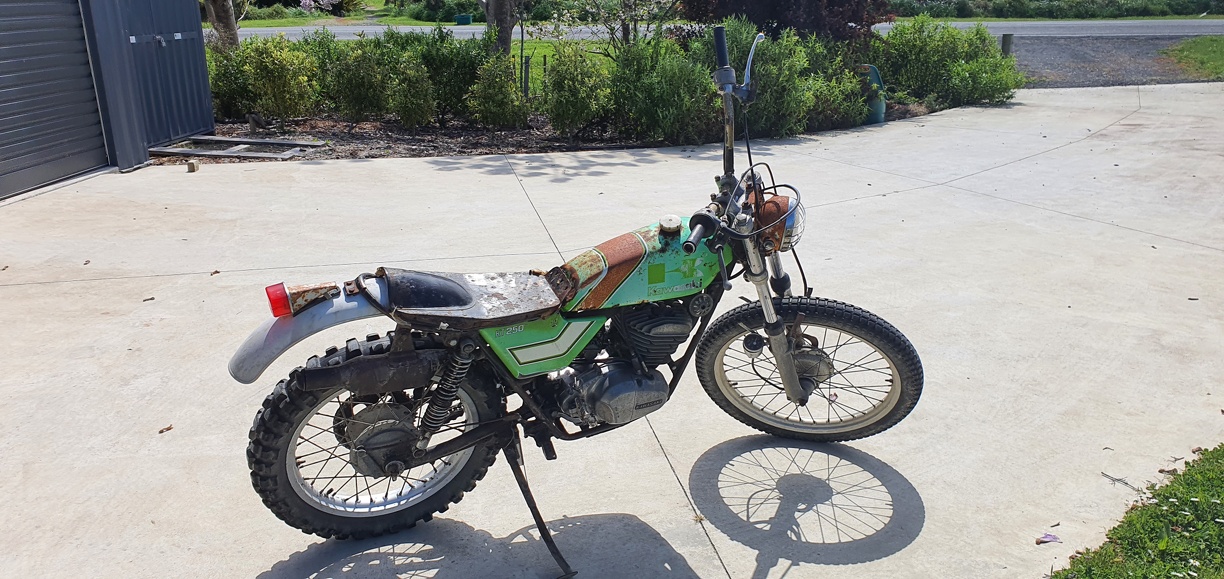

Popular Post VintageSpecial Posted October 19, 2022 Popular Post Posted October 19, 2022 Hi all, it was mentioned I should start a thread on my KT250 project. I don't really need another project as I am still building my Riley Brooklands car but a bike has been on my mind for a while since 1. I am running out of room for cars, 2. I don't want to do another car since the process of getting them on the road is getting harder all the time, 3. as my taste in cars keeps getting older the next one would have to be a bloody London to Brighton car and 4. getting all your parts from overseas is starting to get very expensive. So I considered some kind of vintage bike type project. Something for me to learn about bikes, something to learn to ride on and someone to just put about the garden and neighbours fields on. I don't really want to ride on the roads, it's dangerous enough in low slung 30s sports cars I find. Talking to a friend who has some knowledge of such things (and owns bikes) he said vintage bikes aren't ideal for various reasons and not that great to ride. He suggested a classis trials bike like a Montesa, Bultaco or Ossa. Those are expensive and hard to find and you still have that 'parts from overseas' issue. On TradeMe I saw a book about Trials riding by Don Smith and bought that just to learn more about it. I ended up chatting to the seller about such things as he sold other parts for bikes and asked him if I was looking for an old bike where is the best place to look other than TradeMe and Beaded Wheels. He more or less said 'have I got a deal for you' and you can guess what happened next. So now I own a 76 (I think) KT 250 Kawasaki. It's a project but it is mostly all there and original but a lot needs doing. It came with some parts and manuals and more parts should be coming too. Has 4000 something on the speedo (which is in miles). I wrote about it in the bike appreciation thread but basically I checked it over, tested spark and compression and so on and that the oiler seems intact and working and got it started. That was actually easy, took 3 kicks! The clutch was clutch but following some advice in that thread I worked on unsticking that by rocking the bike back and forth in gear and once it felt like there was some slipping there I started it up and chucked it into gear. That worked and I was able to ride around the garden in first. I think I did manage to find 2nd once but as a new rider I am just getting the hang of things and am still working on the likes of not falling off and not over doing the throttle at the moment. Plans so far, putt-putt about to get the hang of it then eventually strip it all down, learn how it works and rebuild it nicely I guess. But for now I am busy making the ash timber frame for the car then the aluminium skin so am not sure when this will happen. It gives me time to find parts and things I need, a lot of which are available locally which is one reason I went for this bike. From what I understand it wasn't a great trials bike in the day. Or rather others did better. But they were good farm bikes making them popular here. Here are some as delivered pics. Simon 16 Quote
VintageSpecial Posted October 24, 2022 Author Posted October 24, 2022 OK, here's a stupid 'this idiot knows nothing about bikes' question. Are bike boots flat on the bottom? I've been putting about on the bike getting the feel of it. I think I have hit all gears now but find it hard to tell at my slow speeds! But I find changing gear tricky because the boots I wear (steel cap work boots) have a heel and the heel catches on the peg and I can't get my toe under the gear shifter. Are the heels shorter? Maybe I just have tiny feet! I've cleaned it several times now, with a water blaster and degreased and most of the mud has gone but it's still pretty filthy. I don't think it had been cleaned in ages. I checked the automatic oiler today as per the manual and that's all fine. I was a little worried it wasn't working but it is all good. What oil should go in the chain oiler? Also when it comes to restoring time what do people do with rusty front forks? I hear it is possible to get them re-chromed? Is there a recommended place? I put an update on my YouTube channel. A little about the car. Was working on the timber frame but ran the bandsaw blade into a screw which killed it so I did some on the bike instead while I wait for a new one to arrive. https://www.youtube.com/watch?v=PvFvn5zCyQs Simon Quote

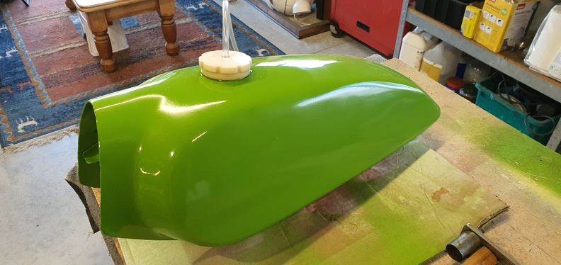

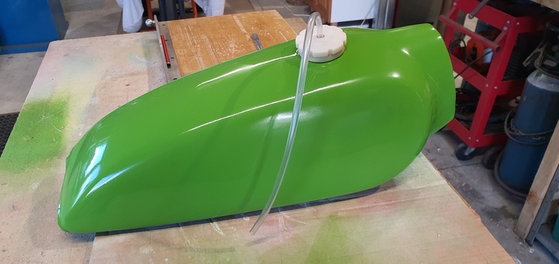

Popular Post VintageSpecial Posted December 19, 2022 Author Popular Post Posted December 19, 2022 I finished the tank. Well, as much as I want to do. Much hammering, a healthy layer of filler and some cheap green paint and I have this now. It's usable. Am waiting for a bunch more parts to arrive then I should probably strip and rebuild the whole bike. I have a new chain, new sprockets should be arriving, brakes are on order as are new fork wipers. The lights have been repaired and repainted. I don't think I will touch the engine, it runs well and has good compression. The throttle and levers are pretty worn so I need to see about restoring them. I know people do fit other throttles to them so maybe that's an option too. I did strip and clean the carb and that went well. Came us nicely and everything still runs. Simon 12 Quote
VintageSpecial Posted December 20, 2022 Author Posted December 20, 2022 Finding a suitable paint was tricky by the way. The proper way would be some kind of 2 pack I guess. But I didn't go that route and instead went with rattle can. I am not sure any spray can paint will be totally fuel proof though. The paint I used was ColourLab from Mitre 10. It seems to be new and is a NZ made paint (Damar). It sprayed on really nicely. Very quick coverage, easy to not get runs and very fast drying. Nice rich colour too (that's Kiwifruit I used). Not exactly right for a KT-250 but for a hack close enough. That finish was from the can. I haven't tried flatting and polishing it at all. Simon 4 Quote

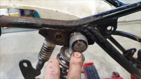

VintageSpecial Posted January 6, 2023 Author Posted January 6, 2023 I decided it was time to finally totally strip the bike. That didn't take too long. I posted about it on my YouTube (https://www.youtube.com/c/asciimation) but I am stuck on two things. The rear mudguard bolts will need cutting off which is easy enough. But I can't get the rear shocks undone. I don't know what tool you use on the odd, large cross shaped holding bolts. How do you get them undone? Is there a special tool? I don't want to mess them up. These things: Frame is in great shape except for the boogered kick stand mount on the swing arm. I have a new stand I just need a picture of how the originals looked without the stand bolted on. I can easily make the required part then weld it on. Simon 2 Quote
xsinclairx Posted January 6, 2023 Posted January 6, 2023 Could you just use a large flat head on that bolt? Quote
VintageSpecial Posted January 6, 2023 Author Posted January 6, 2023 18 minutes ago, xsinclairx said: Could you just use a large flat head on that bolt? I did try of course. But they don't seem to fit well. Large ones are thicker so won't fit the slot. Hence wondering if there is a special tool. Actually, I think the manuals I have show all the tools in the back including any special ones. Need to pop out to the shed... Quote
VintageSpecial Posted January 6, 2023 Author Posted January 6, 2023 Never mind, I got them off in the end using an old school hit it with a hammer impact driver with the biggest flat bit it had. one tap and out they came. 4 Quote
