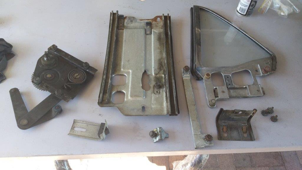

Flash Posted June 17, 2022 Author Posted June 17, 2022 Now that the dash is painted, today marks the start of the interior rebuild. I thought I'd start at the rear of the cabin and work my way forward. So first up is the refurbishment of the rear quarter windows and I picked the passenger side one as the first lady for a shave. The window winds up and down pretty smoothly, but I want to rust proof the internal rear quarter panel anyway, so figured I'd gut the insides as part of the process. The little body seals are well knackered but I've got new ones in my latest batch of parts. Looking at the window regulator and rollers they look fairly decent. The rollers are cheap as chips so I've got a fresh set to install. Apart from that everything just needs a damn good clean and a bit of new grease. Someone has butchered the plate that holds the slides for some reason, but its only a cosmetic butcher. The metal is all jagged, so I'll tidy that up while I've got it out With the panel gutted I was able to inspect the metal. The bottom of the rear quarter looks nice and solid inside. Seems to be heaps of dog hair lying in there (at least I hope its dog hair) .... so I'll get rid of that before I start squirting fish oil about the place. A few "before" photos for your viewing pleasure. Thanks for looking. 5 Quote

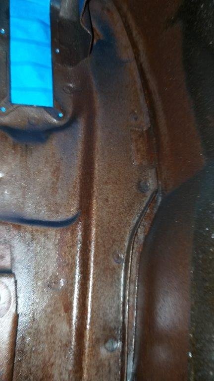

Popular Post Flash Posted June 18, 2022 Author Popular Post Posted June 18, 2022 This morning's focus was the rust proofing of the passenger side rear quarter inners. After a good few rounds of compressed air followed by vacuuming I managed to get rid of all of the loose debris. In order to limit any mess on the new paintwork I masked up the window aperture and then used a mini spray gun to slap a bit of rust converter on the bare metal. While I waited for that to go off I cracked into the fun job of cleaning years of dirt and old grease off the window winder mechanism and related window guides. Next up was a liberal coat of rust proofing that I applied using an under seal gun that I sourced earlier in the week. Hopefully that should keep the old tin worm in check for a few more years. 12 Quote

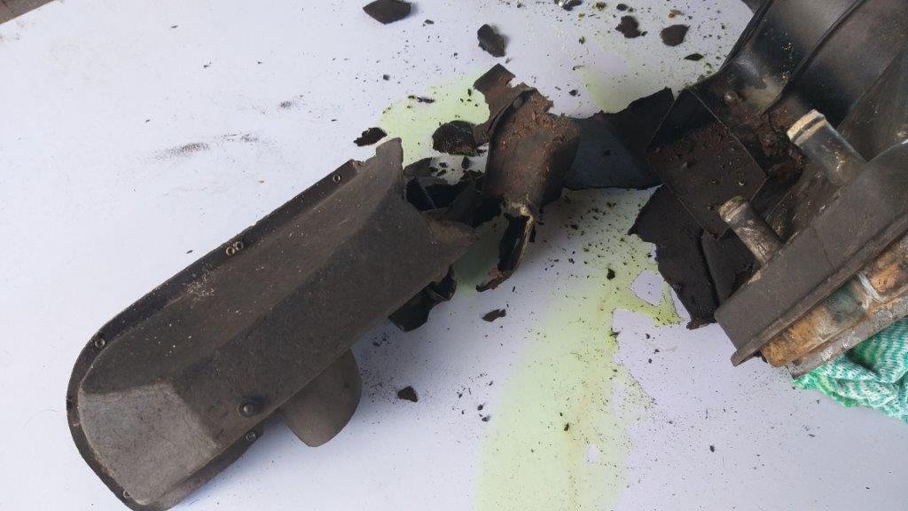

Flash Posted June 20, 2022 Author Posted June 20, 2022 I need to take a run into town to get more of the rust proofing goo to do the other rear quarter and both doors, but I was waiting for some parcels to be delivered this morning, so I decided to crack into the heater box rebuild. Pulled it apart and it was surprisingly clean inside. I've seen Youtube clips of some Mericans pulling rat's nests out of their boxes, so counted myself lucky. As previously mentioned the little plenum extension is well shagged, the internal seals have all but disintegrated and a few of the little trap doors were seized solid. Slapped a bit of WD40 on the hinges and after a teeny bit of gentle persuasion they are now opening and closing smoothly. The main housing appears to be made of some type of fibre based material so I just gave it a quick tickle with the water blaster and left it in the sun to dry. The actual heater core looks mint and there is a little yellow sticker on one of the tanks, so I suspect it is a recent replacement. The main metal trap door and housing is busy languishing in a vinegar bath and I gave the blower motor a quick rattle can reco. I'll chuck some of that rust convertor / primer combo on the metal bits before I glue in the new seals and that should take care of that. Thanks for looking. 9 Quote

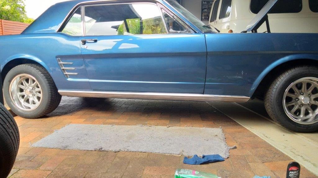

Popular Post Flash Posted June 21, 2022 Author Popular Post Posted June 21, 2022 Mama got some new shoes today. Just waiting for the knock off spinners to arrive to complete the look. I've now got heaps of fender gap so I'll be able to dial in a bit of low which will make my heart sing. Before and after shots: 18 1 Quote

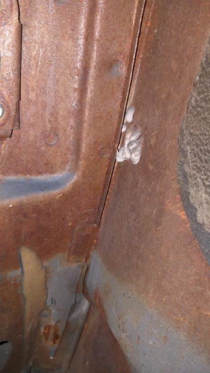

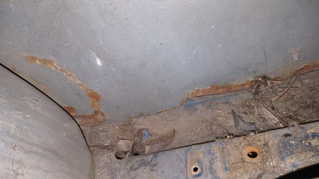

Flash Posted June 24, 2022 Author Posted June 24, 2022 Today's little mission is the last of the panel cavities being the driver's side rear quarter. I started off by stripping out the quarter window and mechanism. Again, the backing plate has been butchered and since its a tetanus shot just waiting to happen I'll tidy that up. The mechanism has seen a bit of loving in the past and has a date of 2011 scratched into the surface, so I'm guessing it was done as part of the major USA rebuild back in 2010 and 2011. The factory sheathing on the wiring harness is well shagged so I pulled that out and will give it a birthday with some cloth tape. Apart from that the metal looks pretty solid. A bit of debris including more dog hair and a little bit of surface rust at the panel joints, but nothing a good clean and a little bit of rust converter won't cure. 3 Quote

Flash Posted June 25, 2022 Author Posted June 25, 2022 And .... that's the last of the rust proofing done. Pumped two litres of goo into the driver's side rear quarter inner as well as both front chassis braces. Then spent the rest of the morning cleaning up the mess. With that mucky job behind me at least now I can get on to the good stuff, being the reassembly. 7 Quote

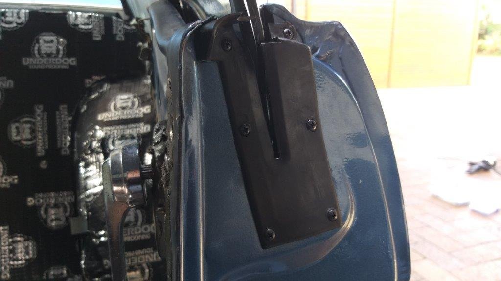

Flash Posted June 27, 2022 Author Posted June 27, 2022 Spent the morning fitting the glass and winder mechanism into the driver's door. Wow, what a difference the refurbished winder mechanism makes. Smooth as silk. Cracked out the new weather strips and door seal and fitted those too. Final step was to fit the interior door panel and related bling. And, that's the driver's door ready to rock and roll. 4 Quote

Popular Post Flash Posted July 3, 2022 Author Popular Post Posted July 3, 2022 With the Bongo languishing in the sick bay, I was able to crack into a few Mustang bits today. Finally managed to finish off the heater box rebuild and it's looking mighty good even if I say so myself. 16 Quote
