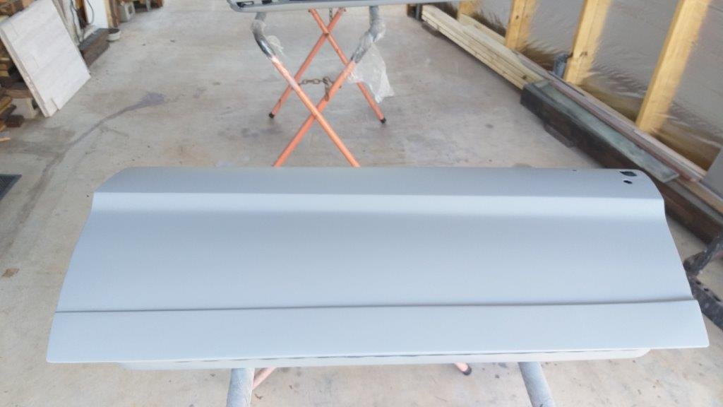

Pretty happy with the way the passenger door has turned out.
Black check coat on the first round of bog revealed some low spots.
I gave the second round of bog a few days to rest before another check coat and sand, then a quick coat of spray filler to deal with a few small air holes which I left for another few days before sanding.
Finished off with a double coat of 2K primer.
I'm using Raptor epoxy primer which seems to end up with a rippled finish straight off the gun.
Seems to smooth out fine after a slight tickle with a bit of 800 grit wet sanding though.

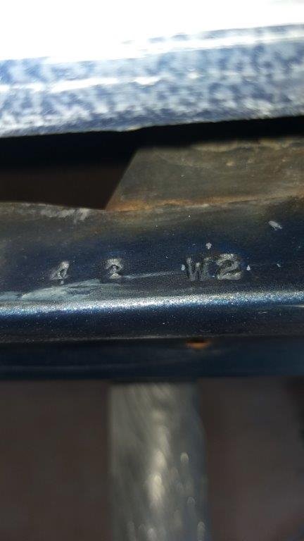

Today I made a start on the inner panels on both doors as I'll primer these first. Took the opportunity to do a bit of "door archaeology" while I was at it and discovered a few interesting facts.
The passenger door shows signs of the original factory paint under the door handle, so it looks like the lazy bastards just did a tape up job when they did the colour change back in 2010 or thereabouts.
I was also able to track down the factory door assembly stamp located inside the window channel. It reads "4 2 W2" which decodes to 2nd April weekend shift 2. Makes sense as the actual build date on the entire car was 6th April. So my conclusion is that the passenger door is probably the factory original for this vehicle.
