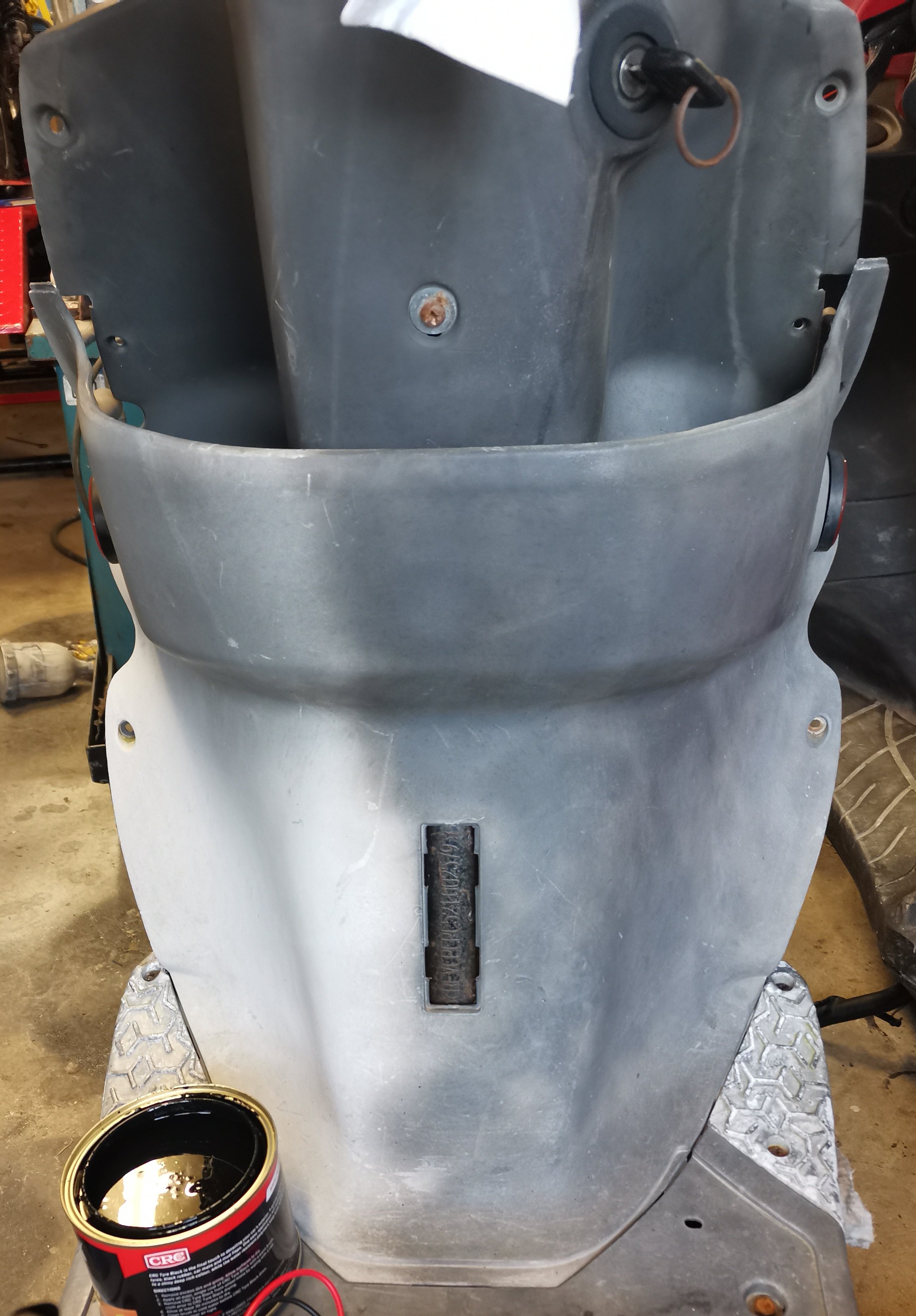

Goes on with a rag or a brush if you're rich, soaks straight in and lasts literally years. I did my starlet bumpers about 5 years ago and they still look like new. Doesn't streak or anything.
IMG_20210927_165414_edit_105010231759496.thumb.jpg.72a517fbd735f9726a7f51b196aa4d64.jpg
Will add some other photos in the sun tomorrow.
But - my experience
It smells like rotten eggs, but not once applied
Some surfaces instantly turn black. Smooth stuff like the airbox took it really well, just barely a touch on the brush was enough to bring it back to deep black
The other plastics were kind of hit and miss. Even plastics of the same kind and similar locations had slightly different results.
This bike was real bad, faded fully to white in some areas, the indicators for example. Chalky finish.
All I did was wash the bike with simple green, then brush the crc tyre black on.
Soaked right into the seat cover and looks great. The inner Fender and air box, one coat. Everything else took 2 coats for good coverage, then a third to dab into the spots that didn't want to take it.  Sometimes the additional coat would lift the previous, in little bits like sand.
Streakyness wasn't much of an issue, it seems to self level and soak in. But as I mentioned, some places did need additional coats to hide brush marks
I left it out in the sun all day,  again a bit of a mixed bag, some stuck on really well (jialing Fender is 100% soaked in and won't scratch off) some I can scratch and leave a mark. Although most of this particular bike was chalky and would do that if you touched it, so for the most part probably the substrate, although some of the less faded spots will do the same.
It can of course be touched up easily
Did the seat by dabbing with a rolled up cloth, pretty good outcome
Clean up with water, no remaining smell. Will give it a bit and then wash the bike down and see what happens
Interested to see what happens if I spray it out of an airbrush
Here's the mirrors, I did one with a map torch
Good option for some stuff, I have tried it on nissan plastic with a lower temp heat gun and it instantly took all the oil to the surface and was uncontrollable
This one with the torch, seemed more controlable, maybe its the high heat, can just waft it over and get the job done rather than heat up the part?
The arms of the mirrors started to do the same thing as the Nissan, but looking at them again the next day, don't seem to have any patchyness or heat damage
This was a 2 min job, I think it would come up better with a 2nd "coat"
