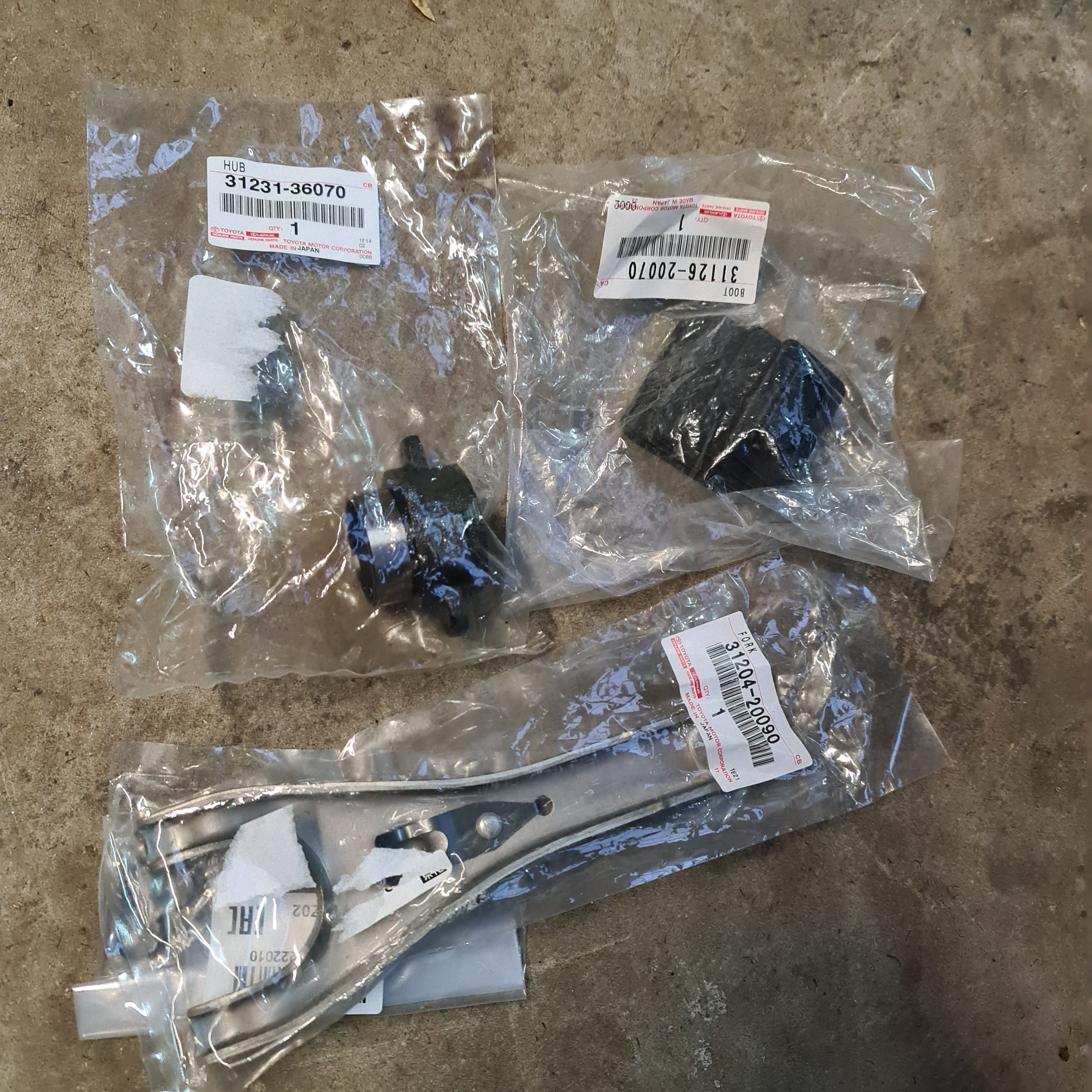

Jeffs_Emporium Posted July 10, 2021 Author Posted July 10, 2021 New genuine clutch fork, release bearing carrier with clips and rubber boot arrived. $100 including post via amayama Heavy duty ae86 clutch is on order from Japrace in Christchurch also 7 Quote

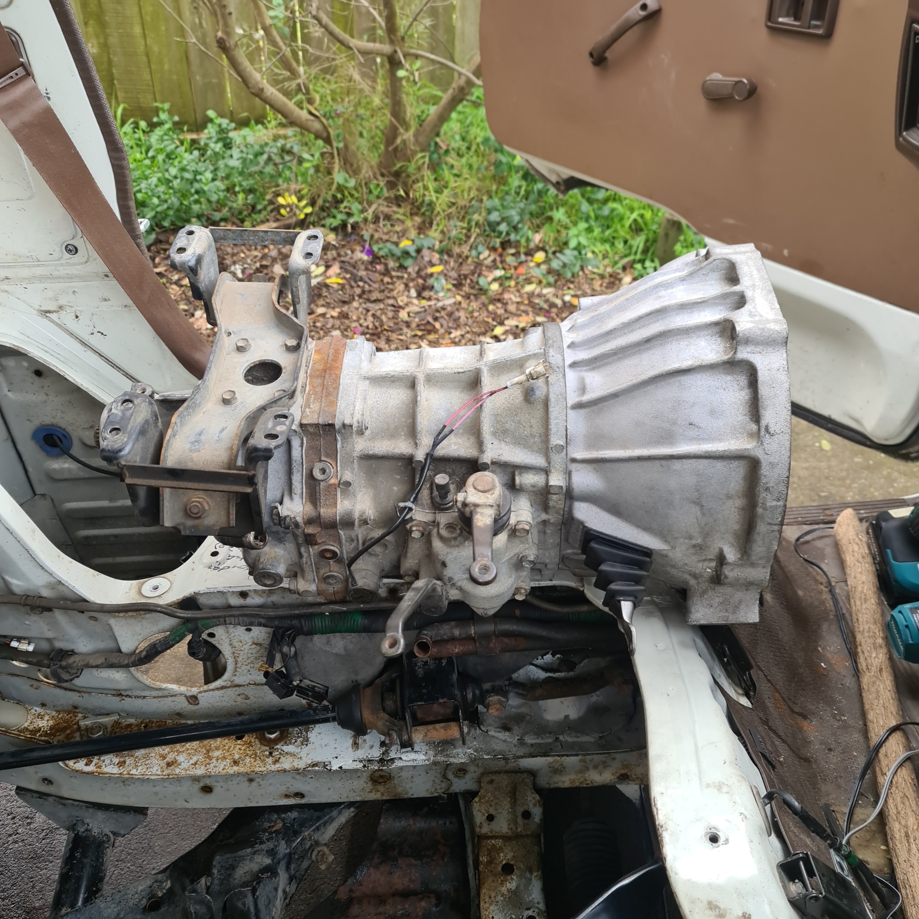

Jeffs_Emporium Posted July 10, 2021 Author Posted July 10, 2021 Have the gearbox removed. Already something isn't as its supposed to be and I'm not sure why. for starters the gearbox crossmember I took from a liteace at pickapart lines up with support members on body but two holes are missing in body, (would need to drill and weld in some crush tubes) looking at the crossmember from box I pulled from mine it would work on g52 but why is my driveshaft so short... 3 Quote

Popular Post Jeffs_Emporium Posted July 11, 2021 Author Popular Post Posted July 11, 2021 Put old crossmember on g52, soldered the old reverse switch plug on and transfered the speedo cog. put it in the hole and attached to old mounting holes and I'm in the ballpark of +/-5mm for the engine mounts lining up measuring from bellhousing face! Slid the shorter driveshaft in and measured gearbox seal shield back to diff. I need 695mm, shorter shift I have is 568mm and longer 740mm. Looking at the other gearbox crossmember it shifts the box further back but if my engine mounts line up the lesser of two evils is definitely dropping driveshaft off to get shortened than making engine mounts and needing to drill and weld crush tubes into chassis. One shifter linkage bolts straight up and other I possibly need to trim and fit a socket/tierod fitting to end. Looks easy 14 Quote
Jeffs_Emporium Posted July 11, 2021 Author Posted July 11, 2021 Had a look through some old notes and I measured a yr25 driveshaft with g52 and e series diff at 625mm earlier in the year at pickapart. Since I measured this from gearbox dust cover outer chances are that was the shaft I need 5 Quote
