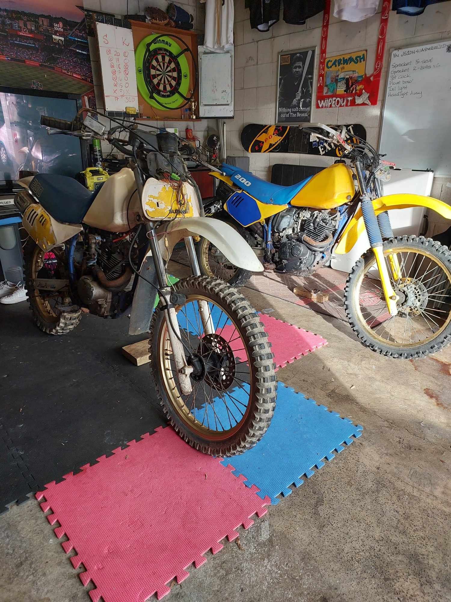

Ken Posted June 2, 2024 Posted June 2, 2024 g'day mate, really enjoyed watching your vids on the old DR, on the off chance, you wouldnt happen to have a complete wiring loom for and old DR200G 85?, i have 2 DR's currently, the G is the white model and the J is yellow, cheers man Quote
tortron Posted June 2, 2024 Author Posted June 2, 2024 I think I just have a couple of extra late model farm bike looms. There's a couple of small differences, but you could run a later loom without any major rewiring. There were a few different cdi plugs used over the years,but it may have been a road legal vs farmbike differences, and maybe the stator plugs were reversed male.and female. I have 2 complete other 80s DRs that are just about to the front of the queue to restore, so i have been guarding my parts stash tbh Quote
Ken Posted June 2, 2024 Posted June 2, 2024 cheers for the reply man, nah scratch that loom idea, im going down the route of getting the yellow girl road ready at some stage, your vids helped in that regard, the white girl ill be pillaging all the road gear from, she'll just be a farm thumper but ill get it close to original looking as i can with non functioning lights blah blah, just need to get her running, she sat for 20years, recond engine apparently, good compression, no spark, so process of elimination i suppose...wiring has been butchered, missing air box/brake caliper/. has a keihin carb, dunno whats up with that, but ill sort, only had the white one for 24hrs. Quote
tortron Posted June 2, 2024 Author Posted June 2, 2024 If you want a new loom try here https://www.mickhone.com.au/part/suzuki/3661044A20#content The keihin carb is probably a good replacement, the mikuni tm28 is kind of hard to get parts for if it needs them. You should be able to use a modern dr airbox and brake calliper. Don't see many white plastic ones, might check the frame number on that to see if it was registered. Does it have a tail light too, they are pretty hard to come by in once piece, though you can get replacement lenses I have one engine that just refuses to spark, I have swapped everything electrical on it to good parts, even swapping the loom, stator etc and nothing. Stator in an early engine is different to the later engines, I think physically different in size and I remember something being mounted inside vs outside, but been a while since I looked Quote
Ken Posted June 3, 2024 Posted June 3, 2024 sweet...thanks again mate, i do love this white one, has its tail light complete, so that will go on the yellow one, have a white headlight on order from another good ole kiwi dude, i'll score a later model airbox and caliper, they seem cheap enough, just swapped coils over, theyre both good, so i can eliminate the coil theory, mind you there's allsorts of splicing and shit that have gone on, so hopefully i'll decipher it all and get spark fingers crossed then move on to the carb, im hopeful at this stage, just in the process of grabbing the speedo and key ignition assy off the white one, hard to divide time between both bikes, you know the feeling lol. Quote
