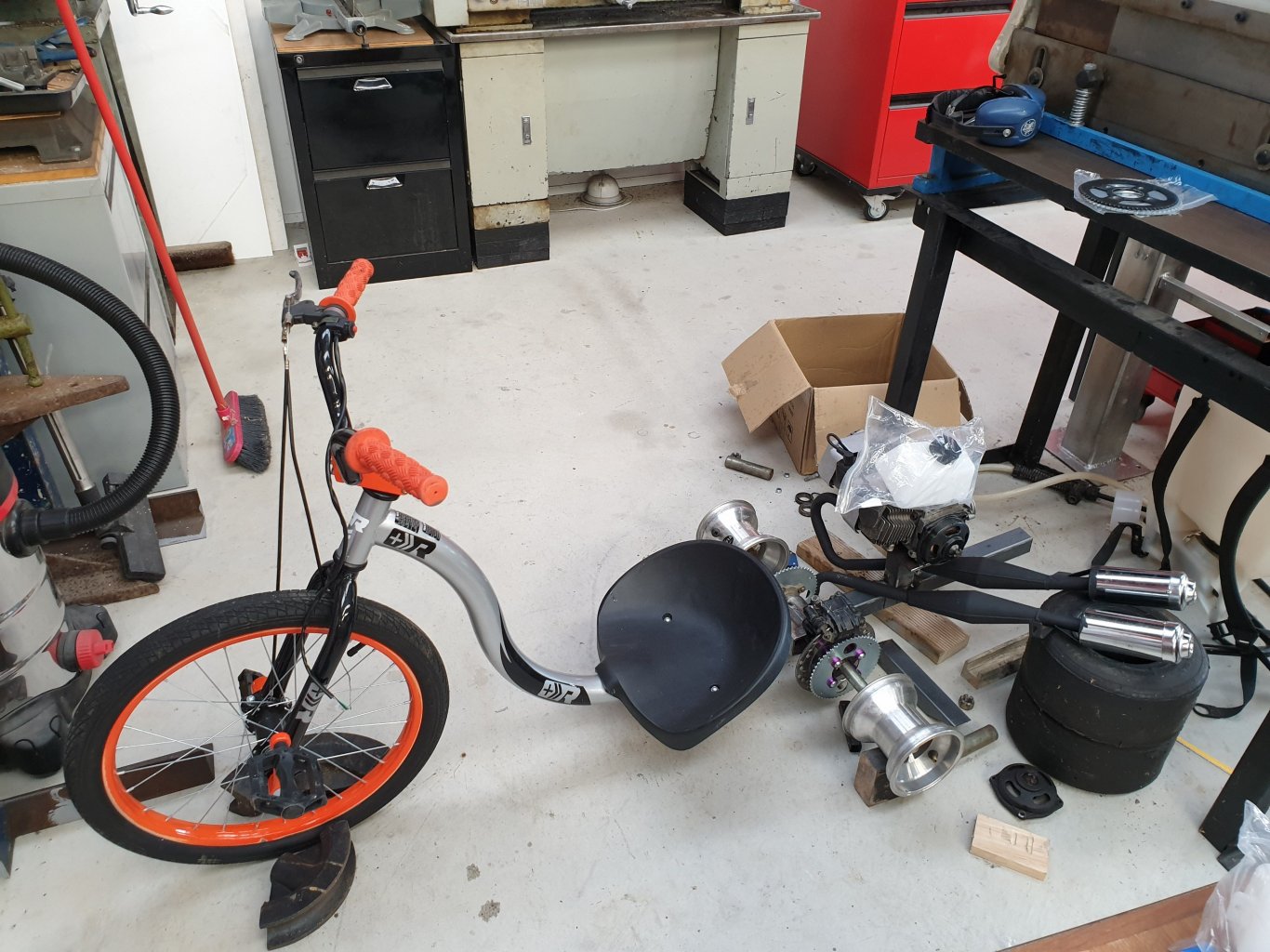

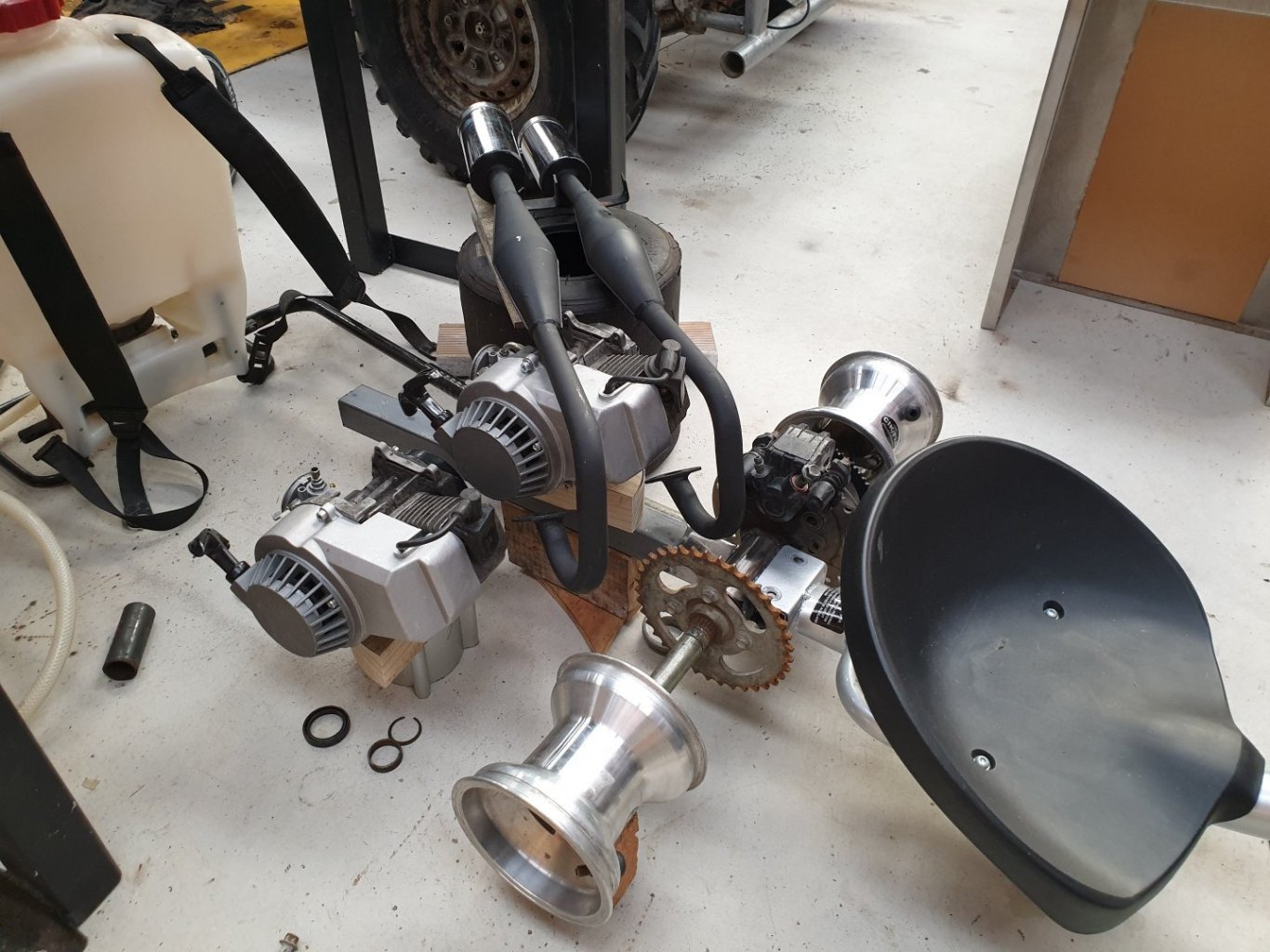

Kimjon Posted September 12, 2019 Author Share Posted September 12, 2019 Okay, some progress... Mocking it up - will look similar to this. Yes that's right...and no you don't have double vision. Yup...twin motors...fuck yeah!!! Still lots to figure out and actually do in order to turn a collection of parts on the shed floor into a working trike, but progress is progress. 4 1 Quote Link to comment Share on other sites More sharing options...

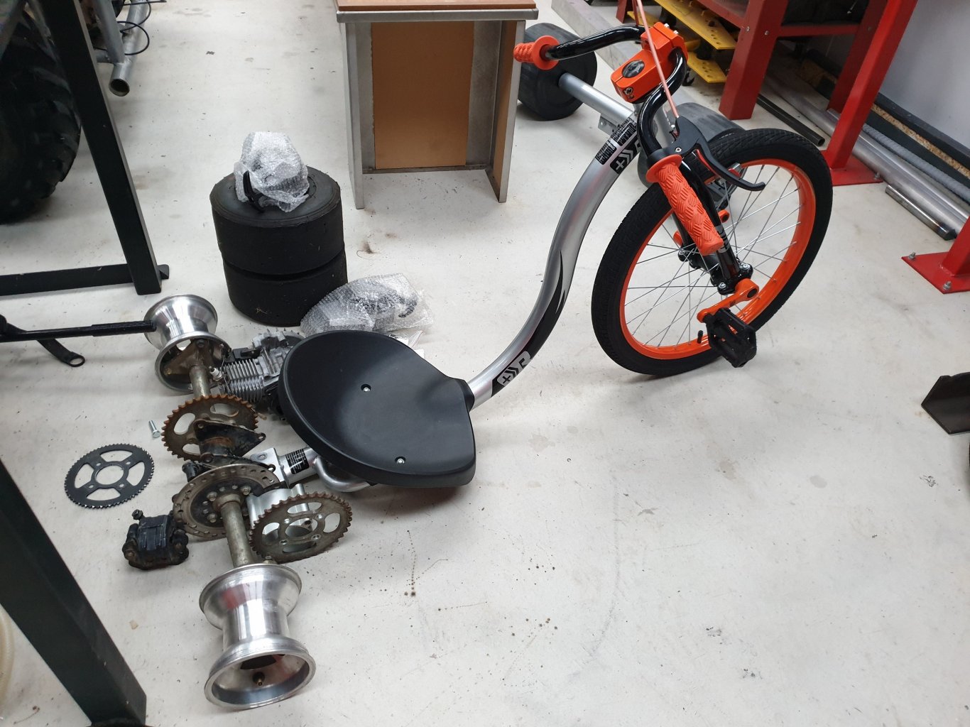

Kimjon Posted September 15, 2019 Author Share Posted September 15, 2019 Had another visualizing session, just trying to balance it out as much as possible. Also found some solutions... Boy racer spec bonnet spacers...JDM as fuck! And my throttle system to operate twin motors simultaneously... I've thrashed my Ebay account once more - buying up a storm of cheap Chinese parts. Normal 6 week delivery time. So I'll grab some steel on Monday and start welding shit together, do as much as I can in the meantime for the win! 1 Quote Link to comment Share on other sites More sharing options...

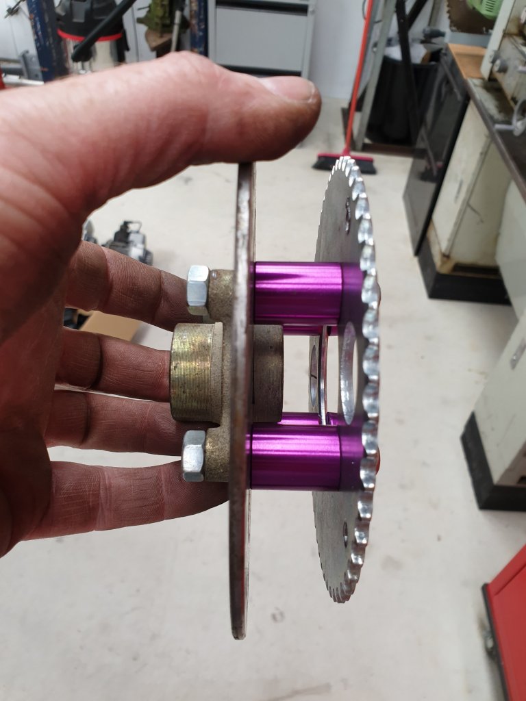

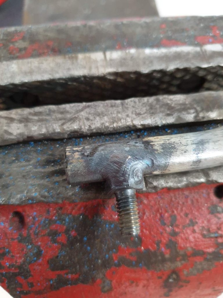

Kimjon Posted October 5, 2019 Author Share Posted October 5, 2019 Got a few things done, as the parts trickle in. made this jig up for drilling both sprockets simultaneously. The holes weren't on the same pcd, and this idea got it right on first pop! Finished "sprotar" (sprocket/brake rotar) Quote Link to comment Share on other sites More sharing options...

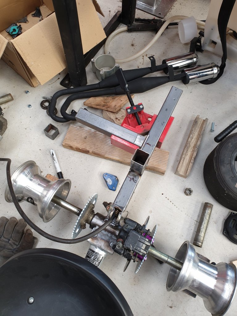

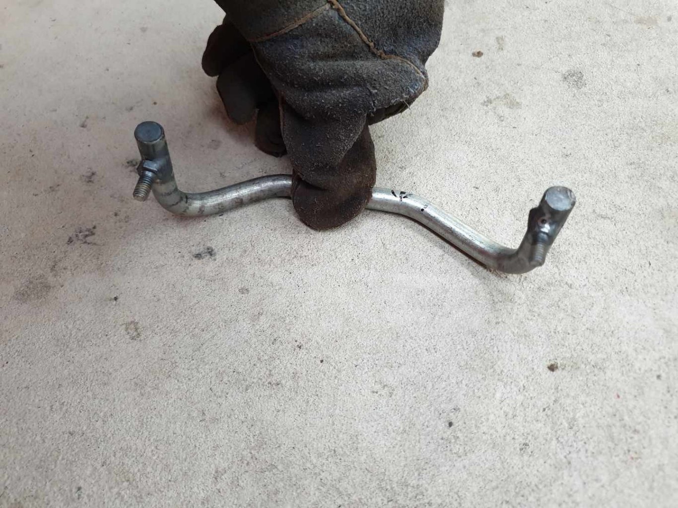

Kimjon Posted October 5, 2019 Author Share Posted October 5, 2019 Then got the frame all tacked together. I'm out of argon/co2 gas, so can't finish the job. But happy with this, as it's a step forwards regardless... Still waiting on a few Ebay bits like chain etc to finish it. So I'll park this project up for a few more weeks and revisit it then. 1 Quote Link to comment Share on other sites More sharing options...

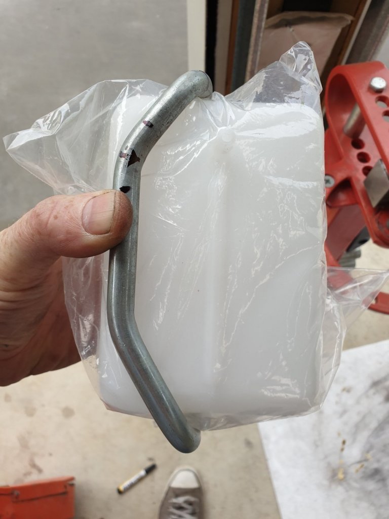

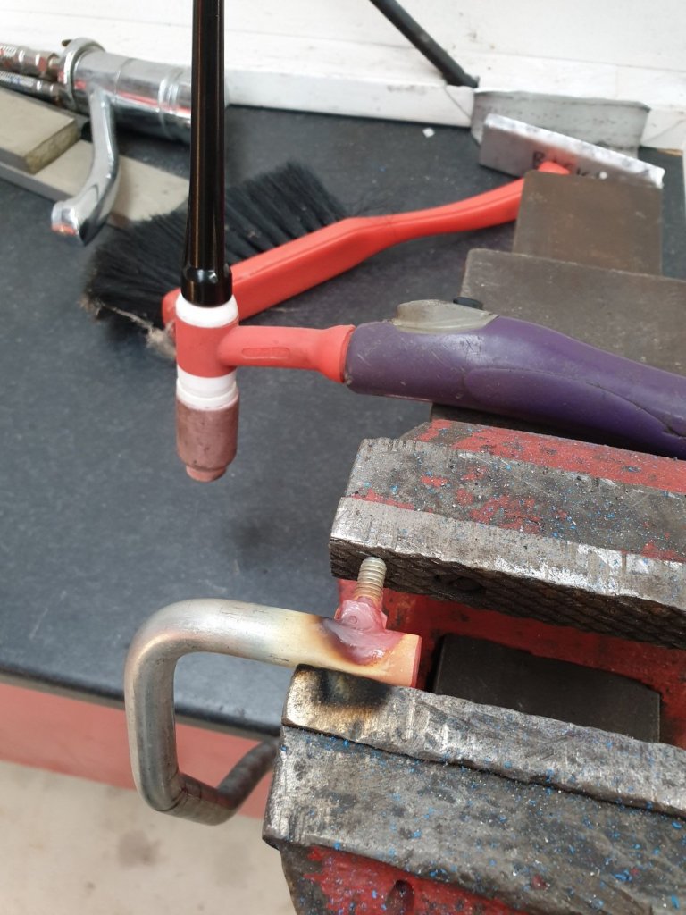

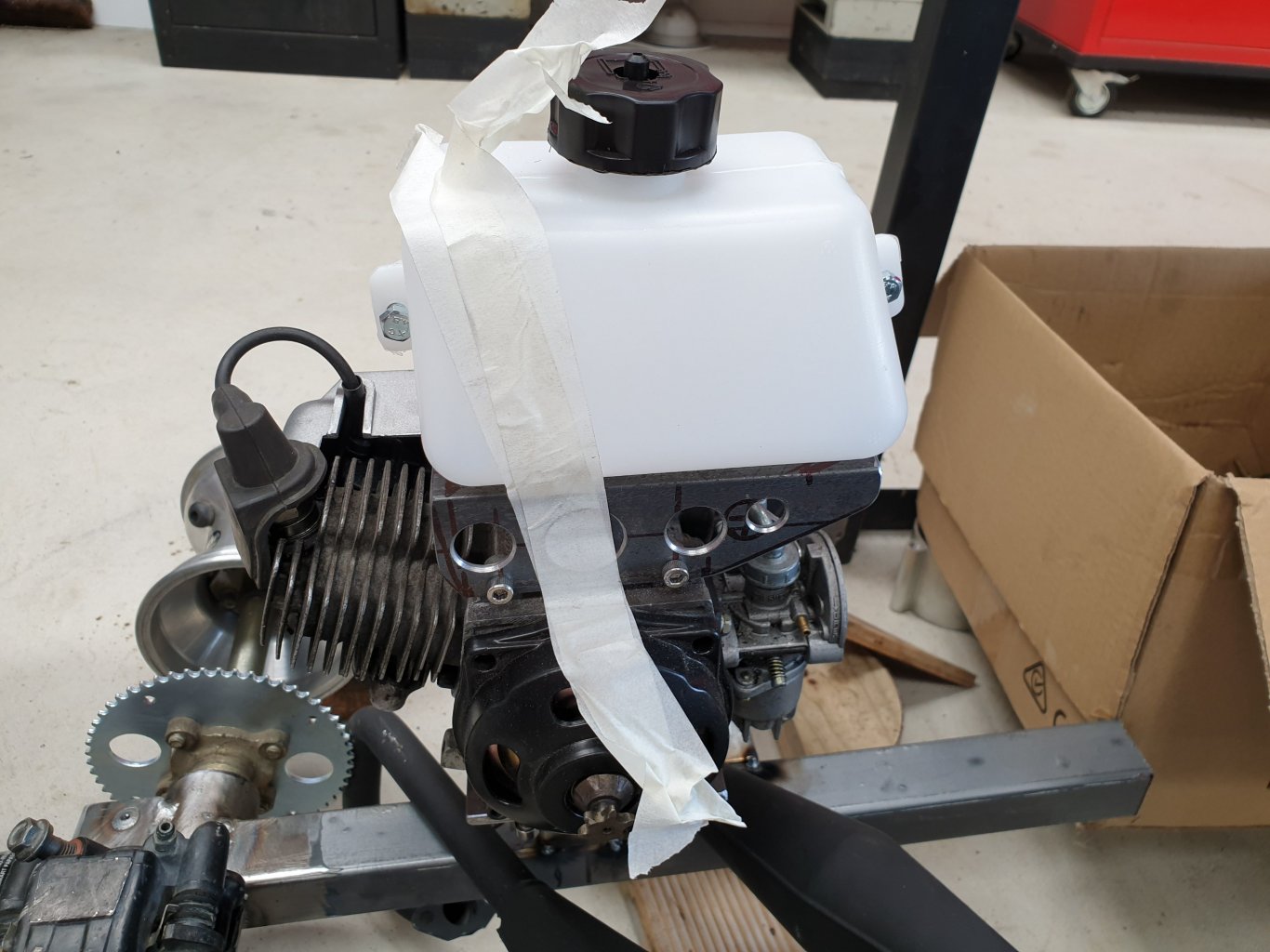

Kimjon Posted October 6, 2019 Author Share Posted October 6, 2019 Made this sweet bracket. It holds the gas tank on top of the motor, so it can gravity feed the carbs (x2). Pretty happy with that. Nice tidy solution that works well. And taped on the motor for s cheeky look... Yip...looks sweet! 2 Quote Link to comment Share on other sites More sharing options...

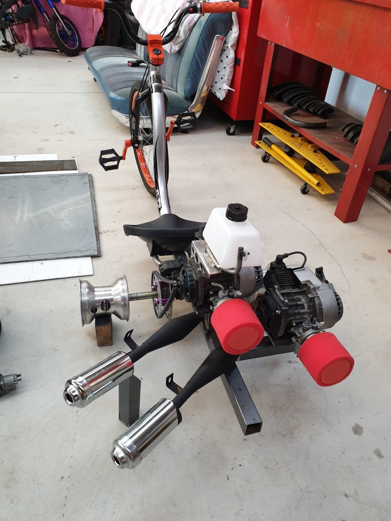

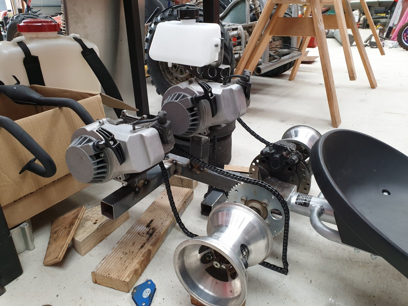

Kimjon Posted October 8, 2019 Author Share Posted October 8, 2019 Ended up arc welding it together, as waiting isn't a strong point of mine. And the chains arrived, so I could check my maths and see if everything clearances...yip...sweet!!! Coming together fast now. 4 Quote Link to comment Share on other sites More sharing options...

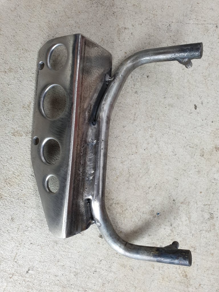

Kimjon Posted October 26, 2019 Author Share Posted October 26, 2019 A small amount of progress: Exhausts are just sitting there, but will look something like this(ish) when done.. 5 Quote Link to comment Share on other sites More sharing options...

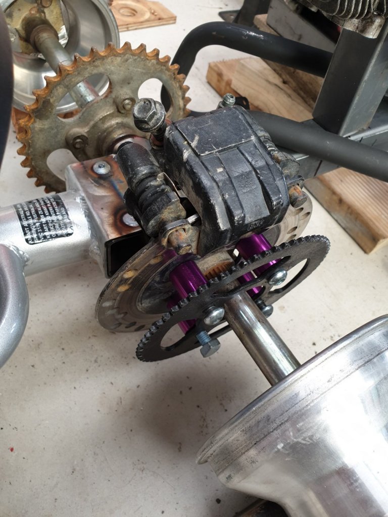

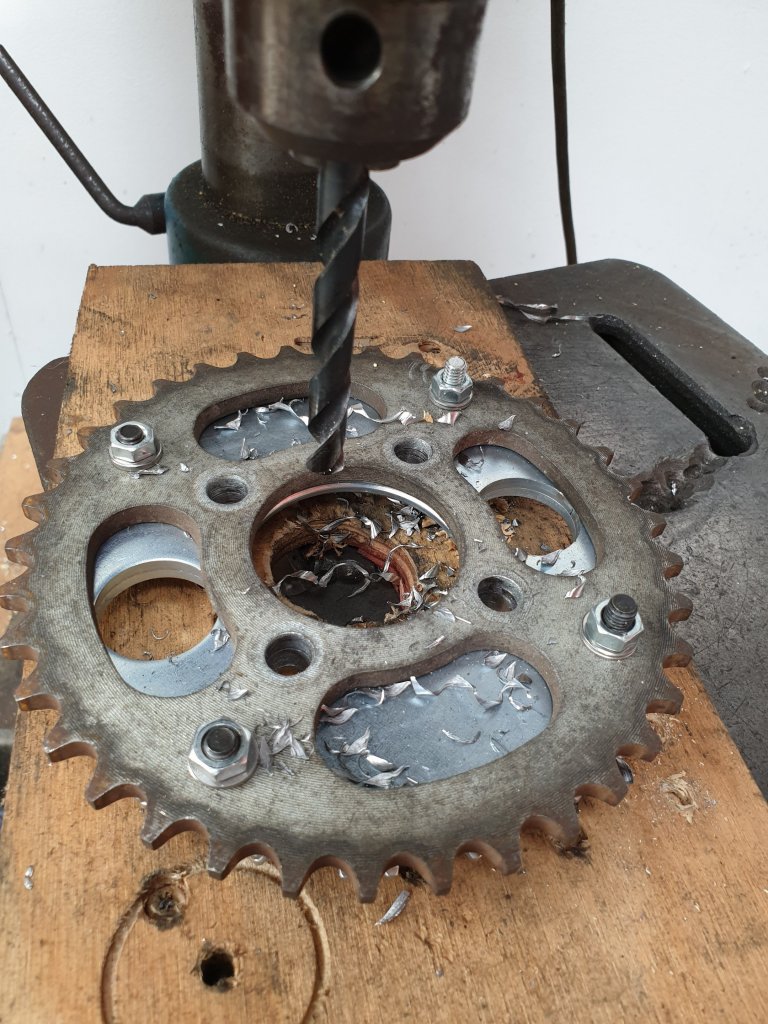

KP_wag Posted October 27, 2019 Share Posted October 27, 2019 Yeah would be kinda pointless anyway, unless you put mud tyres on it and made it offroad hill climb trike 1 Quote Link to comment Share on other sites More sharing options...

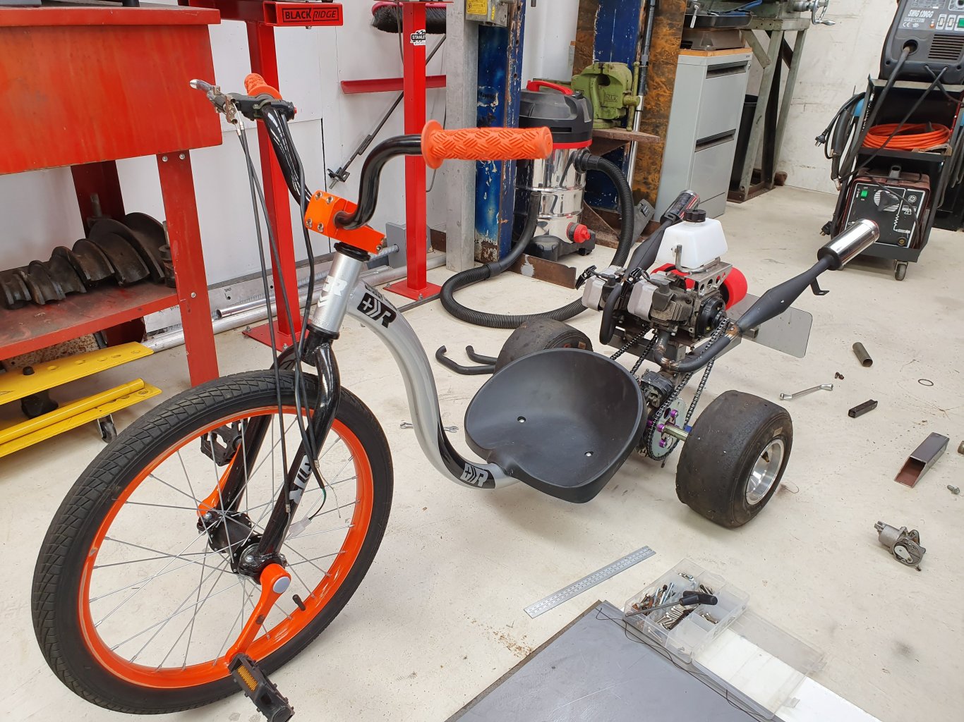

Kimjon Posted March 29, 2020 Author Share Posted March 29, 2020 Nearly there. Throttle controls sorted. Last of fab work done. Strip, paint, reassemble...drift!!! 3 Quote Link to comment Share on other sites More sharing options...
Kimjon Posted March 29, 2020 Author Share Posted March 29, 2020 Flawlessly colour matched...cough...cough. But it's not like I can pop down to my local "house of kolor" for some custom paint during a lockdown eh...so needs-must. 3 Quote Link to comment Share on other sites More sharing options...
