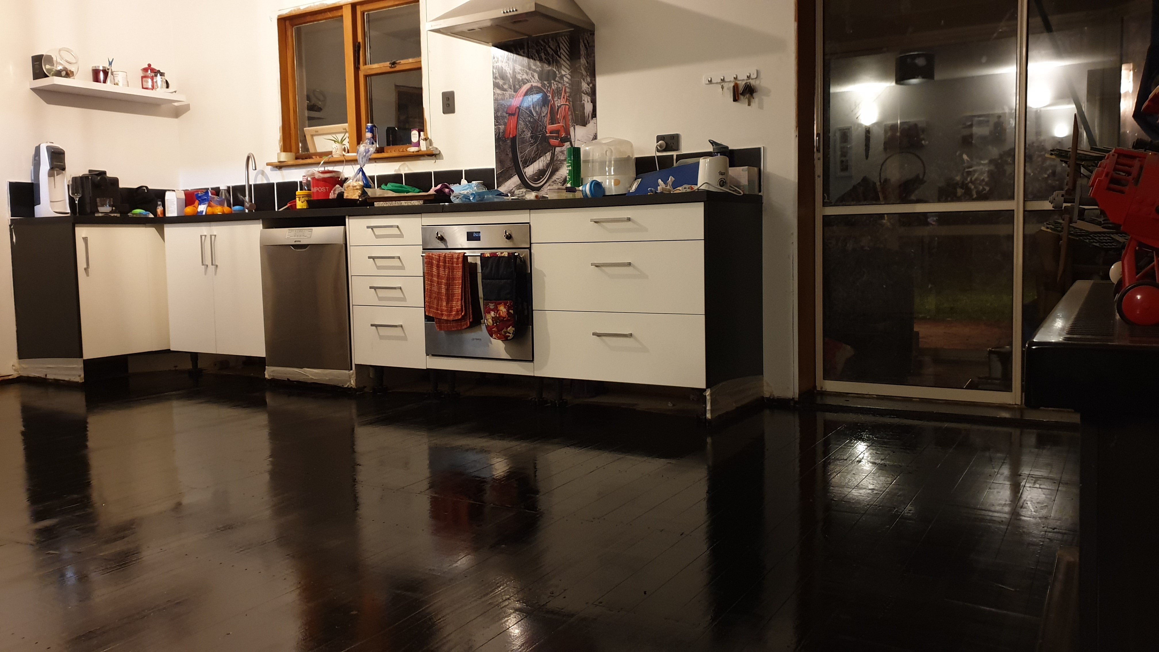

BlownCorona Posted July 8, 2019 Posted July 8, 2019 i did a test spot and it was like putting Tar on. mines a specific flooring version but will see how it goes and perhaps mix some clear for a 3rd or 4th coat. im wondering if it needs to be warmed to apply given how cold its been down here recently? how was yours? might try thinning it out too. Quote
Ashkellybarr Posted July 9, 2019 Author Posted July 9, 2019 12 hours ago, BlownCorona said: i did a test spot and it was like putting Tar on. mines a specific flooring version but will see how it goes and perhaps mix some clear for a 3rd or 4th coat. im wondering if it needs to be warmed to apply given how cold its been down here recently? how was yours? might try thinning it out too. Yeah it is super thick. It’s meant to be thinned down. you can actually add quite a bit of thinners to it and it’s still sweet. Good for the following coats. helps it self level and release bubbles too. and it doesn’t seem to slow down the drying time either. Once rolled out and a bit of air flow it goes tacky pretty quick. if you mix up to much in the tray with thinners and have left overs after a coat don’t be afraid to just poor it back in the pot. Painter mate said it’s fine and I’ve done it with this no issues Quote

BlownCorona Posted July 13, 2019 Posted July 13, 2019 Thinning it out made all the difference, rolled on with a foam roller like a dream. Now to paint that window frame black and fit the kick boards! 6 Quote
