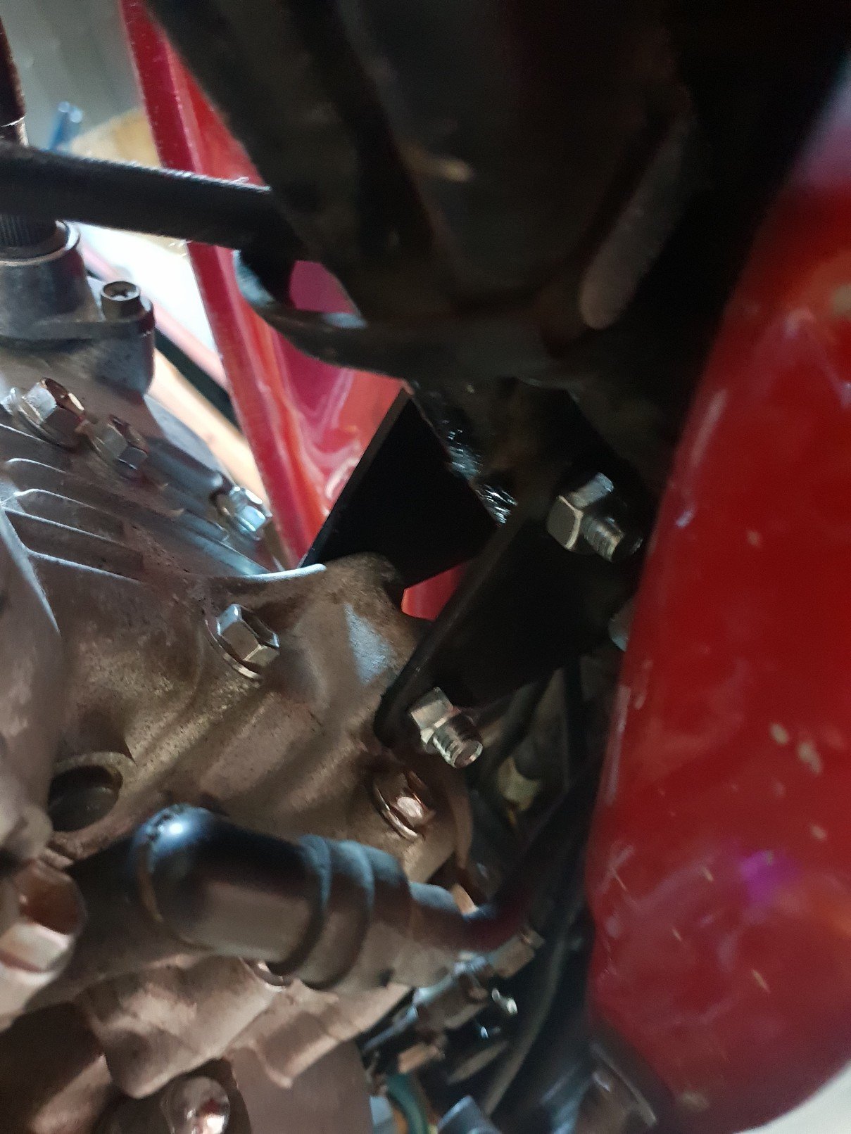

Greenie Posted December 15, 2018 Author Share Posted December 15, 2018 So I thought i better get this a wof so gave the bike a once over and found something a little sketchy, turns out I've been missing an engine mount so thought that might have been important to the wof guy. Opted out of paying $40 for kit and just made it. Cut template, made two of them out of scrap steel, painted it black got some bolts and job was done. Only other thing I found for was that the number plate light stopped working so have to sort that and will hopefully book wof some time this week. Cheers. (Yes my tank is still red underneath, couldnt be bothered going that hard when painting it.) 3 Quote Link to comment Share on other sites More sharing options...

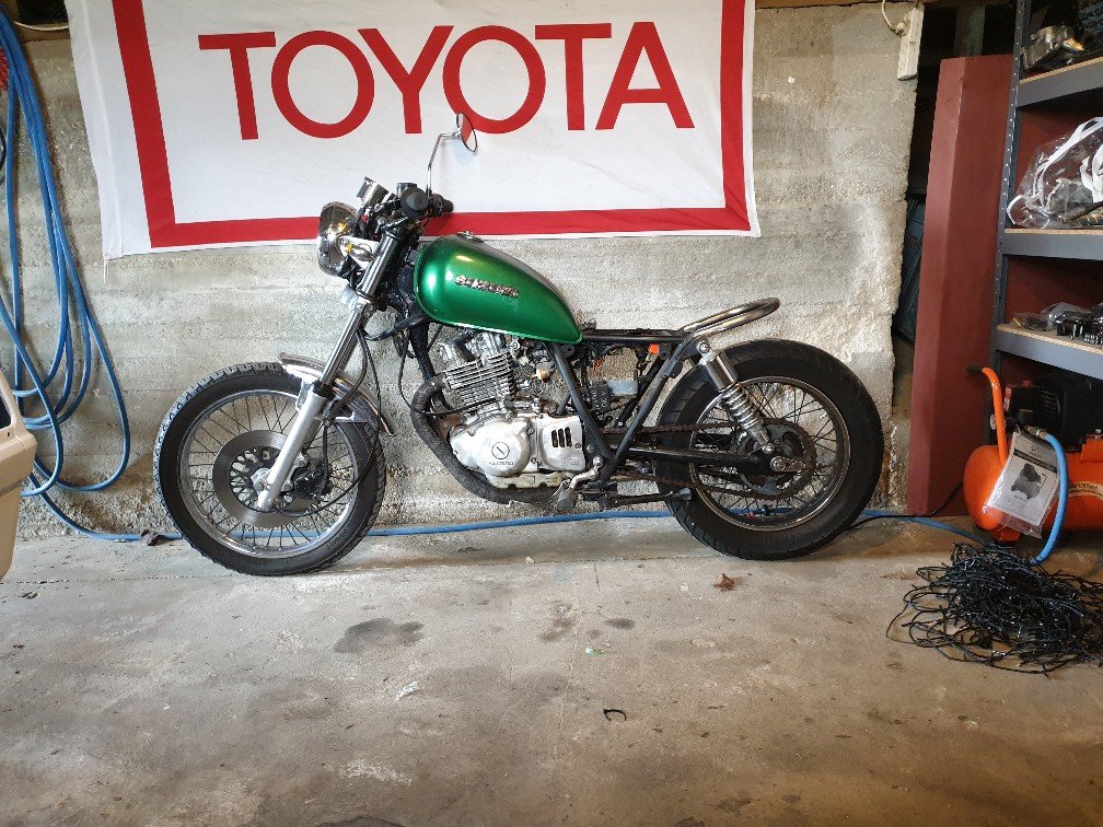

Popular Post Greenie Posted January 3, 2020 Author Popular Post Share Posted January 3, 2020 Long time no nothing. life and new born getting in the way but found some time over the break to sort some stuff out. Took this thing for a wof a while ago and the fella reckoned I had chopped "too much off". According to him and a few other people I talked to I need to have left at least 100mm of frame on after the shock mounts. So abit butt hurt i knew had some options, scrap the bike, part it out, or weld on new rear hoop and change set up. Seeing as ive given up on too many project in my past, option C is what I've gone for. Progress is as follows. Acquired rear hoop. Made inner tube pieces for support. Chopped hoop to preferred size. Welded it all together. Purchased fiberglass. Wrapped bike in glad wrap. Laid fiberglass. And here we are. I always wanted to try make my own seat so that's what I'm going to try do, from the pan to upholstery. I ran out of resin so will have to pick up more and do a couple more layers when I get round do it, I will most likely weld in a support peice at the back too. but for now I'm happy with were I've gotten. 12 2 Quote Link to comment Share on other sites More sharing options...
Greenie Posted January 18, 2020 Author Share Posted January 18, 2020 Was able to get some time in the shed last week so got those extra layers of glass down on the pan. There's about 6 layers on with a mix of 200g and 300g matting so should be plenty strong enough. Got out there today and cut it into to shape I wanted. Ruff cut it first. Final cut and sanded edges. Chose to have it roll over top only slightly so should hug the frame nicely even when the vinyl is on but leave most of the frame exposed . Also chose to go up the tank abit so itll have a nice transition into the seat. And lastly I found I was able to reuse the original Suzuki seat tongue (I dont know what it's really called) to locate the front under the tank, slips in nicely. Next job will be to add a tab at the back to lock it down and also two other tabs on the sides to attach the indicators. Then I can paint the frame and get on the hunt for some comfy foam to use 9 Quote Link to comment Share on other sites More sharing options...

Greenie Posted March 21, 2020 Author Share Posted March 21, 2020 A week or two ago I got my indicator mounts and seat stay done (just three tabs with holes in them) I cant weld but they should at least stay put.. need to lengthen the wires and get them reconnected later Also got some time in the shed yesterday and was able to smash out shaping the seat I had gotten some foam off a mate who's work had an upholstery department no longer in use. I also used many layers of old yoga matt to build up the dip in the middle of the seat. Ruff cut it after the glue had dried and shaped it with the grinder and a flappy disk yesterday. Pretty stoked I can move on to making a cover now, need to get the misses to teach me how to sew. (Same mate also gave me a large roll of black vinyl intended for outdoor furniture so should last as a bike seat no problem) 6 Quote Link to comment Share on other sites More sharing options...

Greenie Posted April 13, 2020 Author Share Posted April 13, 2020 Been trying to chip away at this thing while on lockdown, started by finishing off the frame by welding in some gussets and tried to make it look original. Took the usual steps to get there. Before During After Once that was done I need to cover my seat. Took a couple of attempts to get something that worked, I'm still not sure how I feel about it as the vinyl I had is thick af and wasn't very malleable so there a creases where I don't want them. I think I did it with the right stuff and having had the practice now I think I could do a better job, but this still do until shops open again. Put the bike back together and aside from repainting the tank and side covers I think it's done for now. We will see how wof goes after lockdown. 5 Quote Link to comment Share on other sites More sharing options...
