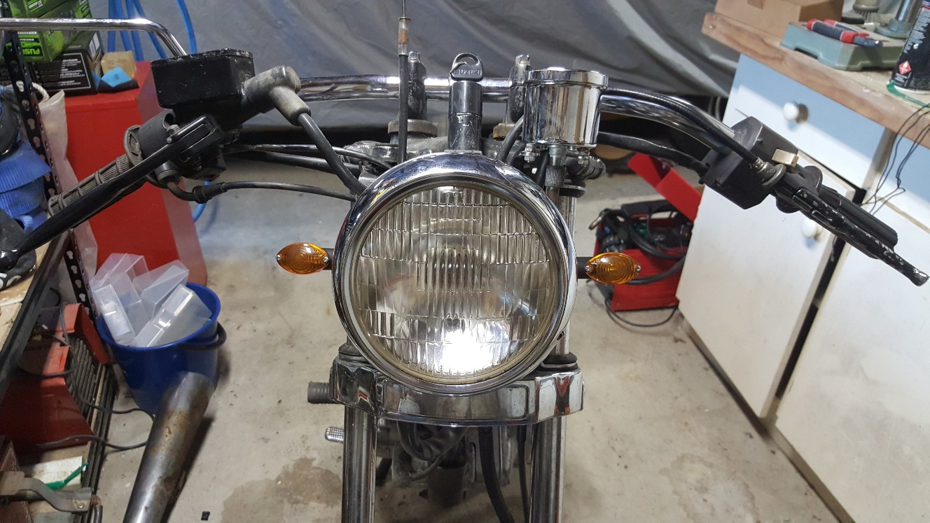

So far ive only put the old bars back on (flipped) and re atteched all the controls. Ive wired up the head light, contrals, gauges and ignition. Mounted the tank and rear number plate holder and also the new speedo.
Now i just have to buy a battery, wire up and mount the indicators, mount the seat some how, remount the rear gaurd (because atm its been held with zip ties) and cut the excess rear frame off,cut the exhaust,   as well as most importantly ->MAKE IT RUN AGAIN!

Not really an update but thought id share a pic of what the levers look like on the bike. I think they makes the bars look alot cleaner, and now i just need new grips and some kind of mirror to finish them off :)
Only another small update agian, but my shortened front gaurd arrived the other day so got that on, i had to re drill the holes for it as they werent as wide a the old ones but it worked. Also fipped my bars back to see what it would look like, because when i was thinking about what bars to get, these ones seemed to have awfully close specs too some i had looked at, so thought there was no harm in trying.   I think they look good but im still undecided as they just have a bit more rise and pull back than id like, but will stick with it for now.
Also found out that there was about an inch of adjustment in the rear shocks so grancked then over to the lowest setting, it seemed to change then hardness of the shock so it doesnt look lower with no load on the bike but sits less than an inch off the tyre when im sitting on it so can't complain i dont think :)
