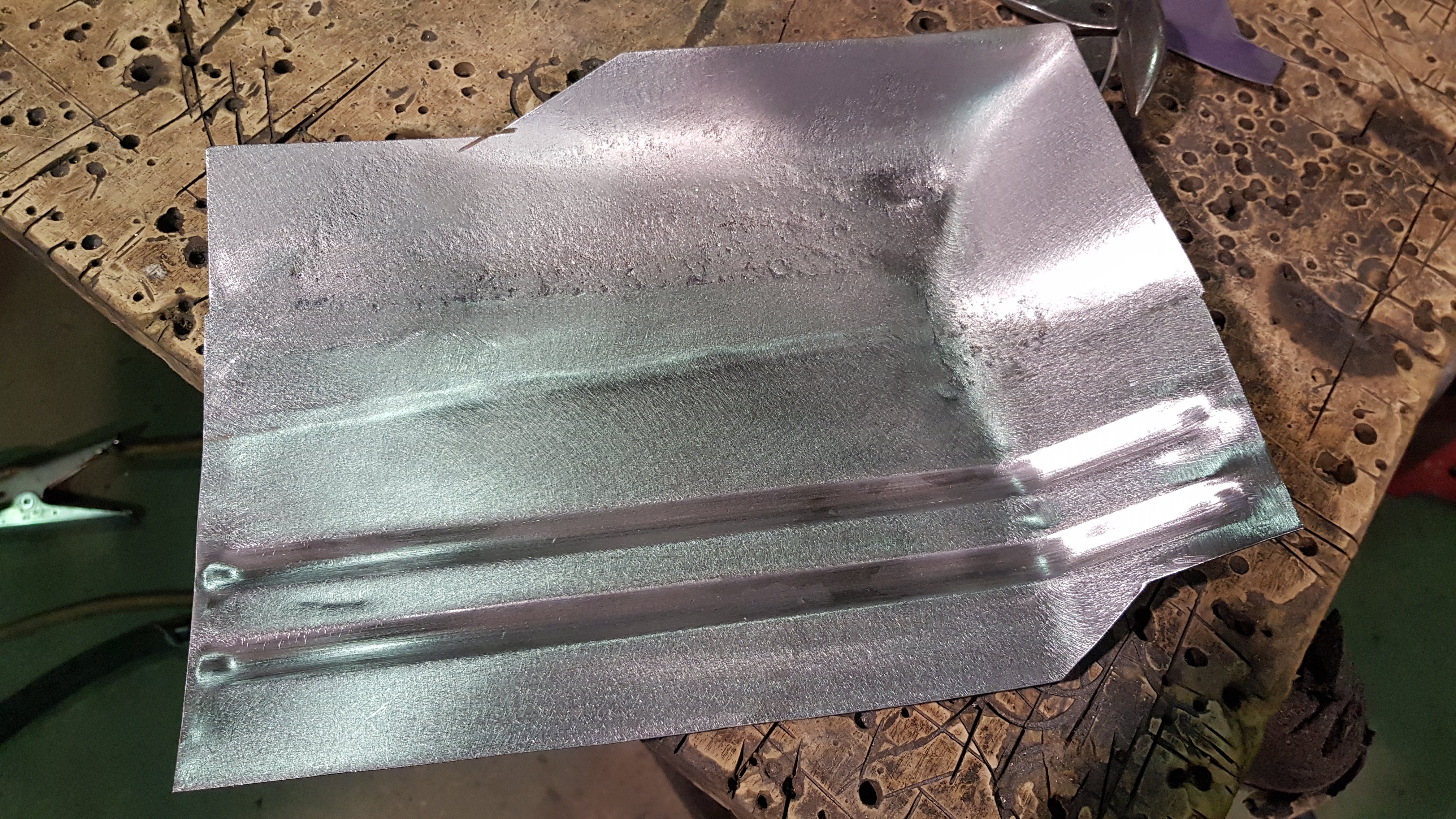

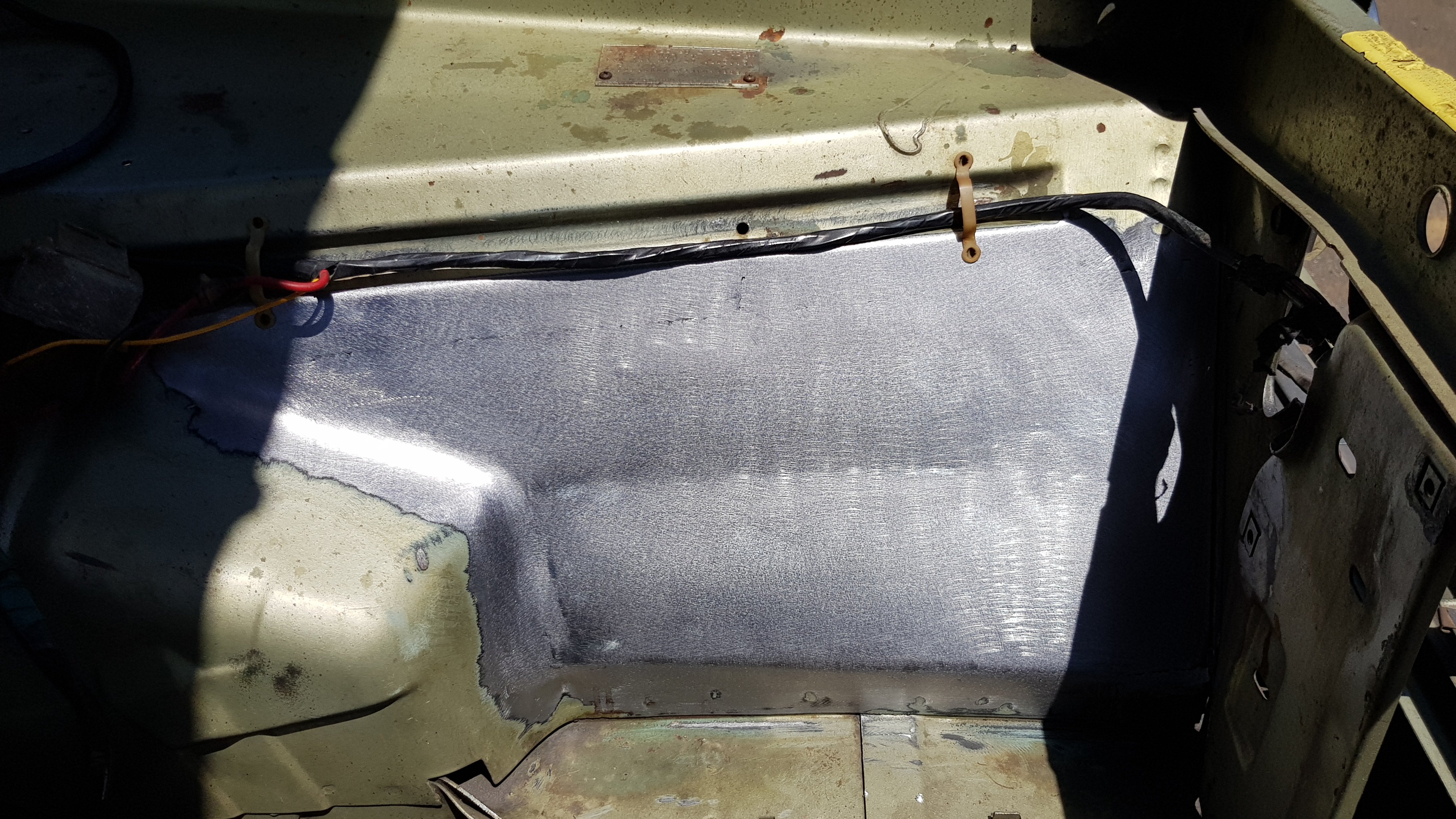

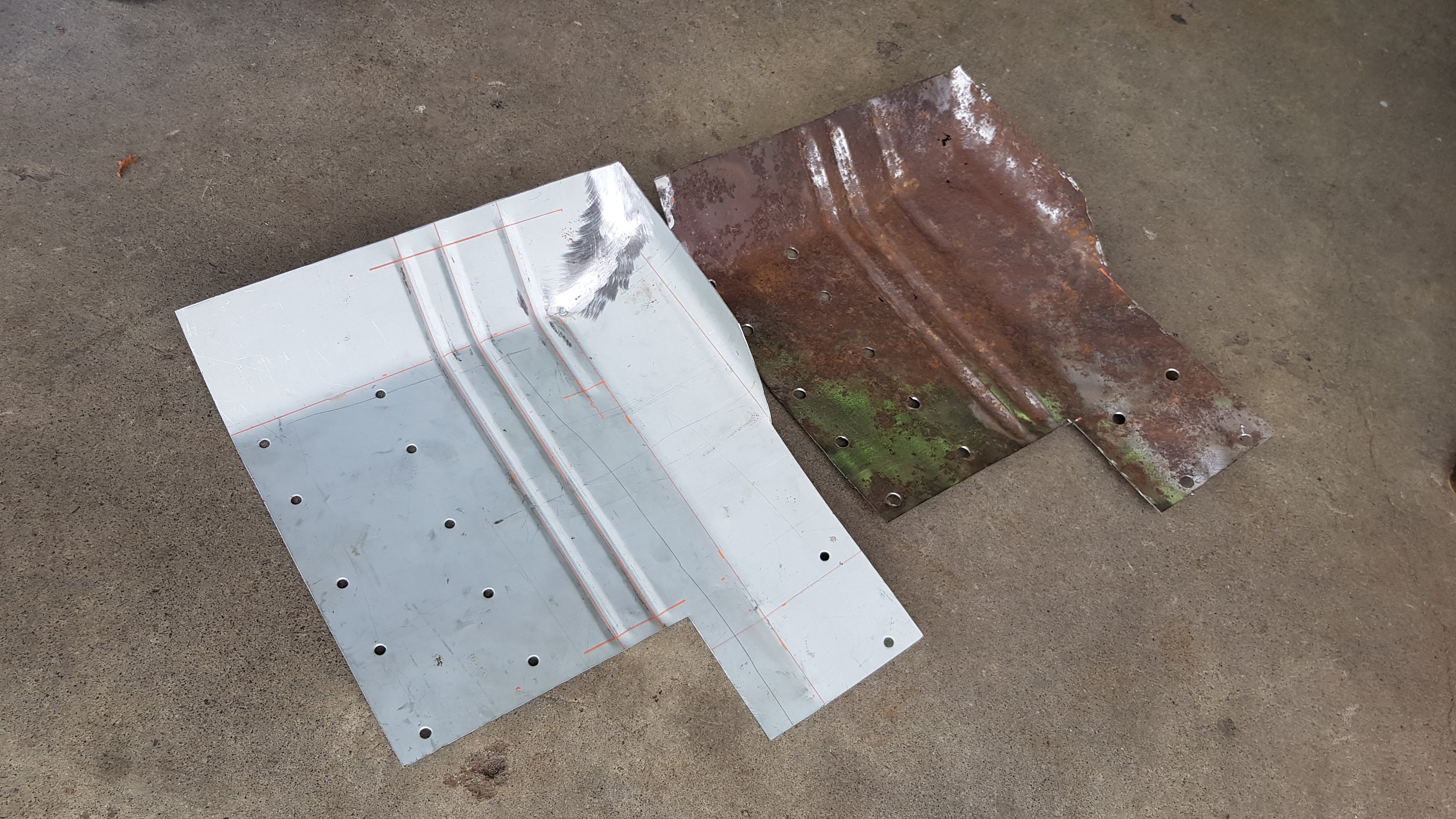

Both front floor pans had some rust on the top side which I don't have the skill, gear, or patience to do a nice job of.
@RXFORD/ Matt at tin tricks in east tamaki is a friend of mine, he picked it up and fixed the floors, while it was there he deleted the heater motor and hose holes in the firewall and made a new part of the inner guard which gets rid of an ugly bit where the battery box used to live, and made it match the other side.
My photos are a bit ham but I'm stoked with how it turned out

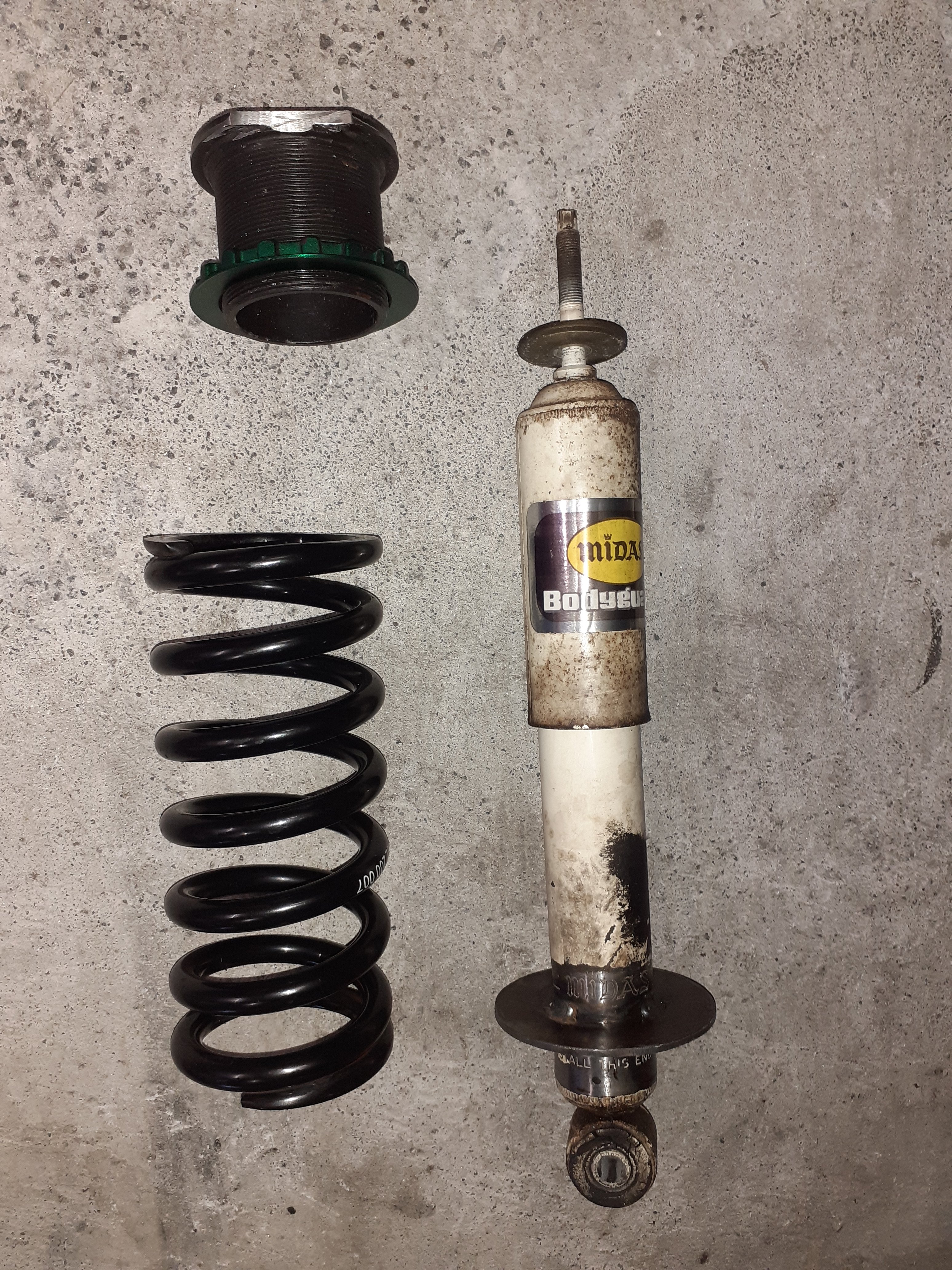

I knocked up a dummy coilover using parts I had kicking around.
I'll go see autolign this week and see if they can make a bilstein shock with a circlip adjustable lower platform and I can use the threaded one at the top. If this plan works I'll need to modify the lower arm inner pivot bush and strengthen the shock mount to cope with the weight
