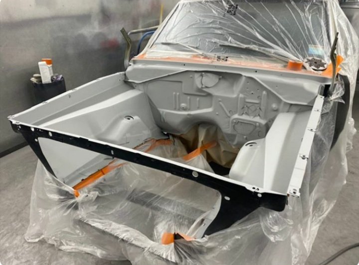

Popular Post cletus Posted September 26, 2020 Author Popular Post Posted September 26, 2020 Picked up from autoblast this morning and dropped off for engine bay paint. Looks ok apart from they painted the black parts underneath then primed the engine bay so theres primer overspray on the inner guards and in the tunnel. Which is a bummer as that was the whole reason for taking it to them because I wanted it done nicely. I mentioned it and the guy came out with a rattlecan of black paint and some rubberised underseal to throw on before the towie arrived, which I didnt want on it I didn't want to leave it there for them to fix cause I'd already had to postpone the towie and the booking at the panel shop a week, because it wasn't ready last weekend as per the booking I made 6 weeks ago. So I'll get the painter to fix it, should just need a quick blow over with some more black after hes done the green parts And the hoodlining is ripped for some reason now. Bah. Anyway, I pulled the sump off to change the oil pump and pickup back to a stock one instead of a high volume pump. Its had a couple of times in the past where it lost pressure after a prolonged period of high rpm. I was concerned it was emptying the sump faster than it could drain back, and someone i talked to about it said that on a SB mopar, a stock pickup with a high volume pump can cause cavitation issues. Someone else said a high volume pump is unnecessary anyway as once it gets to x amount of pressure the relief valve bypasses so then the oil just gets whizzed around the pump doing nothing I'll try a stock pump and see how it goes, and also add some baffles, I got a new pan cause the old one has had a few bumps and an oil drain on the wrong side now I got brave and popped a couple of bearing caps off and they looked fine 25 1 Quote

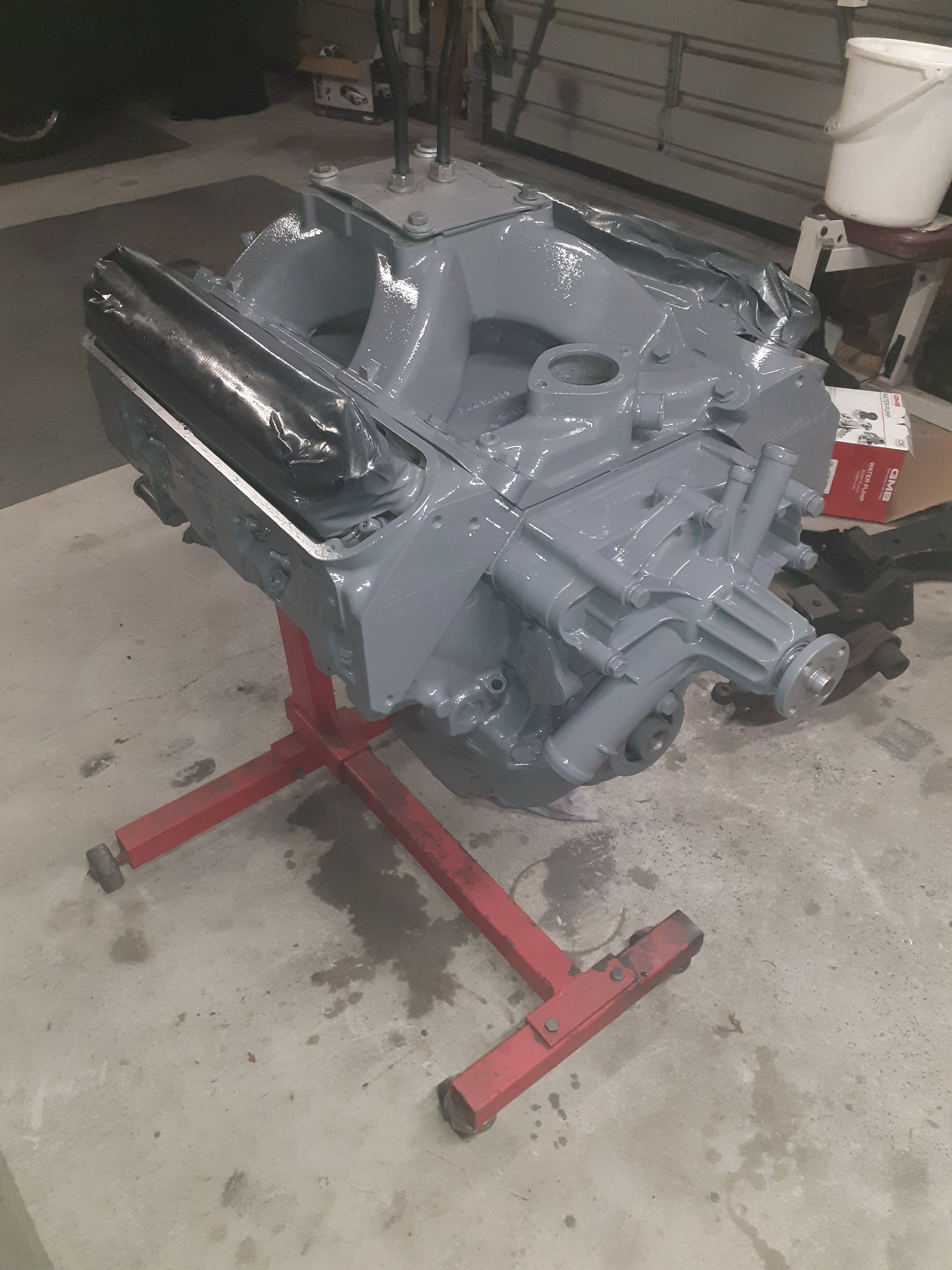

Popular Post cletus Posted October 5, 2020 Author Popular Post Posted October 5, 2020 I had a bad case of dickfingers over the weekend, sunday I was going to clean and paint the engine but while cleaning I found the front cover gasket looked a bit average so front cover off to fix that, so the sump gasket got messed around with again.... I fluffed around for a while deciding on what colour to paint the engine, I got some gold as I thought it would go well with the green but it was a bit light, thought about black but a lot of the accessories are black so the engine might 'disappear ' , factory colour would be red but I thought that might be too bright I guess that's why I chose this color originally.....so it got more of the same again this evening 28 Quote

cletus Posted November 7, 2020 Author Posted November 7, 2020 I had a decent look under the car and found a few bits I wasn't happy with, sent autoblast an email about it, no response. So I'll tell everyone to avoid them. Heres why 1. It took a week longer which, to be fair I agreed to and I could have lived with, if it was a good job. I had to chase them, they didnt contact me. This was after giving them at least 6 weeks notice when booking it in 2. The overspray issues, they painted the black parts then primed the engine bay so there was primer misted all over the black especially at the front . This cost $225+gst to repaint at the painters 3. The ripped hoodlining, I dunno how this happened, air got under it? It's an old car and probably got fragile stitching but they must have some issue with their process if parts inside the car get wrecked 4. Thin spots in the paint you can see steel through, parts which are not painted very well or at all, and poor masking. All shows a lack of care or thinking about the job properly So all that cost $2800. I could have got it done for half that at a less reputable place , for the same result, ie me having to finish it better myself 5 3 1 30 Quote
