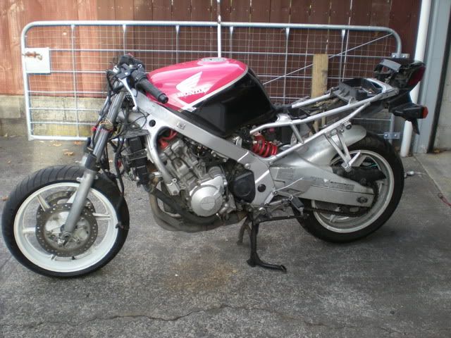

Bombsquad Posted May 8, 2010 Posted May 8, 2010 So... I'm a dumbarse who cant hang onto money. Have been wanting another road bike for awhile now and also looking to get into stunt riding. Was originally looking to only purchase one of these but the owner sold his house and offered me both, im not sure if i got them for a good price or not but can hopefully make something out of it. Plan is fix up F2 (earlier model) for a legal road bike, and build the F3 (later model) into a stunter/burnout hack. Both bikes share a common frame and motor with the F3 getting newer plastics, better air intake, upgraded rear shock and a few other plus's. As they sit now, one with pink tank is the F2 model Took 3 of us to lift it on the trailer, took me 2 mins to get it off again Atleast they came with a few spares Quote

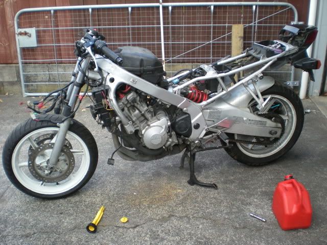

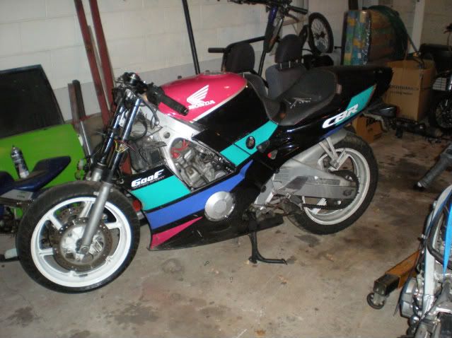

Bombsquad Posted May 9, 2010 Author Posted May 9, 2010 So i set myself a goal of having it ridable within 24 hours... Picked up these from a mate this morning for a fuckin good price Than did this Tried to get it running when I picked it up but failed so brought it on the hope that it was indeed a runner, removed tank and drained all the shitty stale gas out of the carbs (poured it on the garden and set fire to it ) With tank off And refited with clean fuel filters and new 96 gas, took a fair bit of winding over as it has a stupid vacume diaphram thing on the fuel tap and needed to build up pressure, but it fired up and sounds bad arse Took it for a little ride up the road but had no front brakes and no headlights so was sketchy as. And this is how it sits after 24 hours, noy bad really considering the previous owner had it sitting round for months Quote

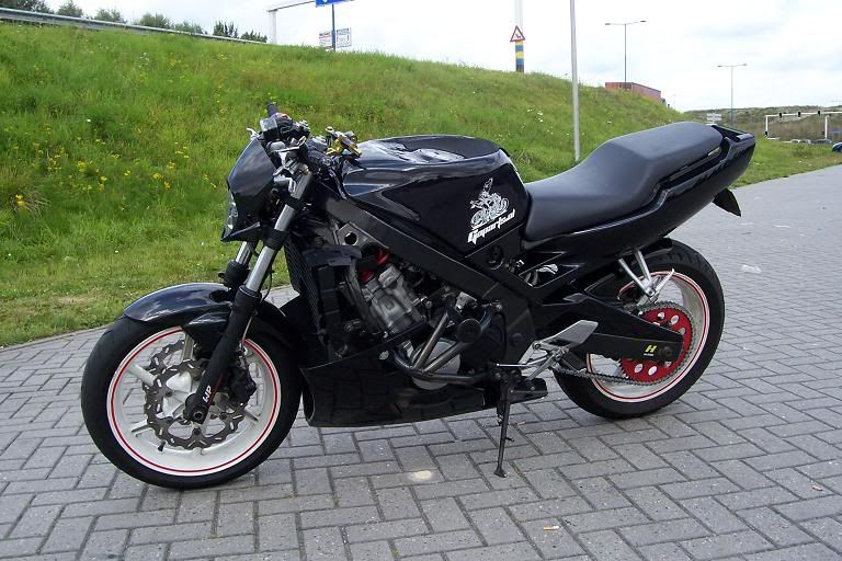

Bombsquad Posted May 9, 2010 Author Posted May 9, 2010 Ewww spuzuki ill never have another one thats for sure, fuckin tempramental things with weak as shit frames. Im aiming for this look, this thing was the insparation for me buying this model in the first place (I fuckin love it) Quote

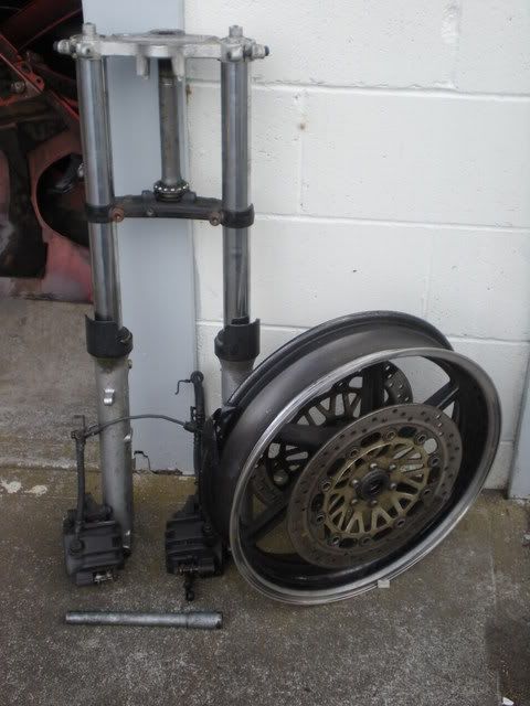

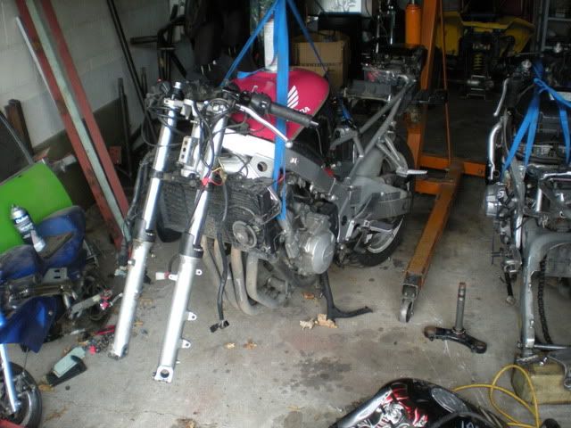

Bombsquad Posted May 15, 2010 Author Posted May 15, 2010 Lazy update.. tidied up the garage and sorted out all the shitty fairings, mangaged to throw out a whole bunch of shit which was great, also helped in my decision on what dash to run on the f2 (trailtech vapour) and new inicators and headlight setup. Doing this will eliminate the need to find impossible fairings and dash parts etc. Also decided while i was on the cleanup mission I decided id start stripping the track bike down for its rebuild, Needless to say the front is lighly toasted, dont think theres a single salvagable part as even the tripple is twisted Damage to headers should buff out (required a grinder and chisel to remove them from the bike) On the plus side ive found a set of headers off a 600 hornet which I think are exactly the same Looking at the front tyre on this thing the previous owner was a suicide mission its amazing he didnt kill himself. Will try and get this bike running before i get too carried away with it as id hate to get all ahead of myself and then find out the motors fucked. Doesnt seem to be any damage to mainframe or engine block though, not even scratchs on clutch covers, so hoping for the best. Quote
