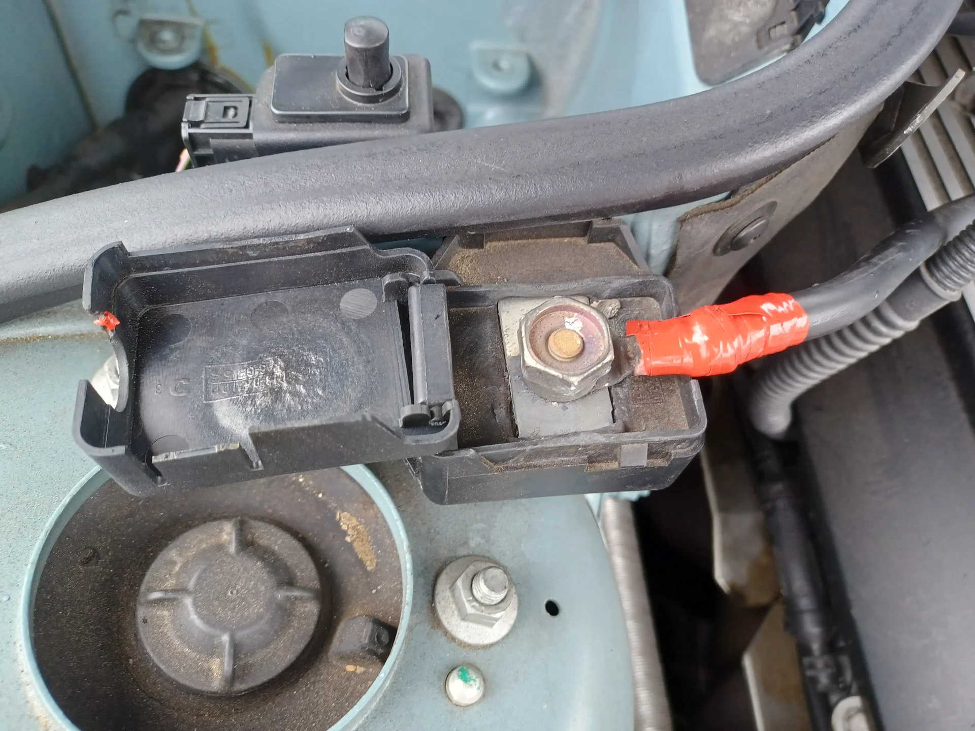

  2. I'd run the battery in the passenger's footwell or behind the passenger seat. I am a big believer in keeping it close to keep it simple and not need as much heavy wire everywhere. In my friend's SSS Sentra racecar, he wanted to put the battery way in the back until I pointed out that mounting a lightweight battery on its side in the factory position meant he didn't need a huge amount of cable everywhere. Everything that needs battery power is in or around the engine bay. If you're running dual 15" subs each with its own dedicated amp, then go hard and put your battery in the back of the car. But it doesn't make sense to lose all that power to voltage drop getting the power back to the battery, and then using the power in the front of the car. It also means that you can run a smaller battery cable and terminals, which all costs extra the bigger you have it, plus you need annoyingly large cutters and crimpers and large battery cable is a ballache to work with. Battery terminals are also a great distribution block. You can bolt all your extra cable runs to the battery terminal and then you don't have to buy an additional distribution block. These are amazing. E46 engine bay positive terminal. They are like $10 at pick a part and give you a nice isolated engine bay terminal if you need one.

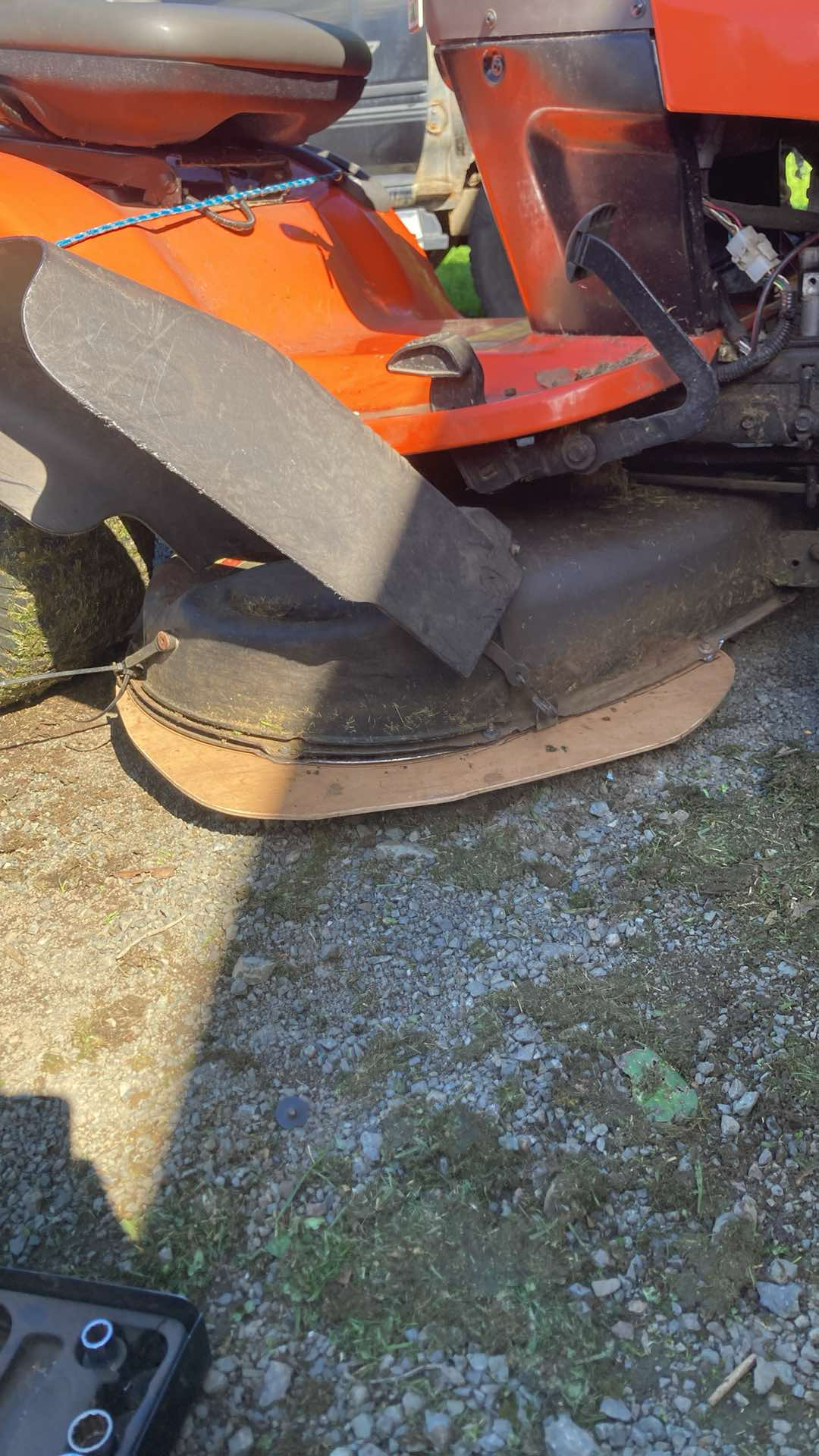

  20. So the horrible concoction on the lawnmower actually stemmed from this thinking. I got sick of bending the steel plate that goes under the deck and figured that ply would just bounce, chip or wear as opposed to bending and being a pain in the ass all the time.

  22. Splitters are something I take very seriously, as you can see from my lawnmower... I like the idea of a splitter blade that mounts to the chassis, is easily removable and has a lip that blocks airflow between the splitter and the bumper. Ideally, it's also gonna protect your fancy fibreglass bits from damage. I'd look at Kevlar to wrap the splitter for the same reason it's used on jetboat bottoms, it's much more impact resistant and won't smash like CF. These guys make a really cool-looking bracket that's adjustable and has a quick release https://www.pci-racing.com/product-category/aero/front-splitter-brackets/ EDIT: You'll also notice that I never read any of the posts on this page before writing my post.
