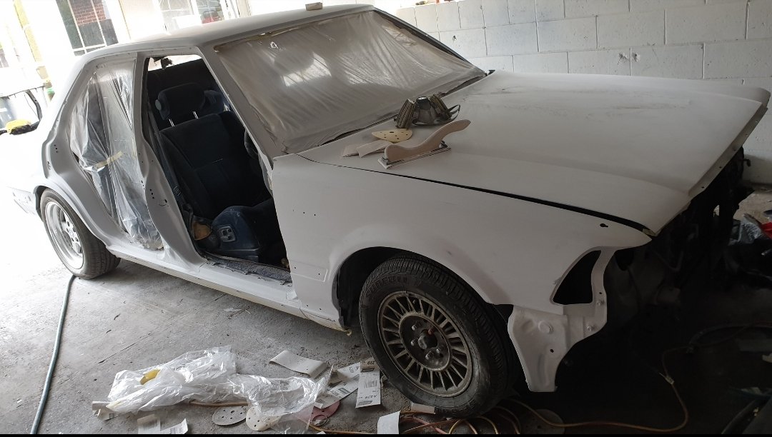

Finished sanding the primer to 600gr, which brings this era of my life to a close. I don't really remember a time I wasn't sanding the crown, but I now have a very large appreciation to how many compound curves and just how massive it is. Celebrating with a double whiskey and now looking at the forecast to pick a suitable day to spray this once and for all! Cheers

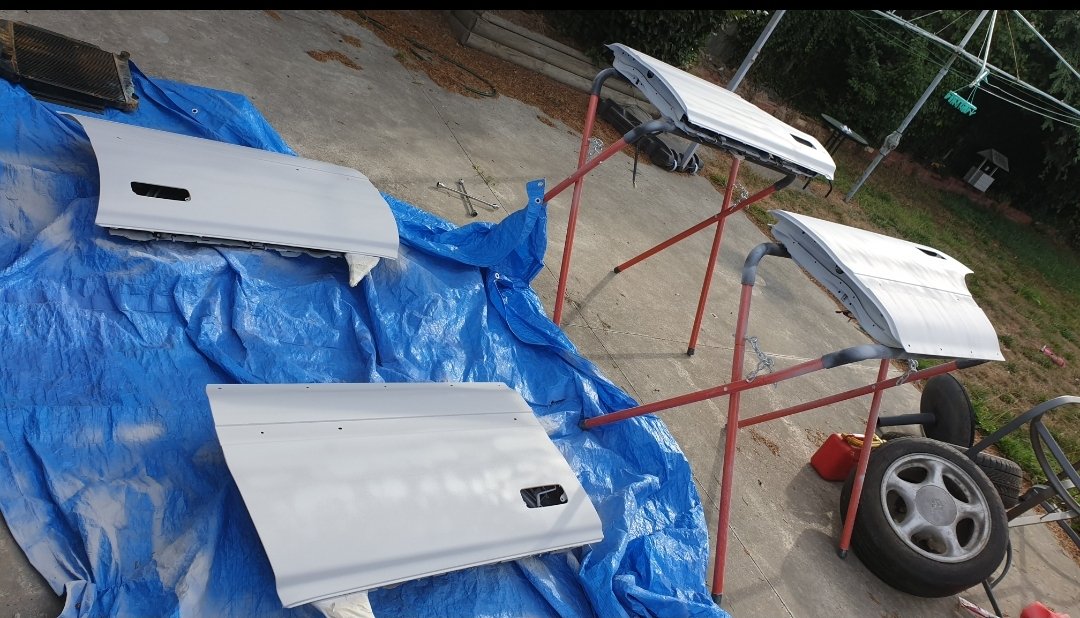

More mind numbing progress. Shell, gaurds, hood and deck lid are done (excluding the ten thousand tiny areas that need some close finer attention) Doors in primer today. Still to touch the bumpers, sure am glad I left the most difficult for last Loosely hoping to be blasting some colour in 2 weekends from now.
