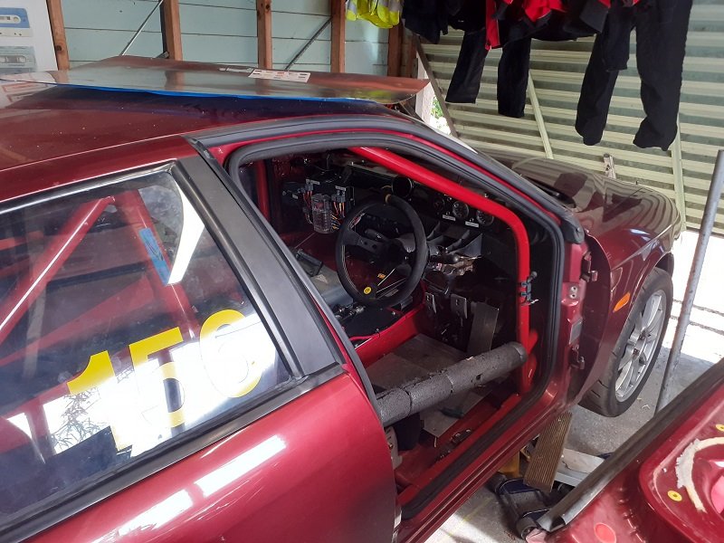

Door Trim Off. Used Jumper Pack to wind window down to enable removal. Fuck these are handy. Bam and the Steel is gone. If in Doubt, Chop it Out. Well on the way, still go a bit to tidy up before starting on the other side. Will weigh it tomorrow and see how much came out. Enough to justify a beer anywyay. Used one of these Emery Tape Flapper Wheel Disc things for the 1st time on this door. (On Panel steel at least). Fuck they're awesome, they remove a surprisingly large amount of material and are really good for creating round radius edges, also great for trimming the burrs from the cutting discs. A+. Would trade Again.
Damn, whilst half of the country is on forced project progress leave, I've been classified essential. My partner too is essential and so I have volunteered to take on our 12 Hour Night shifts over the grape harvest, that way someone is at home with the youngling during the day (albeit sleeping). Anyway updates will remain few and far between and generally completed at unspeakable hours of the morning. Today I ran over the Wheel Stud situation, and I've just completed my order for some of these bad boys. Originally this lovely European machine was fitted with wheel bolts, which although does reduce unsprung weight at the wheel, is just completely impractical when wheels come on and off as often as they do on a "race" car. The ones currently fitted don't have a shoulder between the two threads to tighten up on. They have been a royal pain in the ass ever since I fitted them. Supply for decent wheel stud / extensions is dismal in NZ. So I desperately tried to make what I could find work, tack welding them at the back of the hub to attempt to secure them. The thread quality of those and the wheel nuts I used also leaves much to be desired, so I'm hitting the reset and hopefully the replacements will be a permanent solution. No idea when these will arrive in NZ, could be a week, could be 3 months, fuck, could be 12 months in our current predicament. Finished removing the sound deadening in the boot area. I also wondered why I didn't finish this. Shortly after starting with my painfully monotonous manual removal method, I understood why. Next time Dry Ice. Anyway the car has finally had all it's sound deadening removed after nearly 7 years. Bam. Door Off. (The quick release hinges on modern cars are fucking sweet, 2x 6mm bolts and the door just slides up on off) The 2 Rear Doors have perviously had the lightweight treatment, and are really fucking light, they even have Lexan Windows, which were cut down out of a rolled Fiat Uno Club Car. My goal is two Lexan the 2x Front Windows and Fit a Slide Window on the Driver's Side. But current estimates are about $900 for a sheet of Lexan. So that may not happen for while. Just wanted to put in on the Authority Card really. Anyway the wiring has been disconnected for quite sometime so I started the Nip, Tuck and Liposuction, to remove all the redundant internals and extra weight.

It's been some time since I've been in possession of an Oldschool vehicle, but I thought I'd post a thread covering my Alfa Romeo 156. My Non Japanese, Non Wagon, Non Oldschool "Race" Car. I'm hoping to keep a record of this beast, and gather advice / inspiration from the oldschool.co.nz population as I see some really good tips and ideas coming through for others on their build threads. Brief History. The car was a standard road registered 2.0 Litre Twin Spark with the Infamous Selespeed Transmission. (Manual Gearbox with an Electro-Hydraulic "Robot", e.g Semi Automatic Gearbox). Just like most European cars it was poorly maintained and arrived at my then work with a rod hanging out the side of the block, the customer was uninterested and sold it as a parts car to the workshop. Around this time, I was going through some big personal life events, just out of my apprenticeship and I was broke as hell and had an unexpected son not far away. The workshop was doing quite alot of Motorsport orientated Fabrication and Mechanical work, as well as being the NZ OMP Distributors at the time, the plan was to convert this 156 into a Clubsport orientated car that was effectively used to show customers what we can do. They could try out seats, harnesses and steering wheels and we could gauge a persons requirements size wise prior to commencing a build on their car. So I foolishly offered to build the Rollcage Nights and Weekends as I wanted to learn to do this work for myself, I also had a serious itch for projects and this way I didn't have to fund the progress. Anyway from memory it took about a year or so to get the initial build completed. XYZ Adjustable Suspension. Rollcage with Incorporated Tube Seat Mounts. Converted the car to Conventional Manual and Rewired the Car to operate purely on the original Engine ECU sans Selespeed ECU whilst retaining Fly by Wire, No easy feat considering I couldn't find anyone else who had ever done it but alas like all these things the solution was quite simple in the end. Other than that the car was pretty much standard other than OMP Front Brake Pads and Motul Brake Fluid. It was at this point that my boss said to me, that since I built the damn thing, I better be the one to go race it. So basically for the next few years I taught myself how to drive(if you could call it that), competing in local hillclimbs, Dual Sprints, Clubmans Grid Racing, Producation Race Series, slowly developing the car into what it is now. Luckily for me, my boss basically came to me, indicating that over the length of time I had been running and modifying the car, he felt that the car was more mine than his and sold it to me for a price that I most certainly couldn't refuse. At this point I went a bit batshit, and the last big transformation took place. Unfortunately the car has barely been used for the last 2 years and has been living with 10-5, gathering dust mostly, I even attempted to sell it, the market then proceeded to let me know that no-one actually wanted the car and that it was effectively valueless to anyone but me. So now I have moved to Blenheim and for the 1st time in my life have my own garage at my own house. I will proceed to spend even more money on NZ's most useless 156. Sorry, that almost bored me to death, so I can't imagine how you feel, so here's the photo's of me trying to sell her.
