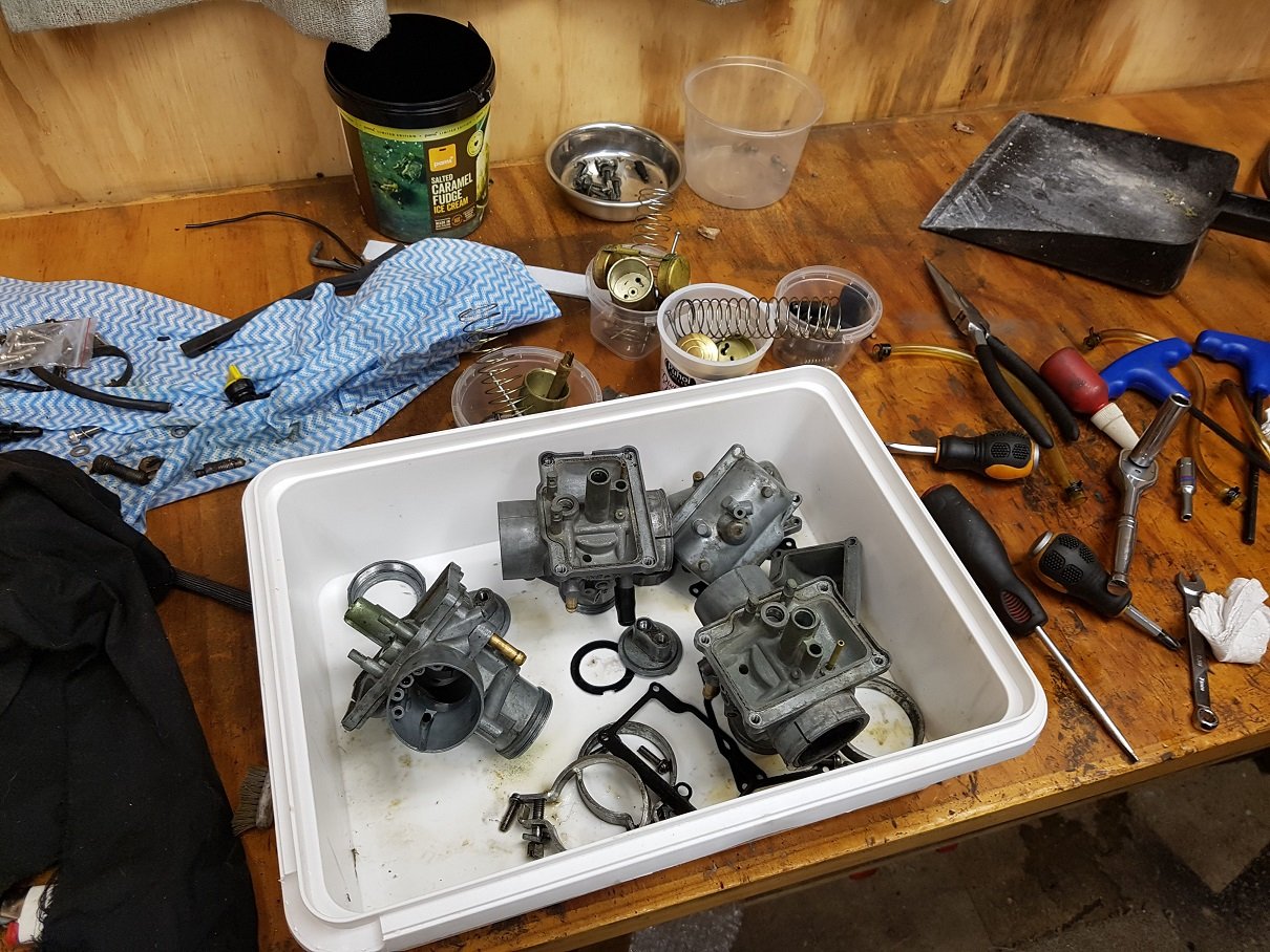

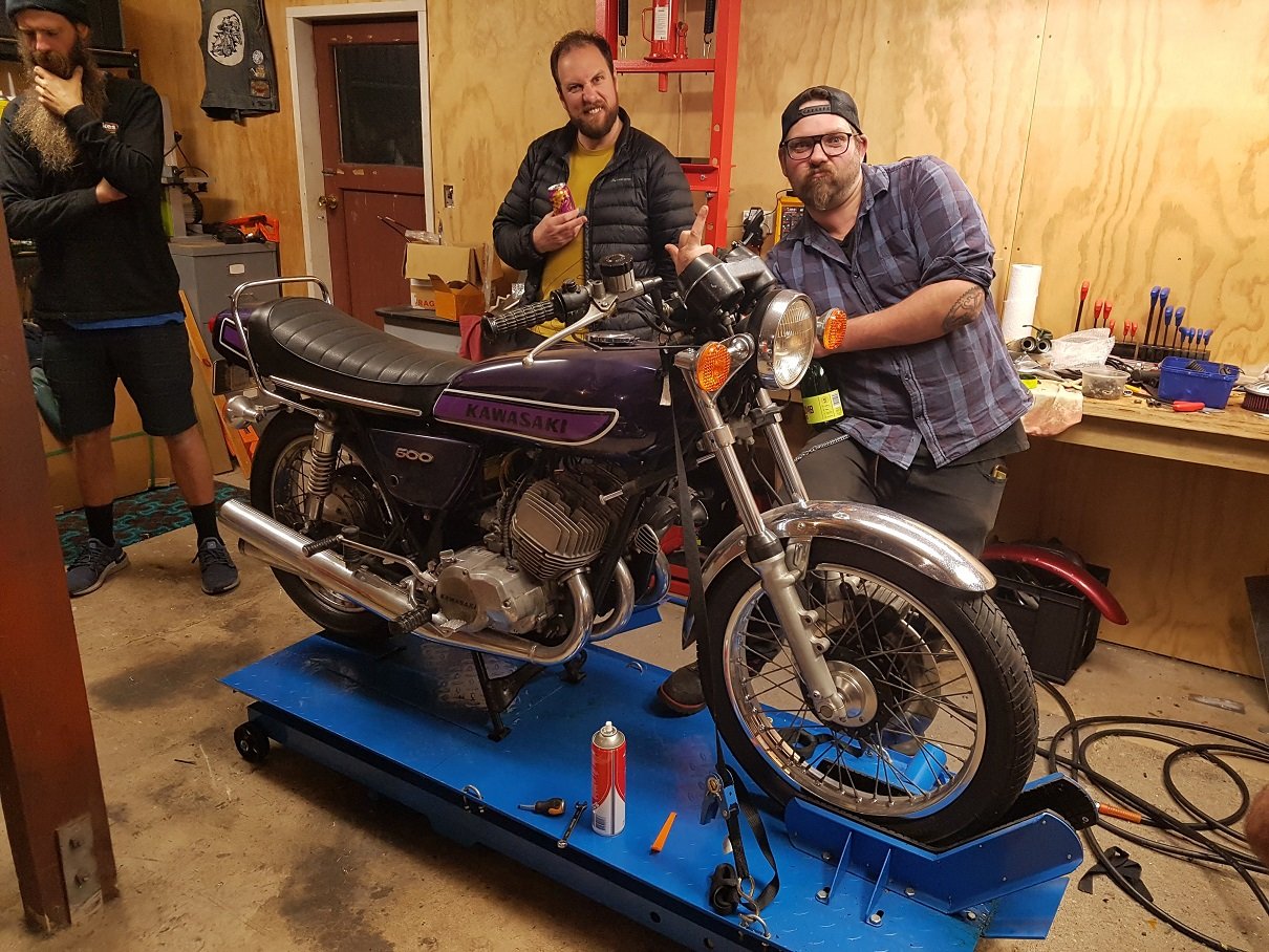

Yeah, the H1s got progressivly "tamer" the longer the model ran, all sorts of regulation kept restricting them. The last of the line 1976 KH500 a8 is actually lams approved lol. A long way from the "widowmaker" reputation of the early drum front models! I've got a drum front one awaiting restoration. Currently accumulating bits for that. Anyway, back to this saga. First step, get it out of my room and onto the operating table. The dudes at bike night were more than happy to provide motivation support. So last time i had this running, the carbs were pissing out fuel, so took it apart and found that the floats had been eaten by whatever gas was in it. I managed to solder two of them up, but the third i had to pinch a float from my other h1 (1971 H1a) to get this running. I knew i needed to go through the carbs again and fit a new set of floats, and probably jets and needles too. The slides had seized from sitting. So off with the carbs and managed to get the slides out. I proceeded to whip the carbs off and take them apart to inspect: They were pretty clean inside, but one of the needle holders was loose as a goose. Looks like the securing brass pin had been eaten away. So will need to figure out how to re-pin this when the carbs go back together. The jets were pretty skodey (though not blocked) and the needle holders had seen better days. So will get new everything to biff in. I though i'd pull off the sidecovers to give them a bit of a cosmetic resto, Removing the stator cover, and about a thrid of a litre of two stroke oil came out.... this isn't good... You can kinda see the tide mark in the pics. This isnt looking good. It means that: a) The oil check valves are definitely tired/not working. So will get new springs and balls for those. They seem to be the rebuildable type, so thats a bonus. b) The crank seal on this side (and probably all the crank seals) are rooted, so that is probably one of the main reasons for its shitty running. Looks like i'll need to pull the engine out, split it, and get the crank rebuild. This will be a great oppertunity to get the engine cases blasted as they look a bit skungey. Cool, more work and $$. Thank god i love the misery. Should be finishing the Laverda, but that;s not a passion project, I love two strokes and Ducatis, The Laverda just looked like a good buy at the time (it wasn't) and i'm too far down the rabbit hole to bail now. hah Probably will need a new stator, and potentially ignition pickups too as god know how long they've been soaking in oil.

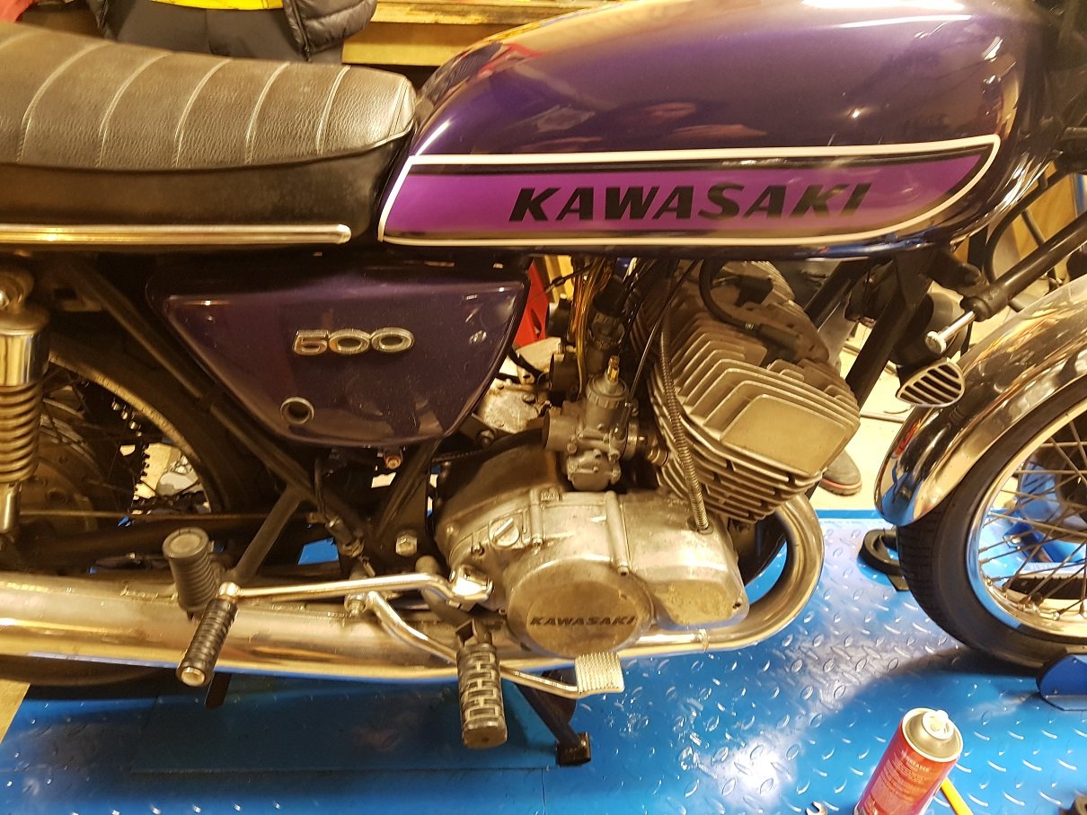

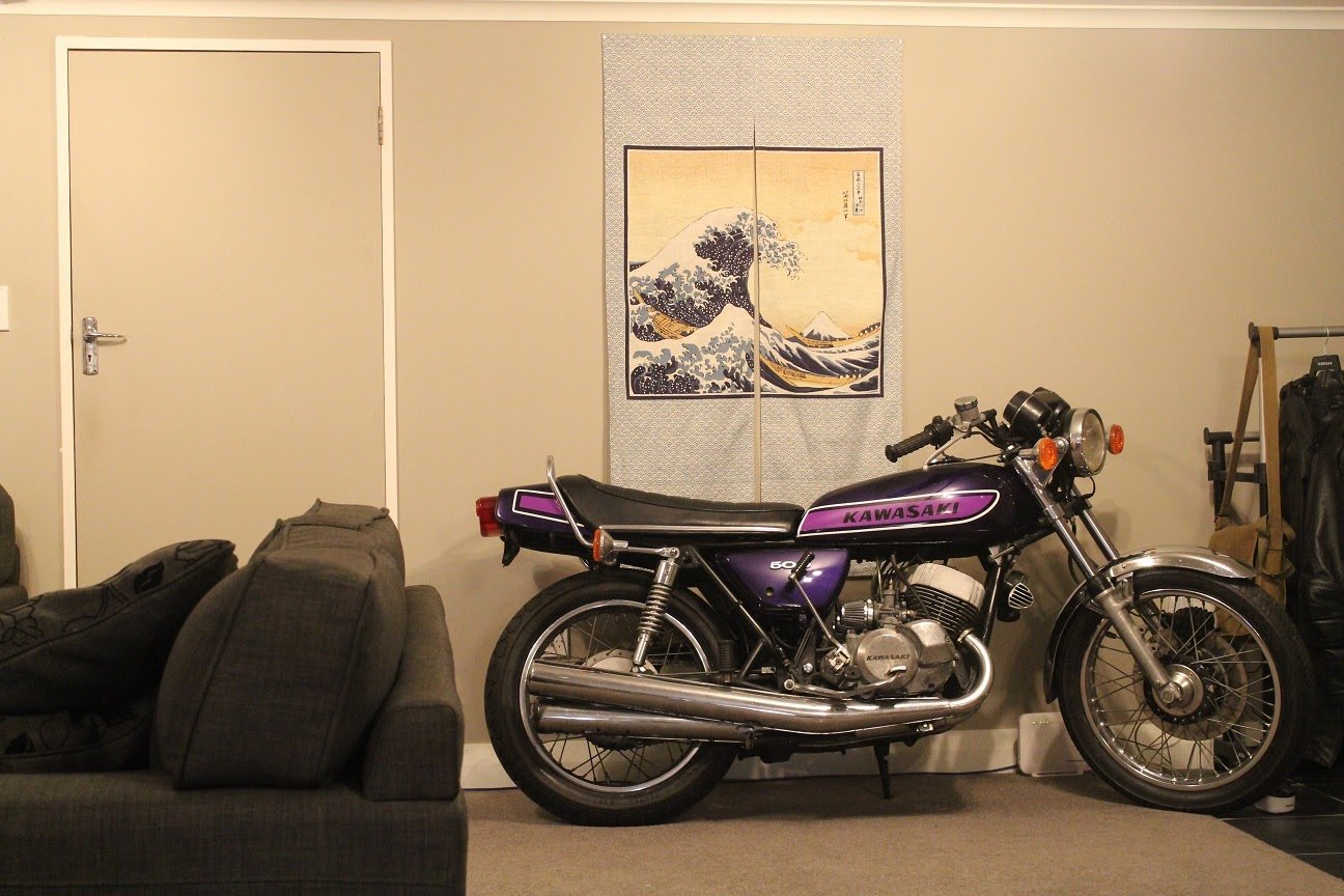

Starting a thread for my blue smoke projects. God i love two strokes. Currently ripping into my 1973 H1 500. I bought this bike years ago (2015 i think). Went to look at it with @kicker and a deal was made. It was a US import that had been sitting in NZ for a few years. I got it complied and legal by the end of that year. Didn't even have my licence then! Never rode it. hah. Got the tins painted by @Bellicose on here. He did an amazing job. Has sat in my bedroom on display ever since. Started it up a few times at partys for lols. But never took it on the road. I did get a wof on it once. And rode it to an oldschool meet. But what a turd. It surged and bogged all over the place. I could also never get it to idle. It was actually pretty sketchy to ride with its surging and bogging. So parked it back up again on display. Until now....
