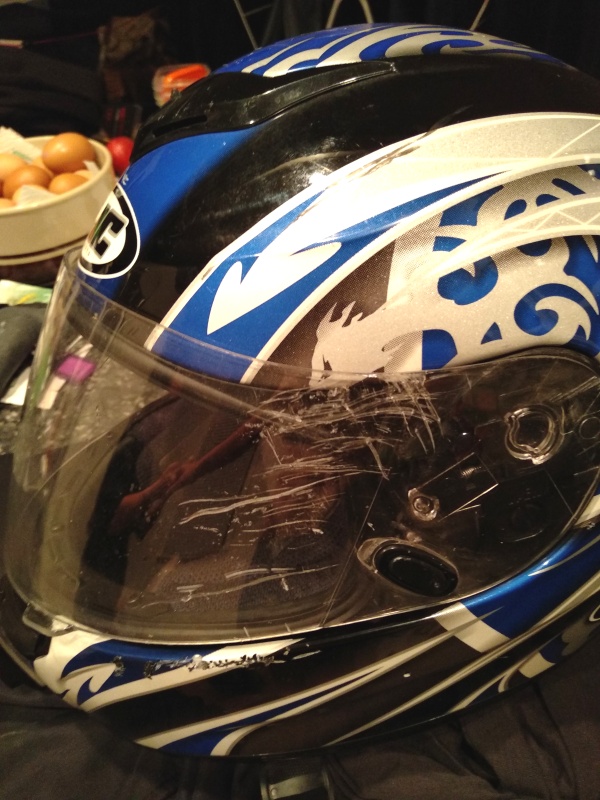

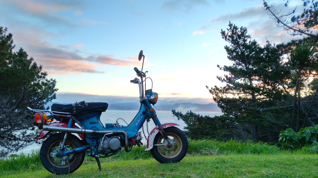

Might need to do a bit more to the carb tuning and possibly the front brake or something first... Went for a ride this evening and took a few pics Was going ok, jetting seems pretty close etc. After taking the last pic I was coming down the hill, 1st wheelie, 2nd wheelie, slow change to 3rd, 45k on Speedo, opened the throttle wide then it was like hitting a wall and the world spun around on me Front wheel locked up solid and the scooter instantly flipped on me, happened fast but I think my head, gloveless hands and left shoulder took the brunt of the impact, bike landed hard on my back. Pretty sure nothing is broken, but both hands, shoulder, knee, ankle and basically whole left side are fucking sore. Apparently I'm confined to couch rest and am not allowed to go and pull the front end apart right now, but yeah something has locked the front wheel solid. Brake lever is snapped, indicator lense is smashed and there is a bit of road rash etc here and there. All in all I'm thinking I came out lucky.

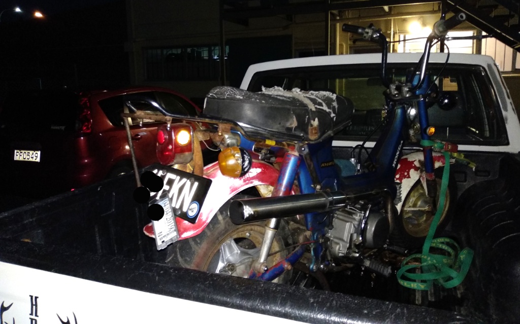

Oh yeah, so after discovering the head gasket just hours before we were leaving for Auckland I refitted the factory gasket that I took out when fitting the high comp piston and head etc, torqued to just over 15nm and chucked it in the van more or less untested and with gas, carbon and chunks of gasket in the oil lol. Easily running the best it has since I've had it, think there's still a bit of power to be found though... Hardparked with @MopedNZ, @MichaelJFox, @Shakotom

I had torqued it to 10 or 11nm which is the stock setting, after talking with @BLIZZO it seems like bumping that up to maybe 15nm or more wouldn't be a bad idea with the high compression head and piston combo. Re-torquing wouldn't hurt either with China gaskets, looking at getting a copper gasket for it too. I'm thinking the ever growing head gasket leak was the main reason I've been struggling to get a consistent tune.

At least it's not a holed piston or fried valve, looking at the bright side. Explains a few issues it's been having too, I actually think it's been leaking for a while tbh, grey carbon flecked oil was odd!
