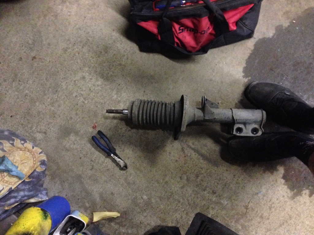

So I keep having issues with this building up corrosion on the inside of the distributor cap and rotor periodically which causes it to miss and run poorly, but once clean and it appears to be sweet for a while. considering they're just under a year old, and its not driven heaps its weird. New cap and rotor maybe? Every time I park it somewhere and come back to it there's a puddle of coolant under it that comes out of the RH chassis rail but there's no signs of leaks from the cooling system, It holds pressure fine and is always full up to the top under the radiator cap, and reservoir level is okay so that's got me stumped also. Also I've decided that that the front suspension is not going to beat me, and I gave up to easily before. So I had a chat with the guys at SAS and found some longer rack ends that should work, so I went to Zebra today and got a pair of standard front struts to use for fitting purposes and if all works then Ill drop cash money on adjusties. Only thing is, the set of adjusties that I had for this before had a smaller shock tube diameter at the top (same as factory VK) compared to the late model standard shocks that Ive got now. Technical stuff now: Adjustable top mounts have a 18mm internal diameter Vk shocks use a m14x? thread and are 14 mm down to shock tube. (sold adjusties used a m14x? thread also and then stepped up to either 15mm or 16mm where top mount sat. I cant remember with out finding the old spacer) standard later model struts use a m16x? thread down to shock tube. So I need a nut like this that uses the m16x? thread with a 18mm external diameter for now. Gonna flick a email off to toyshop engineering once I find the thread pitch and see if he can help out. If not maybe drilling out and retapping the nut might work. If this all works, it should widen the front track by 20mm,mean I can use the VZ 2pot callipers and 296mmx28mm rotors off it and throw on a 1in master (they stop factory VZ SS commodores so should haul up a VK okay) allow me to run some silly negative camber if wanted. Also been eyeing up some adjustable radius rod arm because if doing all this may as well cert all the things, but so $$$. First things first Thomas. Get the steering attached.
