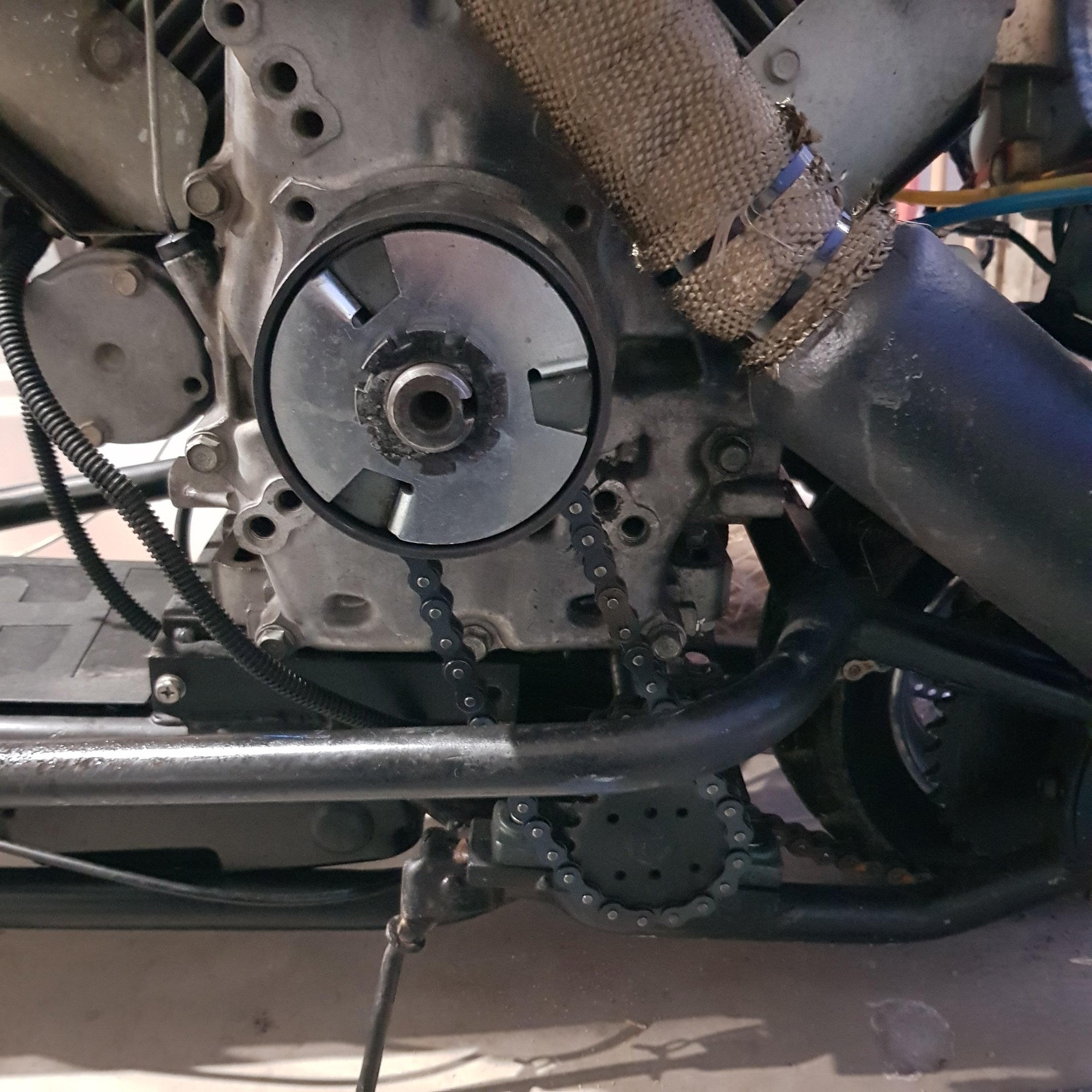

I also sorted some adjustment for the jack shaft so no need for the chain tensioner anymore looks way nicer and fitted nice new chain. Did burnouts...... needs a tune again bloody race fuel.
This thing has been a bit of an ornament lately as ive tried to sell it had a few people look at 1 rode it and came back white as a ghost shaking....... he decided his son would be be better on something a bit more shall we say docile. So on to repairs and fine tuning things, the chains were fucked and since i fitted the new back wheel out of alignment by about 5mm i ripped it all apart and set it all up nicely so the wheel just slips in. This meant spreading the rear frame i just jammed a jack in there and it didnt fight much. I had to sort the rear brake caliper as the wheel now been centered and frame spread it had moved everything.

Truth be told i haven't ridden this since the above happened. Some aliexpress bits arrived this week so i thought i might as well fit anyway bit of tianium colored header wrap to prevent major jean destruction. Im toying with swapping the engines over with my sons mobility scooter beast as he loves this frame and has done some welding on it, he lives on a farm so could legitimately use it safely his 5hp Robin motor would work perfectly i reckon. I have acquired all the stainless steel parts now to do the turbo as well....... and sussed a cheap and cheerful way to run my carb blow thru for max ethanol spooly flame carnage
