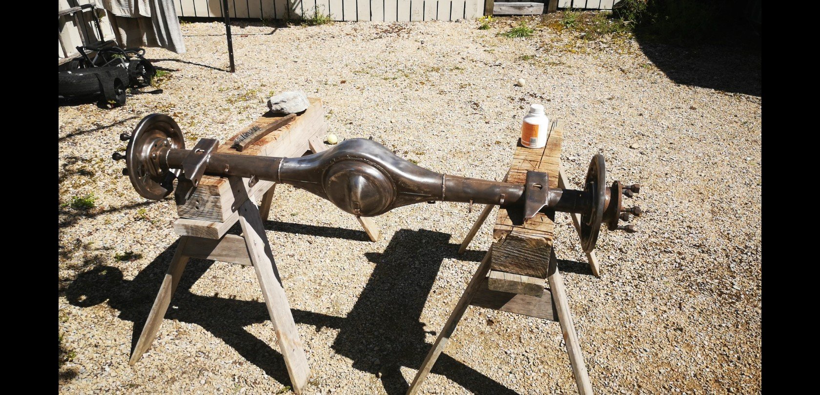

Pulled the diff and associated hardware out yesterday, was pretty painless as pretty much every nut came off with little to no effort bar the u bolts putting up a small amount of resistance, very grimy which is also to be expected after almost 60 years, guess that helped keep bolt threads reasonably lubed.. The housing had some fairly bad surface rust on it but should be all good with a clean up, I'll change the pinion shaft seal reseal the head, I'll prob have to do the axle seals as a can see evidence of a leak there. Also might have to put a new brake line in as its fairly rusty too..
