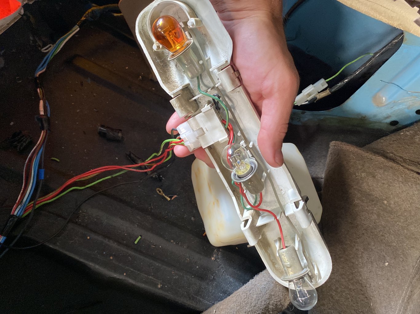

Mike323 Posted November 11 Author Share Posted November 11 I’m just running it off the earth wire that comes out of each light cluster here is a picture of a rear light cluster Quote Link to comment Share on other sites More sharing options...
AllTorque Posted November 11 Share Posted November 11 Try touching it on the bulb holder if that doesn’t help, touch a little screwdriver between the bulb cap and the holder. 1 Quote Link to comment Share on other sites More sharing options...
Mike323 Posted November 11 Author Share Posted November 11 Okay I haven’t thought of trying that I will give that a go and see how I get on I did wonder if it was the earth in the lights but I will try that and let you guys know thanks 1 Quote Link to comment Share on other sites More sharing options...
440bbm Posted November 11 Share Posted November 11 That'll be it. Side of the bulb not the bottom haha Quote Link to comment Share on other sites More sharing options...

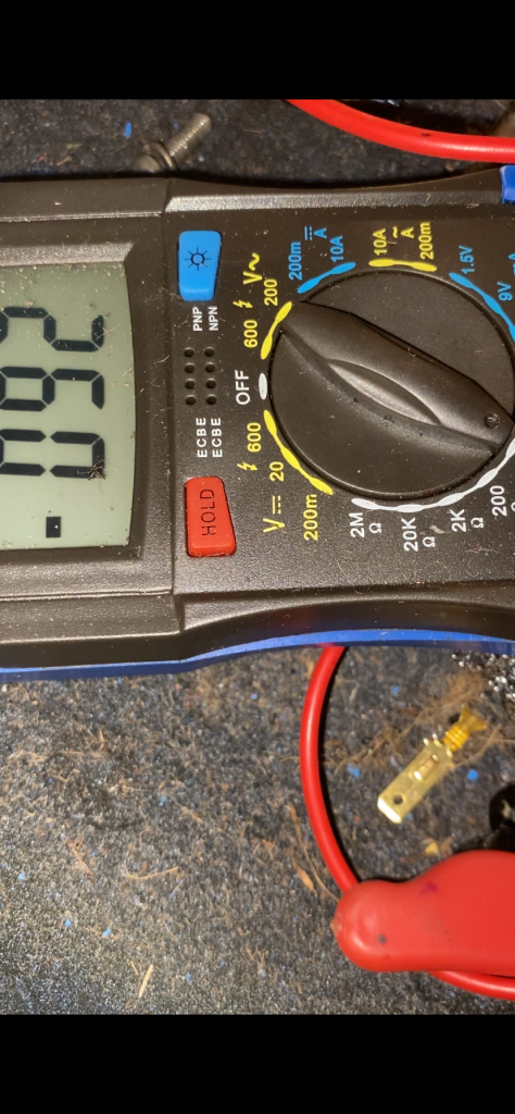

Mike323 Posted November 12 Author Share Posted November 12 So I just tried the screw driver on the side of bulb to earth didn’t do much I then put my multimeter on oms and the earth was getting this reading on the metal strip in the light cluster it was jumping between 2 different readings?? I then noticed the wiring was shot and hanging by a couple threads to the alternator so I chopped and re clipped that went to try start the car and try it but battery was to flat so it’s on charge but should my earth have readings like this?? Quote Link to comment Share on other sites More sharing options...
