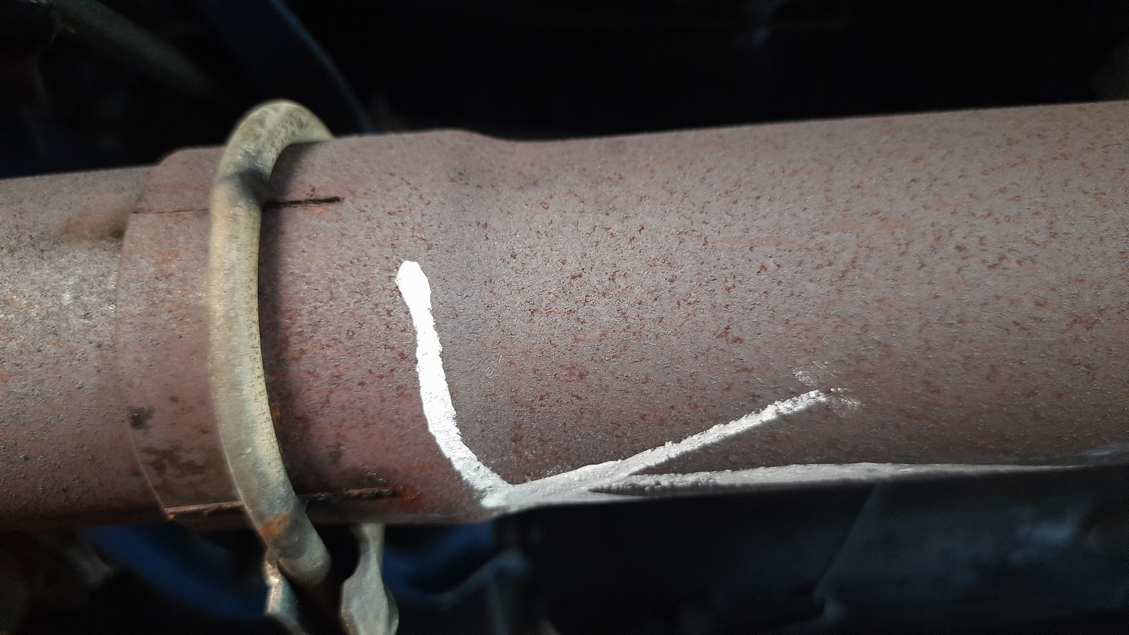

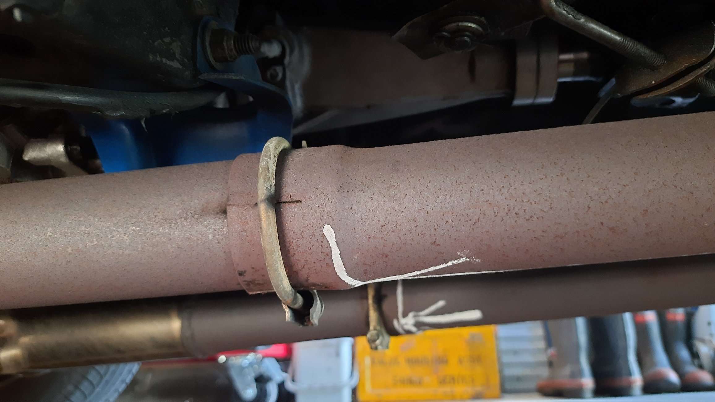

Gee Posted February 28, 2025 Author Posted February 28, 2025 Failed my warrant again. Hand brake balance (as usual) and also exhaust leaking from the slip joints. I can just get these replaced but what to replace them with? There is no flex in the system which won't help and slip joints leak sometimes anyway so I need a better way to join the pipes. 4 Quote
