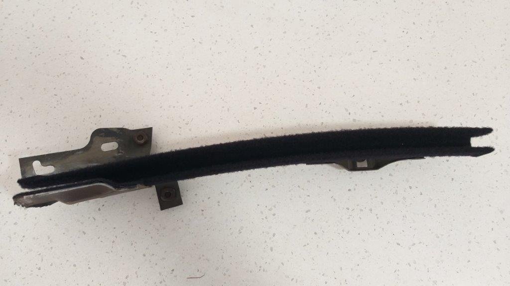

Flash Posted May 9, 2022 Author Posted May 9, 2022 So I proceeded to scrape out the old felt and adhesive using a few chisels. What a shitty job it is, but it needs to be spotless so the new stuff will stick properly. Ended up with this : 3 Quote
Popular Post Flash Posted May 9, 2022 Author Popular Post Posted May 9, 2022 The next step is also a bit tricky as you need to peel the back off the adhesive and at the same time get the new felt perfectly stuck to all three sides inside the channel. Any lumps will be fatal as they will prevent the channel from sliding smoothly. I started by peeling one end, but it soon became apparent that this was going to end in tears so I ended up asking Uncle Google how best to do this and he suggested cutting the adhesive backing into three strips and then pulling the backing off the centre strip first. Used a carpet knife to carefully cut through the backing without injuring the felt. Got Mrs Flash to give me a hand and between the two of us we got it spot on. One down and one to go. 14 Quote
Flash Posted May 10, 2022 Author Posted May 10, 2022 This morning I repeated the same exercise on the vertical window guide for the opposite side. Being the passenger one the felt was less stuffed but still looked well past it. Not that easy to photograph with my shitty phone, but you get the idea. I'm looking forward to tackling something different tomorrow. Ta for looking. 8 Quote

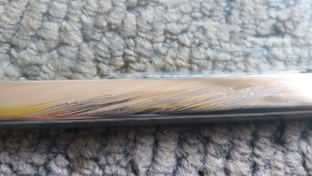

Flash Posted May 11, 2022 Author Posted May 11, 2022 Thought I'd see what I could do about the nasty scratches in the stainless steel window surround so gave it a tickle with some 240 grit and then moved through with some 600 and 800 grit before a final go with some 1200 grit. Slapped a bit of Autosol about the place and it looks heaps better. There are still signs of the two deepest scratches, but I didn't want to push my luck any further, so I'll live with those. Luckily they are on the inside of the frame so wont be that noticeable. Luckily the passenger surround is undamaged. 7 Quote

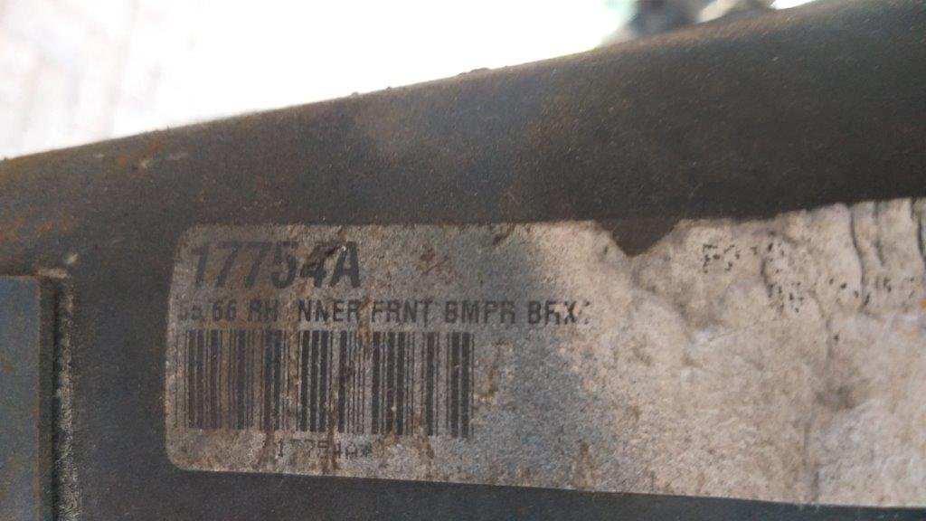

Flash Posted May 12, 2022 Author Posted May 12, 2022 In between working on the floors I've started to clean up the front bumper inner. The bumper and brackets have been replaced with Taiwanese repro parts. From the over spray on the brackets I can tell that the bumper was test fitted before the colour change back in 2010 and the lazy bastards then left the brackets in place. The outer chrome has held up really well, but the inner surface is looking a bit sad. Got rid of the loose stuff with some 80 grit then chucked some rust converter on the rest and followed that with a coat of epoxy primer this morning. Before pics: 4 Quote

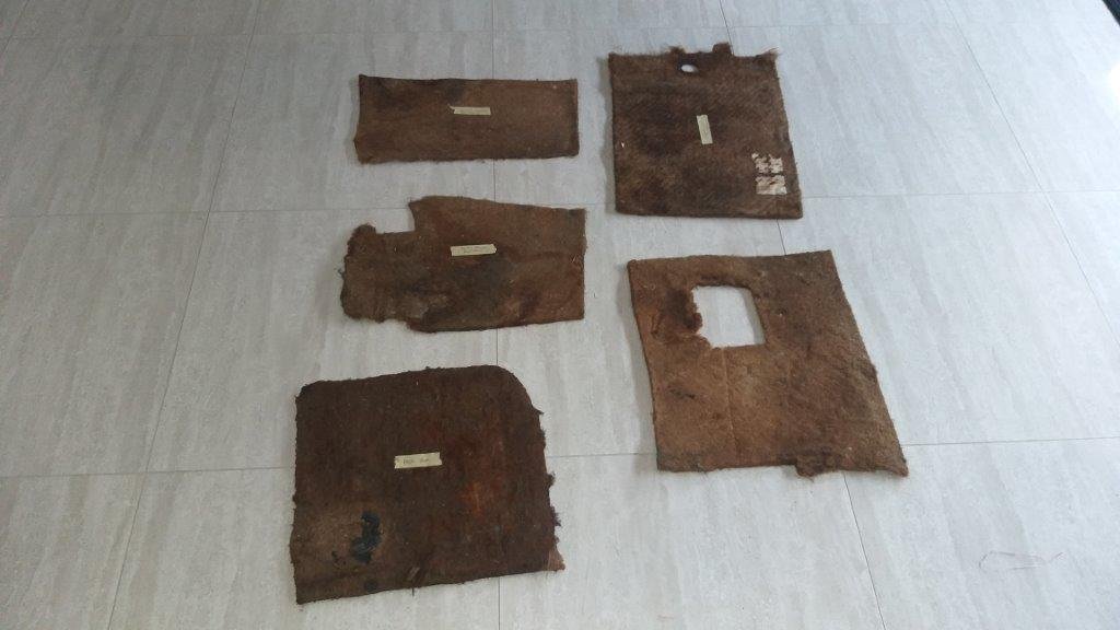

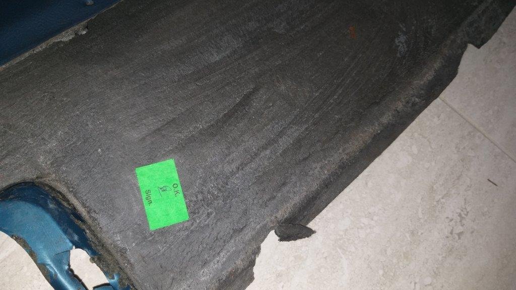

Flash Posted May 21, 2022 Author Posted May 21, 2022 The couriers somehow managed to separate the two boxes of sound deadening with the result that one is still sitting in the Brisbane depot, so my installation has stalled half way. No matter I've still got heaps to keep me occupied. Woke up to another wet and cloudy day so figured I'd crack into something that I could do inside the house. So figured I'd give the carpet underlay some loving Now when I lifted the Mustang carpet a few weeks back the original factory underlay was looking sad and grubby with lots of pieces falling apart and some sections completely missing. The only piece really worth saving was the rearmost portion that covers the driveshaft tunnel as that one has a rubber backing that has kept it pretty mint. Yesterday we did a supply trip through to town and I was able to source a new piece of automotive underlay. It's pretty lush stuff but was a bit spendy for what it is, so I figured I'd take a punt at getting away with a linear meter. So this morning I started off by making some paper templates, then played a bit of Tetris to get everything to fit....... and .... whew, I just made it. Then some chalky, chalky, cutty, cutty, testy, testy, trimmy, trimmy and it's not looking bad at all. The weight of the carpet together with the bolting down of the centre console should help it to settle nicely. Thanks for reading. 9 Quote
