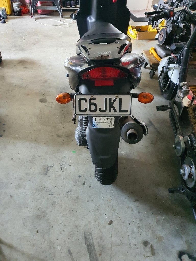

Cost more than I was expecting and got pinged for an entry certificate so left to think if I could be bothered, they called later in afternoon to say they had found the chassis number in system so just had to pay up and collect plate. $128 bucks later...

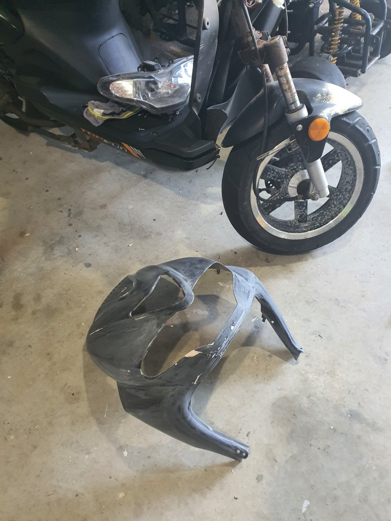

Better find the voltage regulator, found the white crusty piece of shit under fairing.

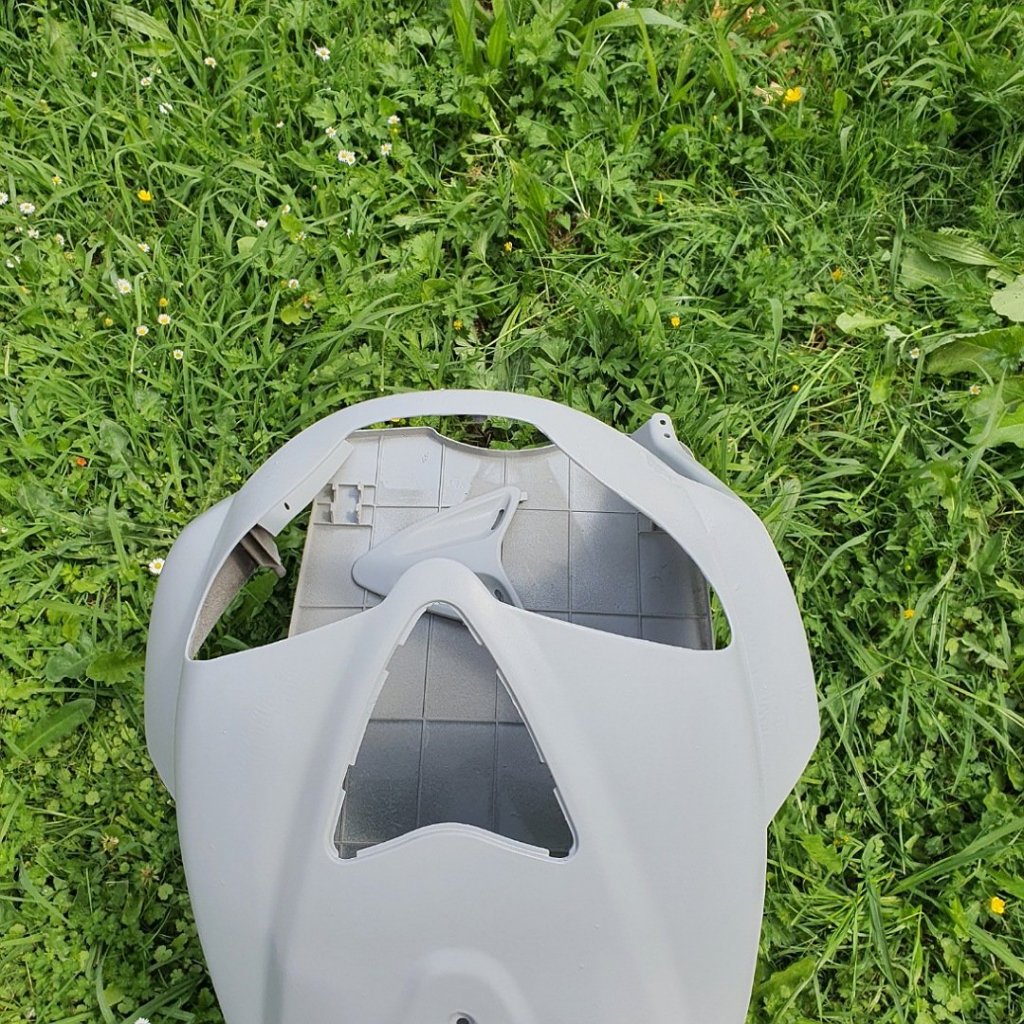

Thats on way now so thought I might try turn the 3 piece front fairing back in to one piece while I wait.
Glued all broken bits back together and reinforced them then smooged bog all over back of it in an effort to bulk the thickness up a bit so it doesn't break again.
Will throw paint at it once I sand all the other bits back.
Let's polish this turd! All cracks fixed and bogged time for some hi build primer to fill in the 240 grit sand job. Seems to have stuck well gun hasn't seen much use for ages was a bit splattery to start.

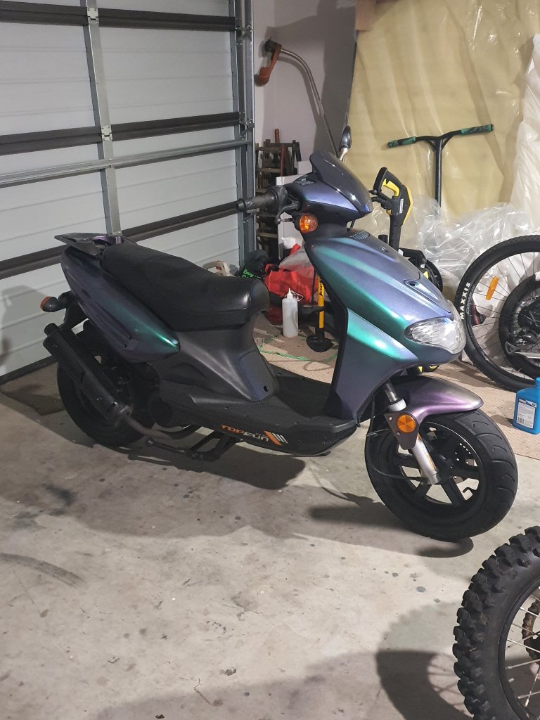

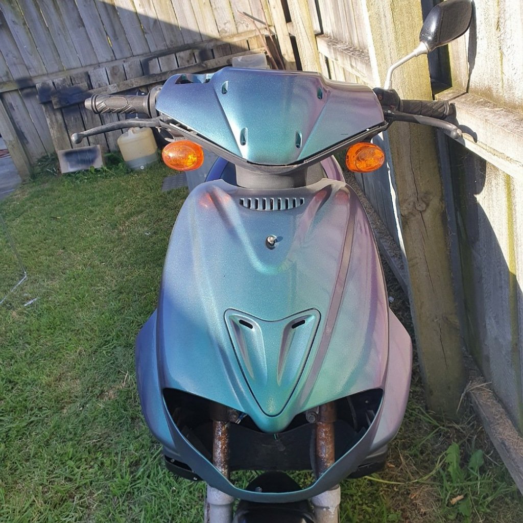

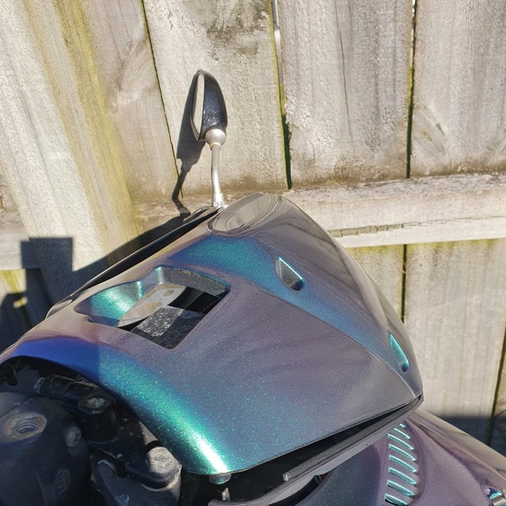

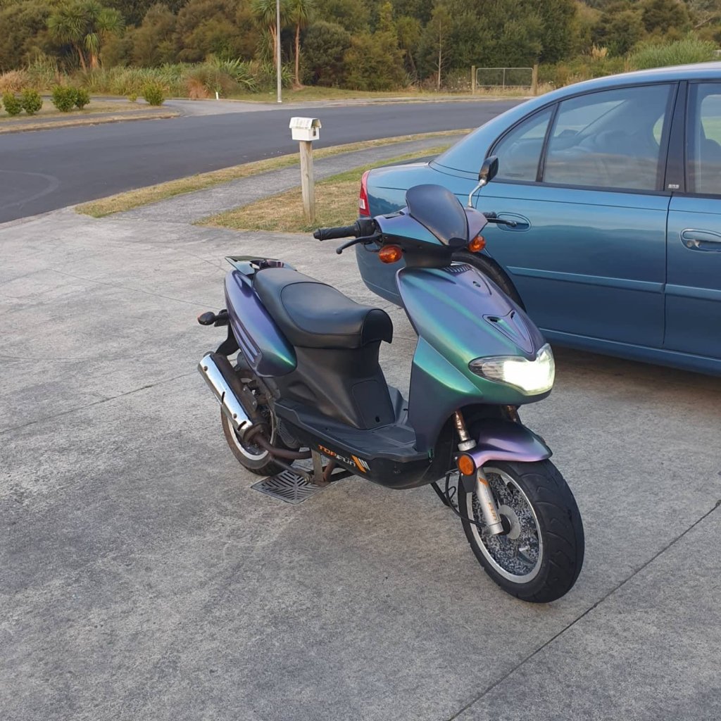

Got a spurt of enthusiasm today so painted this nugget, paint is 7/10 but looks pretty damn good considering I only primed some of the plastics.
Meh. Looks zillion times better.
I did go chameleon paint as well glad I did looks awesome and isn't too flamboyant.

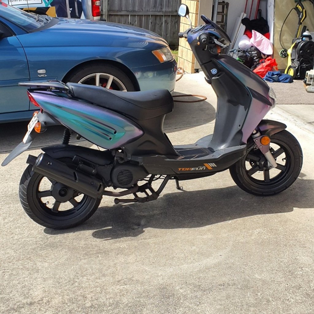

All done frame will get a tidy up at a later date, few scabby areas to touch up but it looks pretty good at a glance,

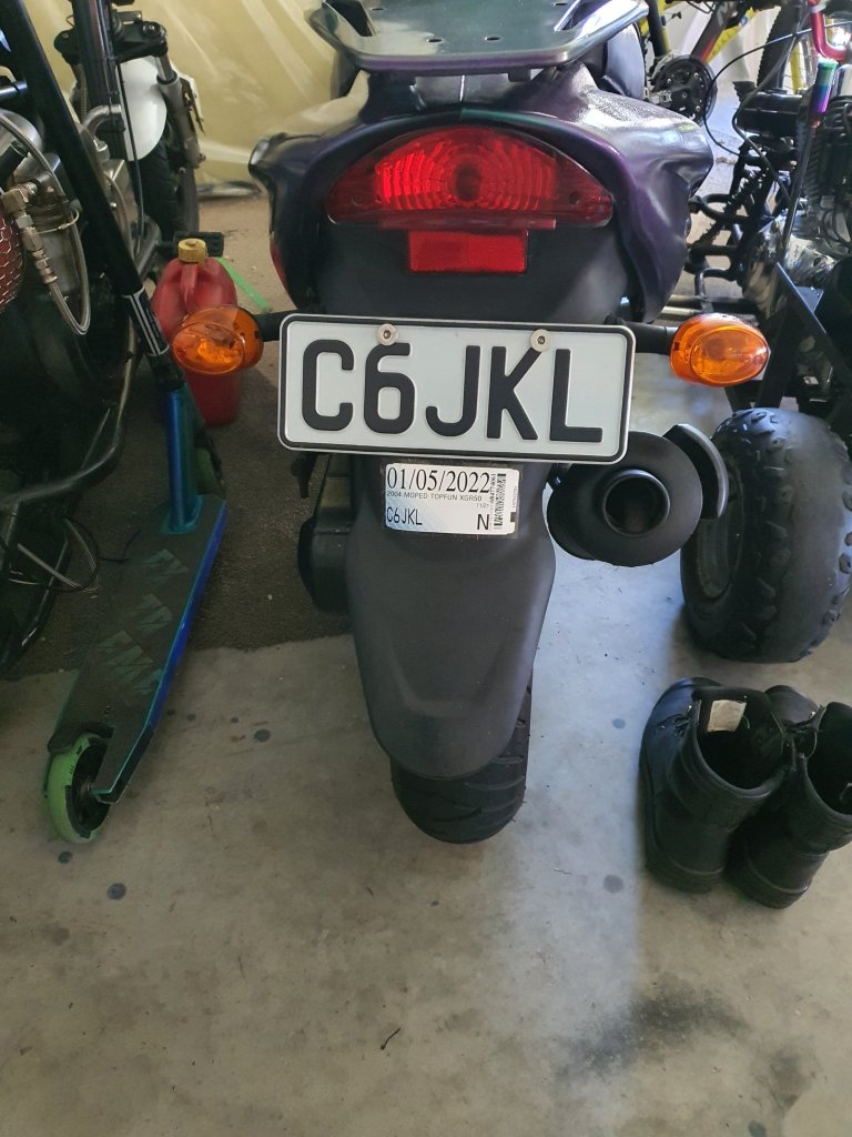

Did a h4 led headlight upgrade on it too no chance of this thing been missed now!

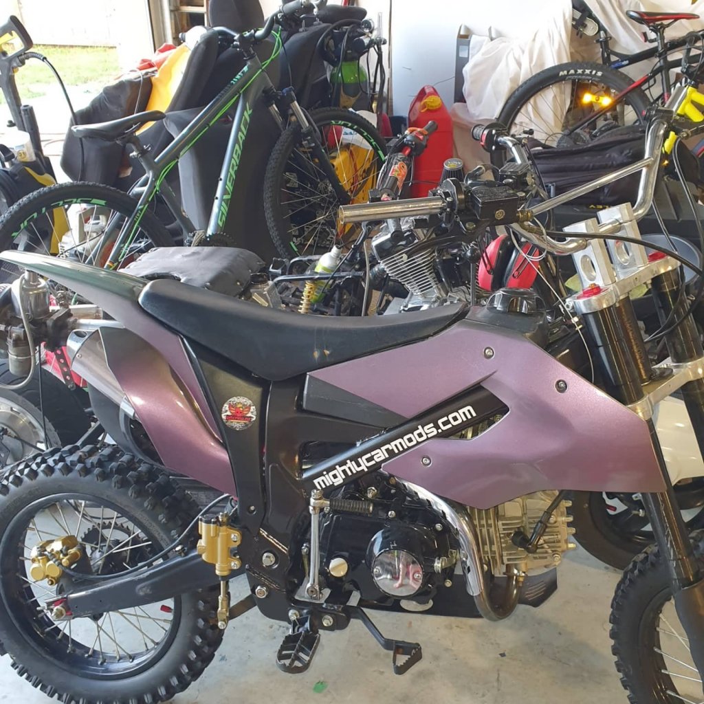

Also mixed another batch and resprayed the plastics on my sons dirtbike too I really like it light purple to a titanium looks sick!

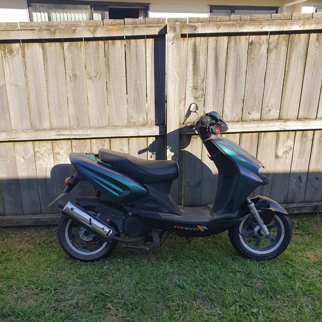

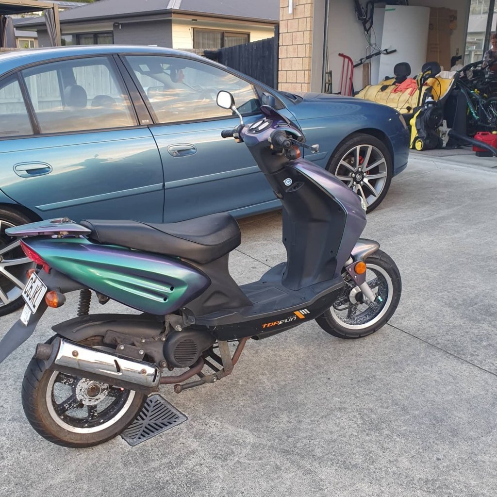

With the price of gas lately this has been doing all the usual running around.
Did some service things to it, the air filter elbow never stayed on properly so was constantly popping off the carb which made it use heaps of gas and stink of petrol. It had shrunk so I carved it back to the right size with a Stanley knife then dremmeled the lip back in to it.
There's a small fuel leak somewhere so I'll replace all the fuel lines and chuck a new filter in soon.
I also wire wheeled all the scabby stuff you could see including the wheels and hit the lot with CRC black zinc. Its looking presentable now.
Paint looks cool from afar but isn't fantastic due to it been the first thing I've sprayed in years. Maybe over winter I'll throw a better coat of colour over it. It's a bit orange peely.
Anyway rode for an hour today can jump in 70k zones without pissing people off now with air filter fixed it holds top end way better.

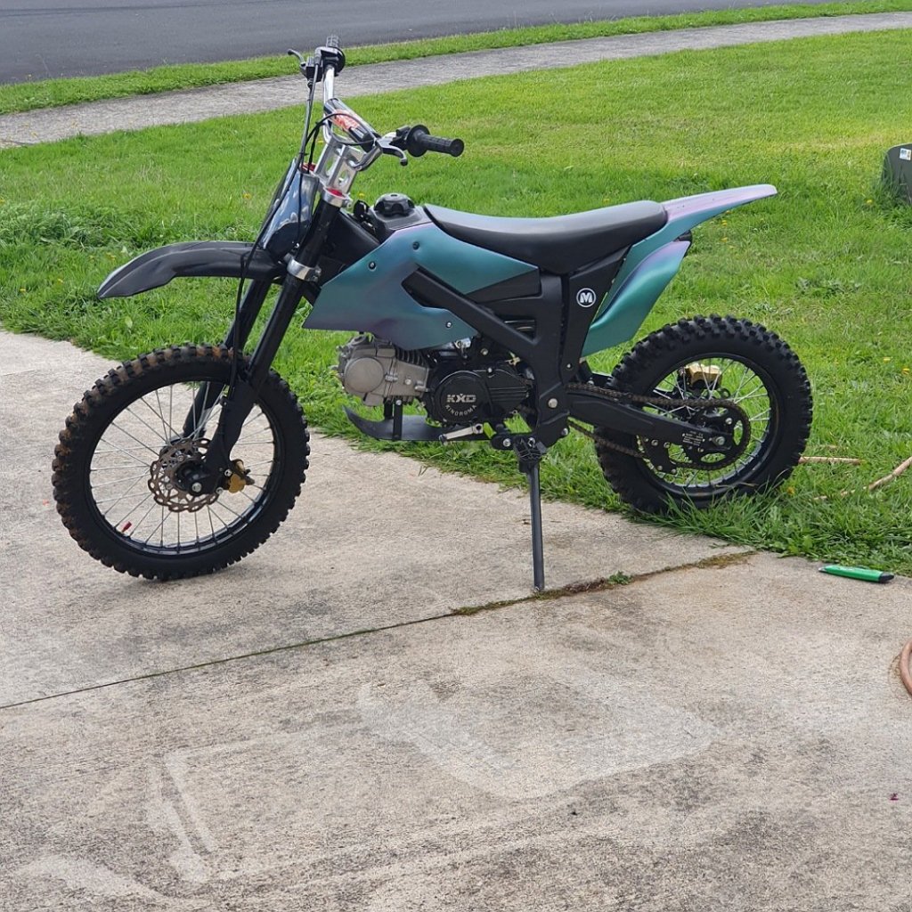

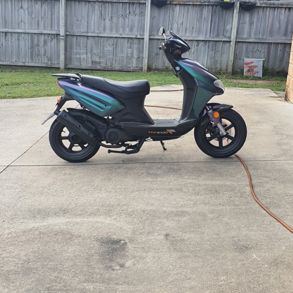

I found I struggle to touch the ground and the seat slopes forward which makes it uncomfortable to ride, without sliding forward on the seat im on my tip toes...... this won't do.
So this is a before picture I guess.
100mm drop in rear with good suspension travel. I think this thing has had the wrong shock from factory as it feels perfect now seat is level and comfortable.
Test ride needed before I commit to new shock mount and chop up stands to regain ground clearance. Will drop front 20mm too.

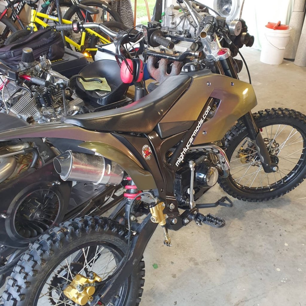

Ripped into it this morning job done before 10am

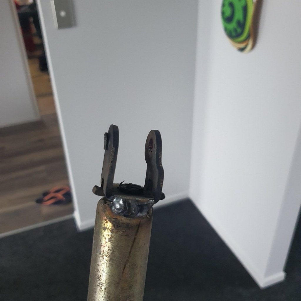

Selected shock from my small hoard of Chinese manufactured motor parts chopped the fork off old shock and welded to base of a quad shock.
Fitted test rode as expected is mint no longer wobbly when pushing through corners.

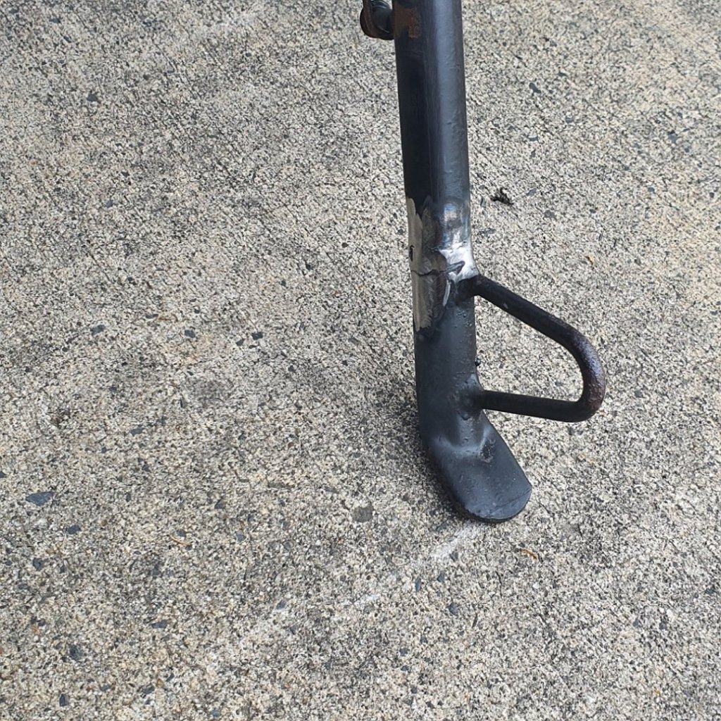

Got home and shortened 20mm out of side stand so I dont have worry about it falling over.
Tried lowering front.... to much work at this stage still happy though.

Suspension has settled, for reference look where the muffler used to sit compared to now. It's so much nicer to ride and get on and off.
