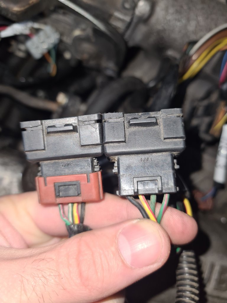

Plugged my speedunio (Teensy version) in and had to re calibrate the TPS in Tunerstudio as it was reading backwards seems the RVR TPS is reverse and the lower reading is full open, checked a few things but didn't try start it as I haven't wired in a map sensor or done some other ground work for it to just plugin and go
Worked out part of my idle issue may be that the Evo 1-3 loom has the wiring opposite on the TPS to the RVR TPS so the fact its reading backwards is giving my ecu the wrong signal. RVR tps are on the opposite side of the throttle body by the firewall and read in reverse
Right now with the engine off the TPS signal is 5v with the throttle closed and 0V at WOT, also means the idle switch isn't being read until WOT by the ecu which explains my fuel cut as when I'm at wot the ecu sees the throttle being closed and it going into idle
Confirmed wiring is backward as per pic
Plug and wiring on left is from an RVR the right is the evo
So TPS is now wired the correct way and the boost issue is gone, need to hook the factory boost control back up so its doing more then wastegate pressure
